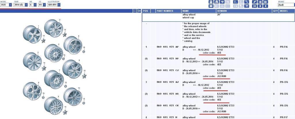

Are your wheels here ?

Well persistence paid off ….image enclosed
If anyone is interested this is the code The paint code for the wheels is 1H7/ High gloss paint (ready-mixed LWG 056 1H7 A1 SILVER).
