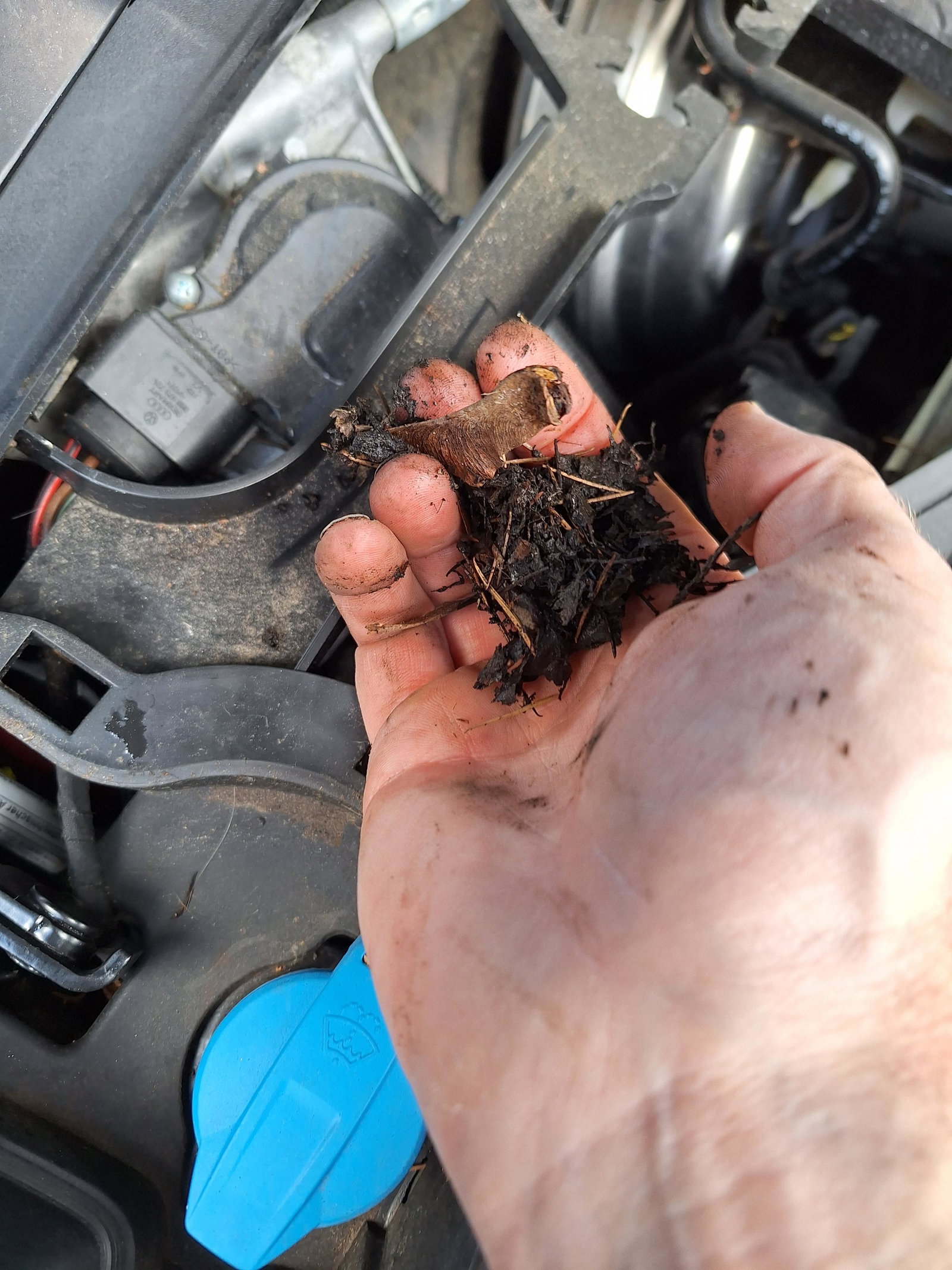

Just wondering, was this the problem? I have a 2019 A6 with a wer floor. Only just bought it. It's going back to the dealer to get fixed, but I found a lot of leaves and crud under the windscreen. Looks like the previous owner parked it under a tree.
Edited by NelsonP
Have a look in the bottom of the plenum chamber and clean all the crud from the drain holes.
There are a few posts on this.
