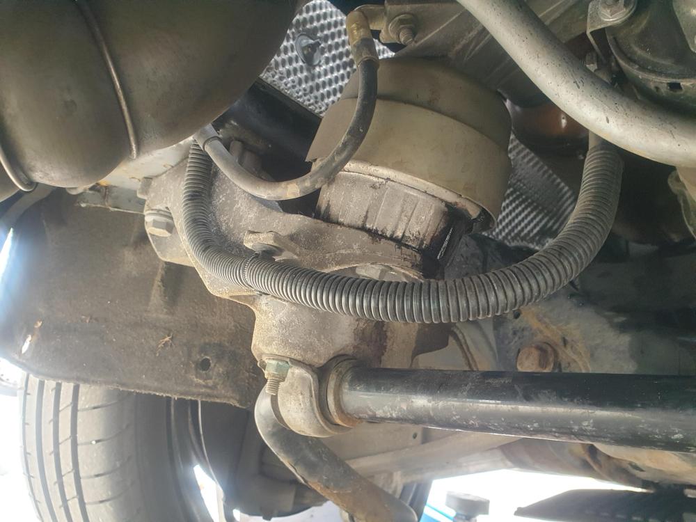

Sam27 Posted September 25, 2022 Share Posted September 25, 2022 Hello All Did my engine oil chnage today and noticed .....another oil leak, any advise on what this is please? Manyt Thanks Sam Quote Link to comment Share on other sites More sharing options...

Sam27 Posted September 25, 2022 Author Share Posted September 25, 2022 Please see arrow Quote Link to comment Share on other sites More sharing options...
Stevey Y Posted September 25, 2022 Share Posted September 25, 2022 4 hours ago, Sam27 said: Hello All Did my engine oil chnage today and noticed .....another oil leak, any advise on what this is please? Manyt Thanks Sam Hi its a Hydro mount for the engine, these are oil filled and when the rubber reservoir deteriorates they start to loose oil, yours does not look terminal yet but it will need changing as they only get worse and you will experience a lot of engine vibration. Steve. 2 Quote Link to comment Share on other sites More sharing options...
Sam27 Posted September 25, 2022 Author Share Posted September 25, 2022 Many thanks stevey, hope it will not cost an arm and leg. Do you think DIY is possible? Quote Link to comment Share on other sites More sharing options...
Stevey Y Posted September 25, 2022 Share Posted September 25, 2022 15 minutes ago, Sam27 said: Many thanks stevey, hope it will not cost an arm and leg. Do you think DIY is possible? Hi the units are not that expensive, DIY is possible but you will need two robust trolley jacks and a nice wide piece of wood to support the engine on one of the jacks, to my mind a garage with a four post ramp is a better proposition as it looks as though its very accessible from the picture and they will have a hydraulic cradle to support the engine whilst standing upright to do the job. Steve. 1 Quote Link to comment Share on other sites More sharing options...
