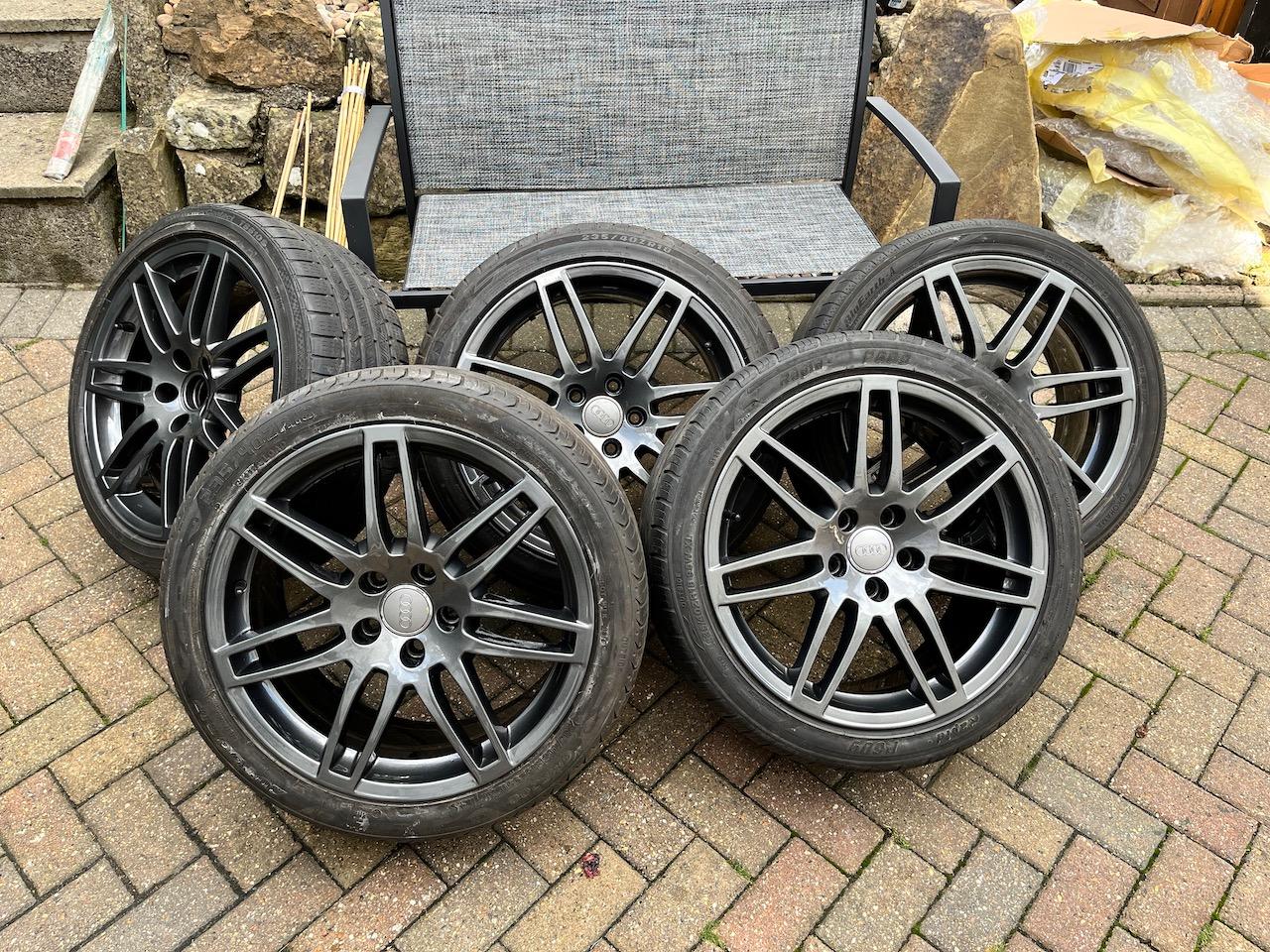

Mario T Posted September 25, 2022 Posted September 25, 2022 Hi There, I wondered if anybody could help confirm the et of the last edition lemanns wheels please. I have standard s line alloys which are et 43. I was wondering if the lemanns A4 wheels are et 34.? Many thanks Maz
Swisstony Posted September 26, 2022 Posted September 26, 2022 Hi Maz They are 43 as well , see below 8J X 18 ET 43 I have an S Line edition and was very lucky to pick up an immaculate set a week or so ago
Just Rob Posted October 3, 2022 Posted October 3, 2022 Factory fitment will be ET43 8J whether it's lemans or ronals.
Mario T Posted October 3, 2022 Author Posted October 3, 2022 Do you think it get away with an et of 39.?
Just Rob Posted October 3, 2022 Posted October 3, 2022 Yes , no probs as you moving the offset out board , the lower the number the further out the rim moves.

Mario T Posted November 30, 2022 Author Posted November 30, 2022 Hi There, A set of wheels has come up but they may be ET36 - Is this getting toward the limit on rubbing? The Cab does seem quite low not lowered. I do seem to recall that S lines have always 'wrapped' around the wheel's arches which has always looked good IMO. Thankyou
