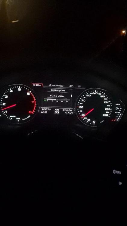

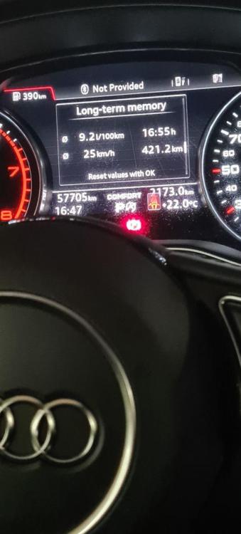

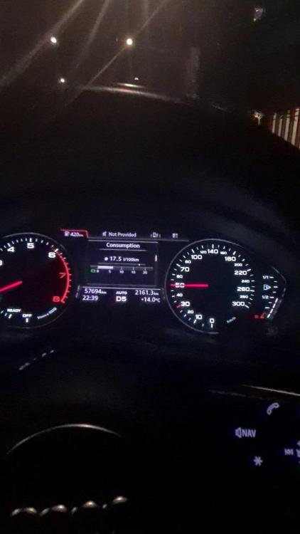

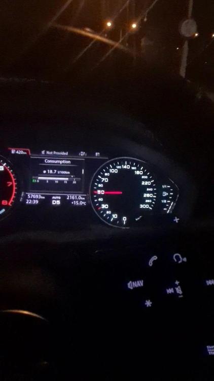

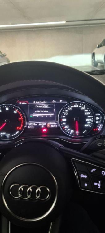

I just bought an Audi A4 1.4 TFSI 2017 (Automatic) few months ago. I noticed that the car is consuming and eating too much gas. I commuted so far 2160 KM and I had to fill-up the tank 4 times so far.  I decided to watch the consumption while driving and see what consumption is and I was shocked when I looked at the numbers.
  • On residential areas (low speed - city), the consumption is 20 L / 100 KM (14.12MPG)!
  • On highway driving on avg of 100 KM / h, the consumption can be the least 8.9 L / 100 KM (32 MPG)
I went to different mechanics and most of them are saying thats pretty normal but I don't believe them. so I decided to drive my friend's car which is completely the same, I noticed that his car is making maximum of 6.8 L / 100 KM  on low speeds.
Any ideas what could be the root causes of this issue?
I checked already the tyre pressure, the fuel is EUR 95 and both cars are filling-up from the same station.
