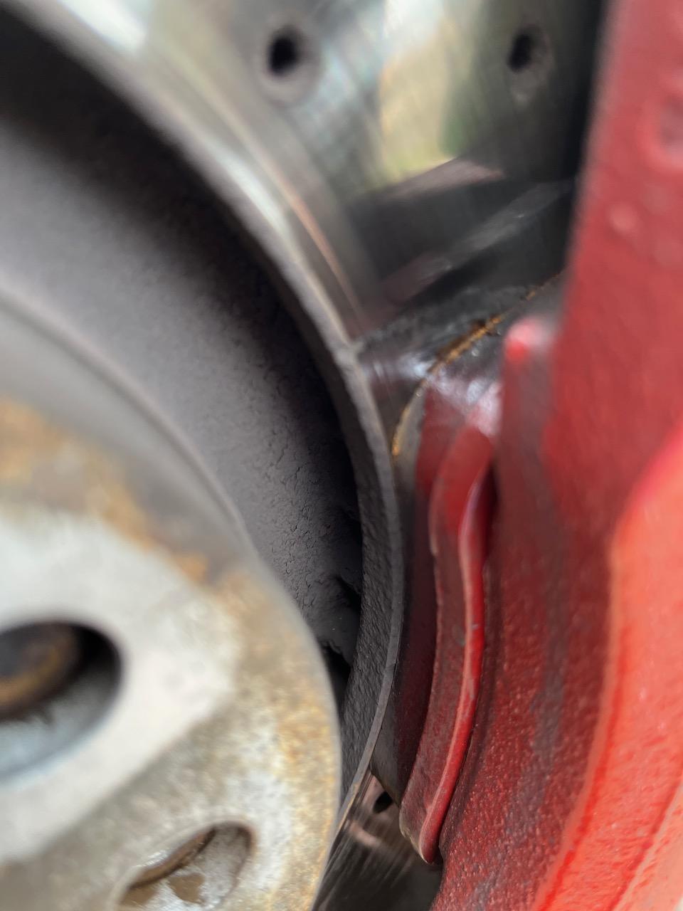

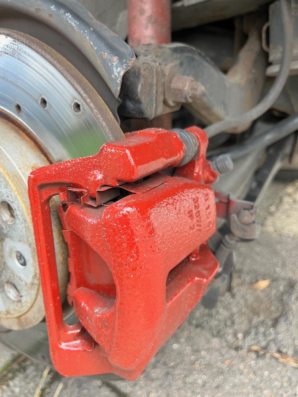

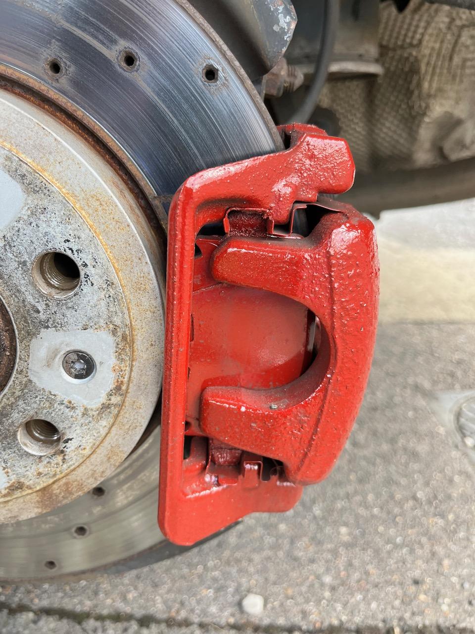

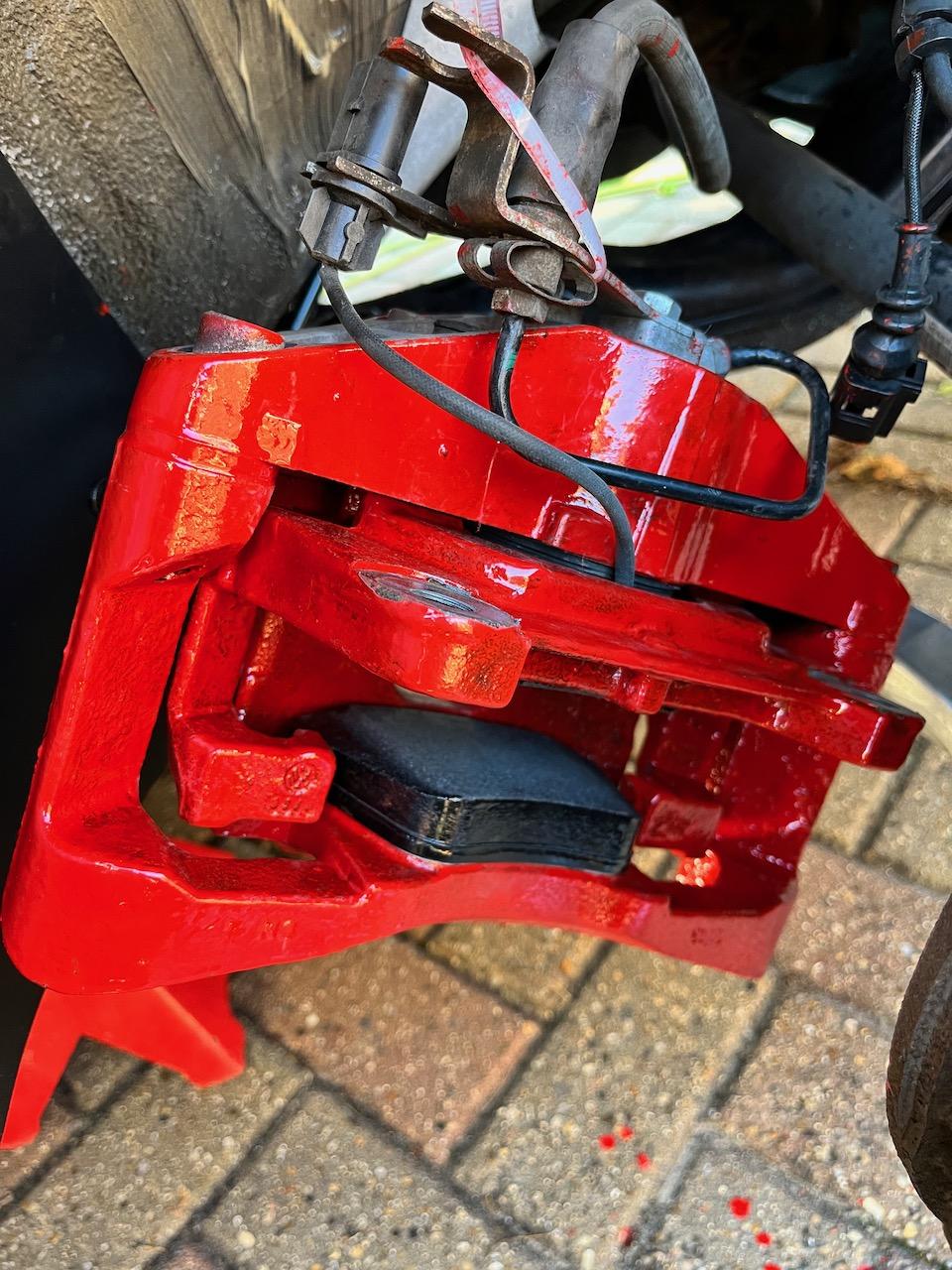

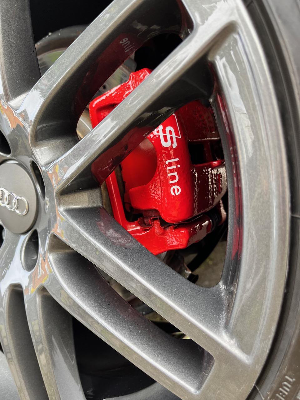

We all get this , buy a car and start making it like you would like it, putting your own mark on the car etc. However every now and then you have to fix stuff that the previous owner did. Some is because its not to your liking , some of it is just plain crap and this is a perfect example. I remember the guy saying he had spent a lot of money getting the calipers refurbished and I even have a receipt from the garage. Well they have fleeced him something rotten as it was such a bad job. Spray painted whilst on the car and their masking was poor. And the cherry on the top ? They even painted the !Removed! brake pads !!!

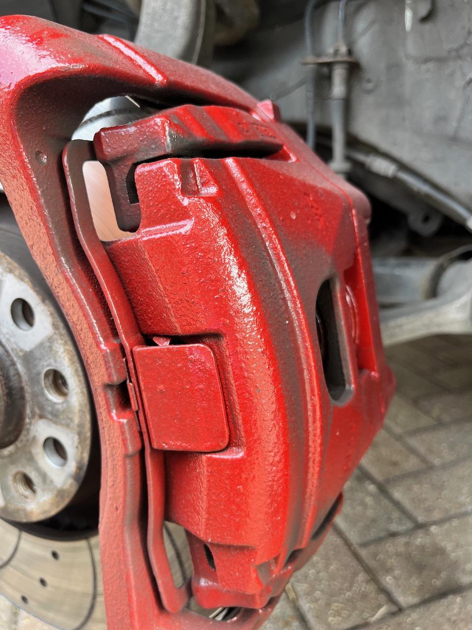

Anyway decided the only way to fix this was to remove the front calipers ( only hanging as I didnt want to bleed the brake lines) and clean and repaint but by hand with a brush. I have done this on my wife's Porsche cayenne so it wasnt new to me.
First up the before shots with overspray, bad masking etc
IMG_0731.thumb.jpeg.b2d697e658a01cbc2fbb694057e635ec.jpegIMG_0733.thumb.jpeg.b7b41cccf125663ce813b34ea0ce56d5.jpegIMG_0791.thumb.jpeg.843226f2f6b35997aaf64ab508f6f274.jpegIMG_0792.thumb.jpeg.15862952fc70c8b806507bea0667daeb.jpeg1466361d-c493-4321-9db7-06619d25bffb.thumb.jpeg.0df238e35f8086bba7ea008aff169a1b.jpeg

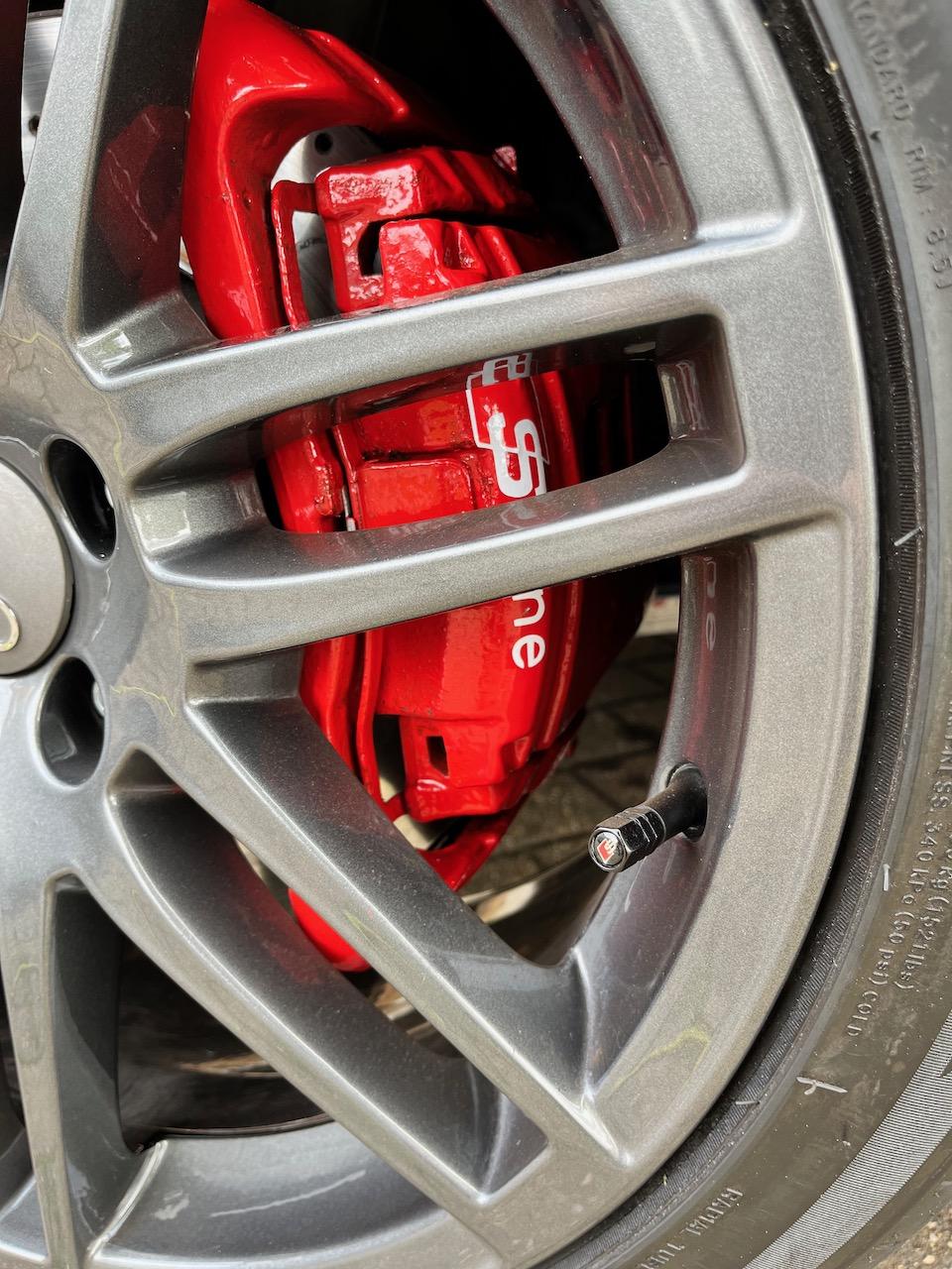

Fronts cleaned, degreased and hand painted, fresh pads.

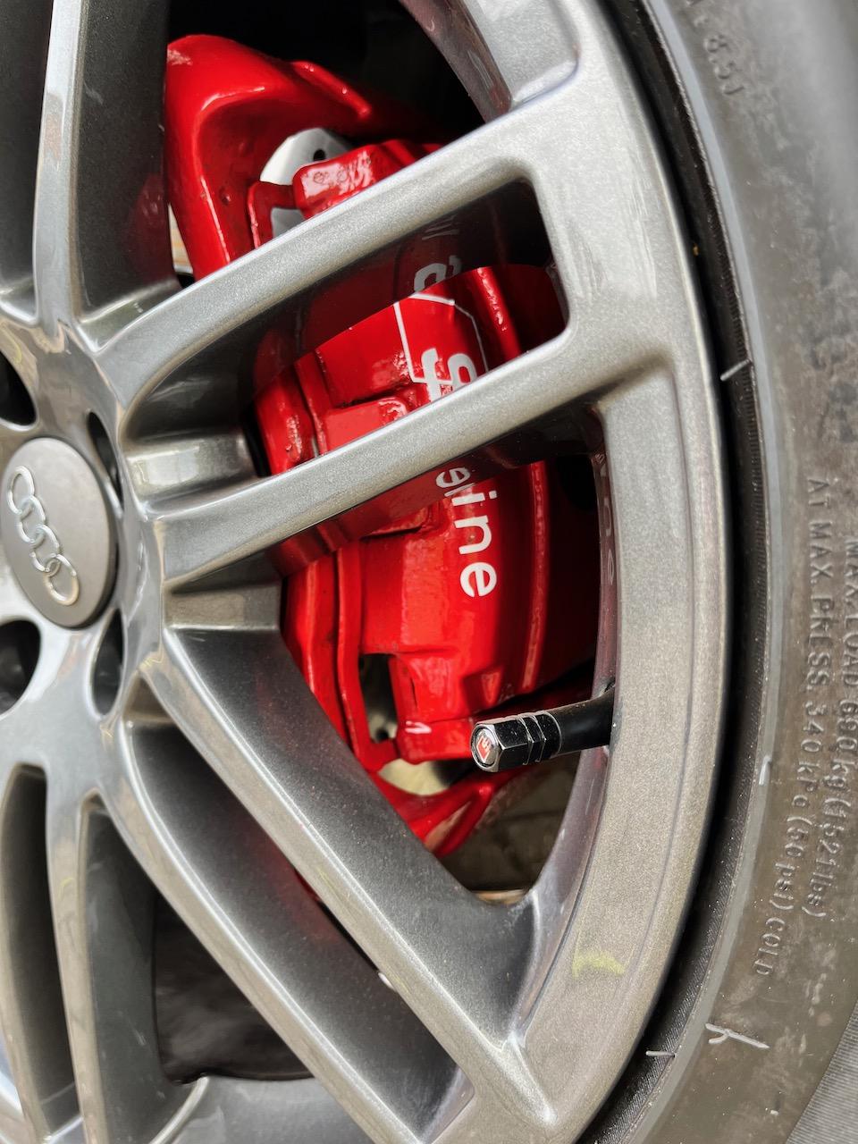

Then decals applied ( not so easy on these style calipers ) and back on
IMG_0943.thumb.jpeg.0f561cefe90f6a5ad3bbc002ac053e8e.jpegIMG_0944.thumb.jpeg.c0c3e9c1f2e02d4e2114b4cd48df174c.jpeg

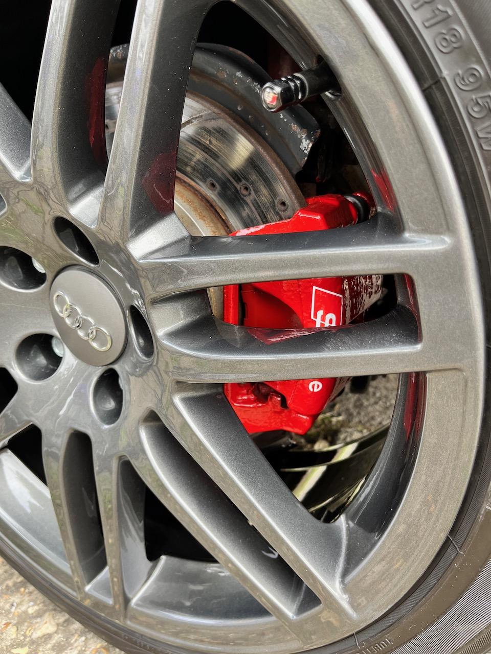

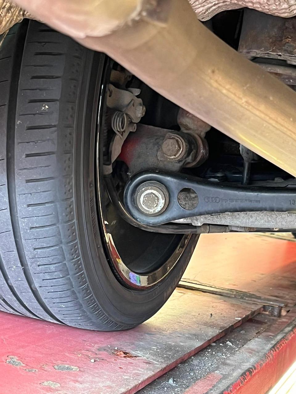

Backs were a bit harder as I didnt have the tools to remove the handbrake lines so they were painted on the car and later I will replace the pads when they are worn
All cleaned and painted and back on
IMG_0946.thumb.jpeg.3e92b458082be6515bd608485488441a.jpegIMG_0945.thumb.jpeg.e5c778eba805573b41c98bb73b24960d.jpeg
That is another job ticked off, onto the next which are the dodgy RS4 badges everywhere !!

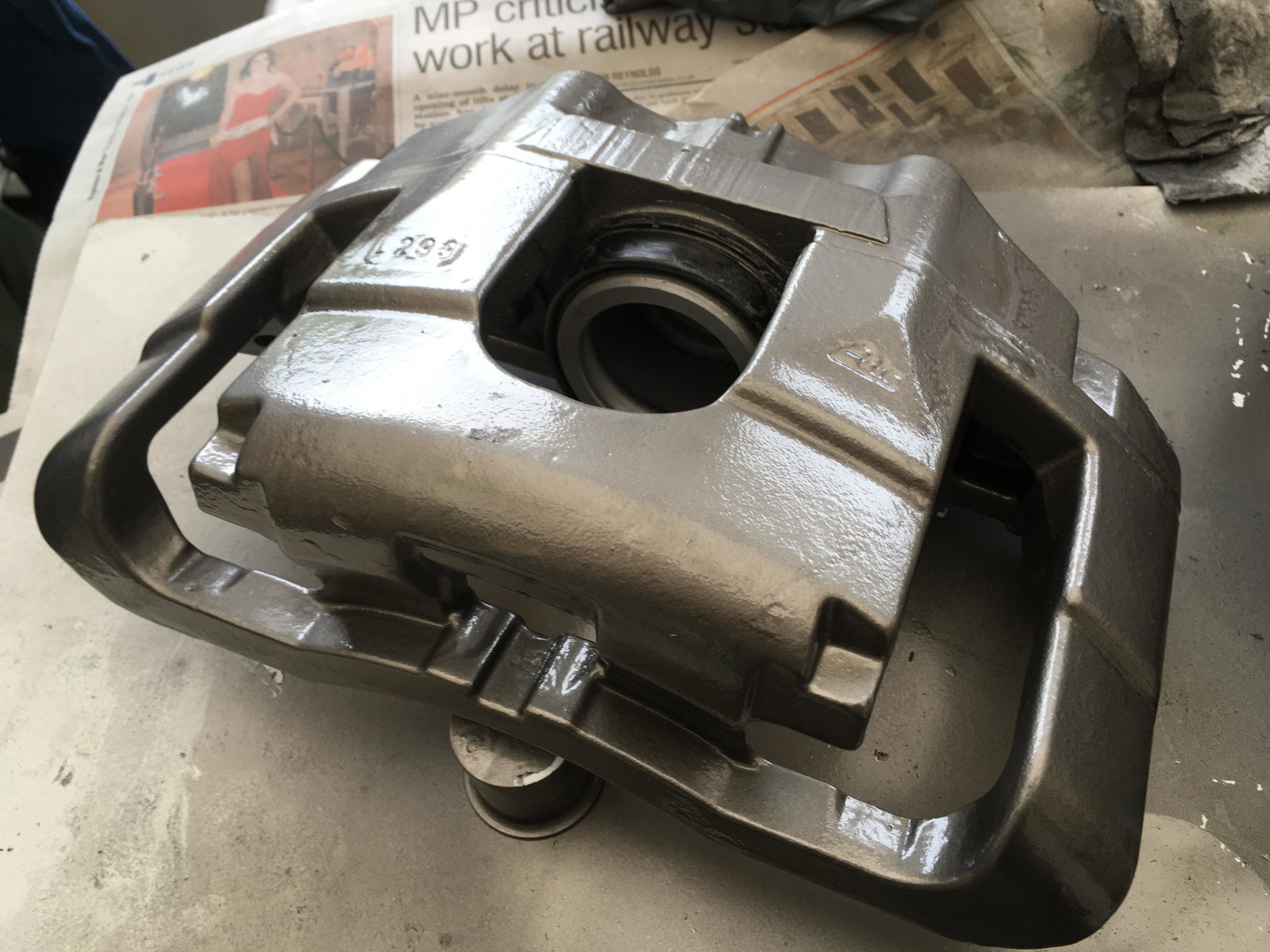

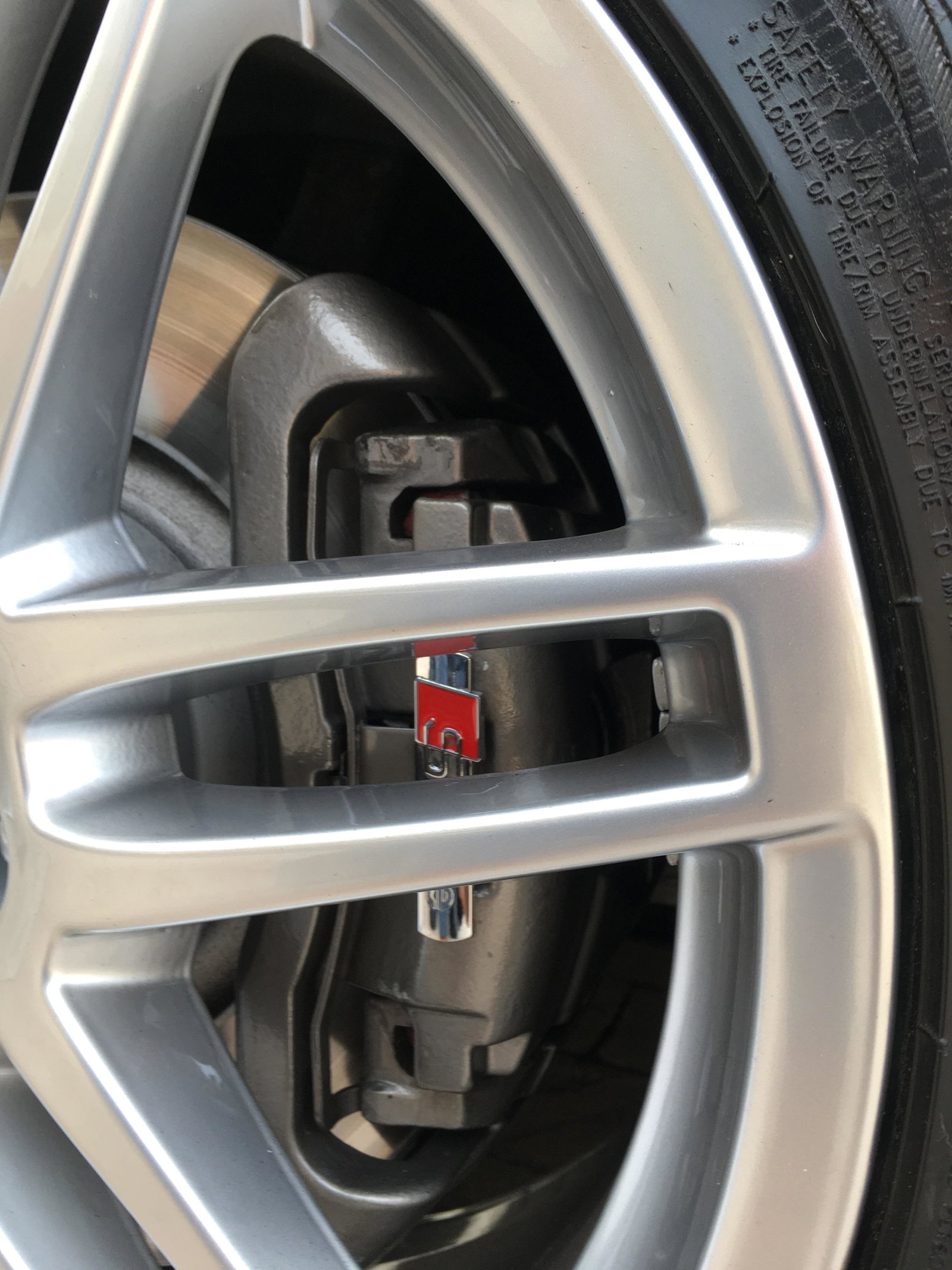

I purchased new callipers and sprayed them thunder grey.
Thunder grey is a fab colour, nice job there . I see you didnt go down the route of caliper decals but opted for a stuck on S-line bade ? How is the adhesive holding up on the heat ?
No problem at all.
It is actually stuck to the square on the spring so almost no heat at all.
I do like a nice painted caliper but I feel the colouring  suits the alloy calipers such as brembo etc .
The plain metal ones allways look hand painted for some reason even when done well, alloy ones being smoother and more integral just carry off colour coding so much better.
2 hours ago, RoyC said:
No problem at all.
clever idea. Talking about that spring, what an absolute barstweard that was to get back in !!! why oh why did audi decide to use that instead of normal spring like things .
I had no problem at all getting those on.
Just put the two ends under the calliper and lever the square tag into the brake pad, making sure not to scrape the paint in the groove in the carrier
Theres a knack to it, do it a few times and You'll wonder why it was so hard to start with👍

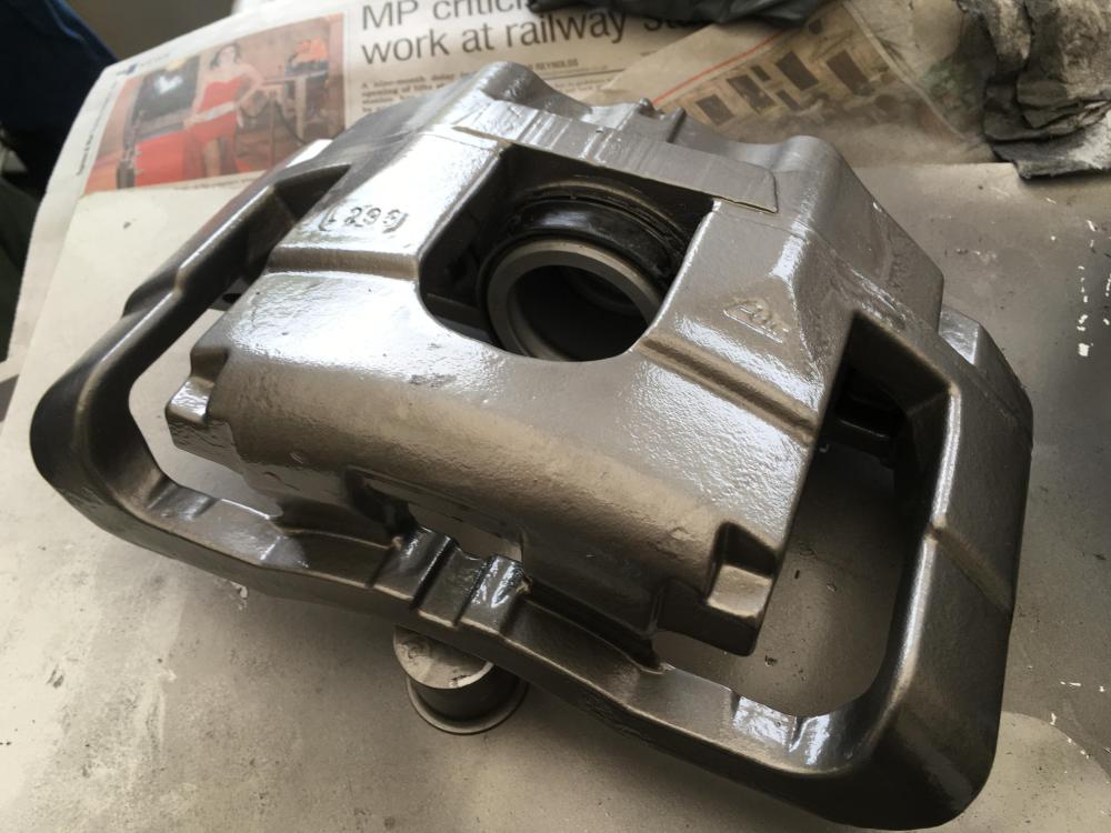

My first set of 18z's were from a lambo, gave them a full refurb and nice blob of corsa rosso red.
recently bought another set from FB market place , refurbed them fully and went from banana yellow to bronze.

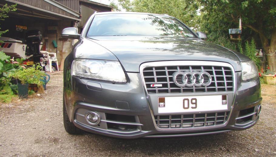

3 minutes ago, RoyC said:
Got a photo of your car ?
No problem. There is one  photo when I got the car. second one is the front a few weeks on but with the RS4 badge.IMG_0619.thumb.jpeg.4c8d4aae3a2d20c250ede7e464f3a72b.jpeg1278966480_IMG_0865(1).thumb.jpeg.3d60566c1ffafd729c8298a35da79097.jpegA LOT has been done
