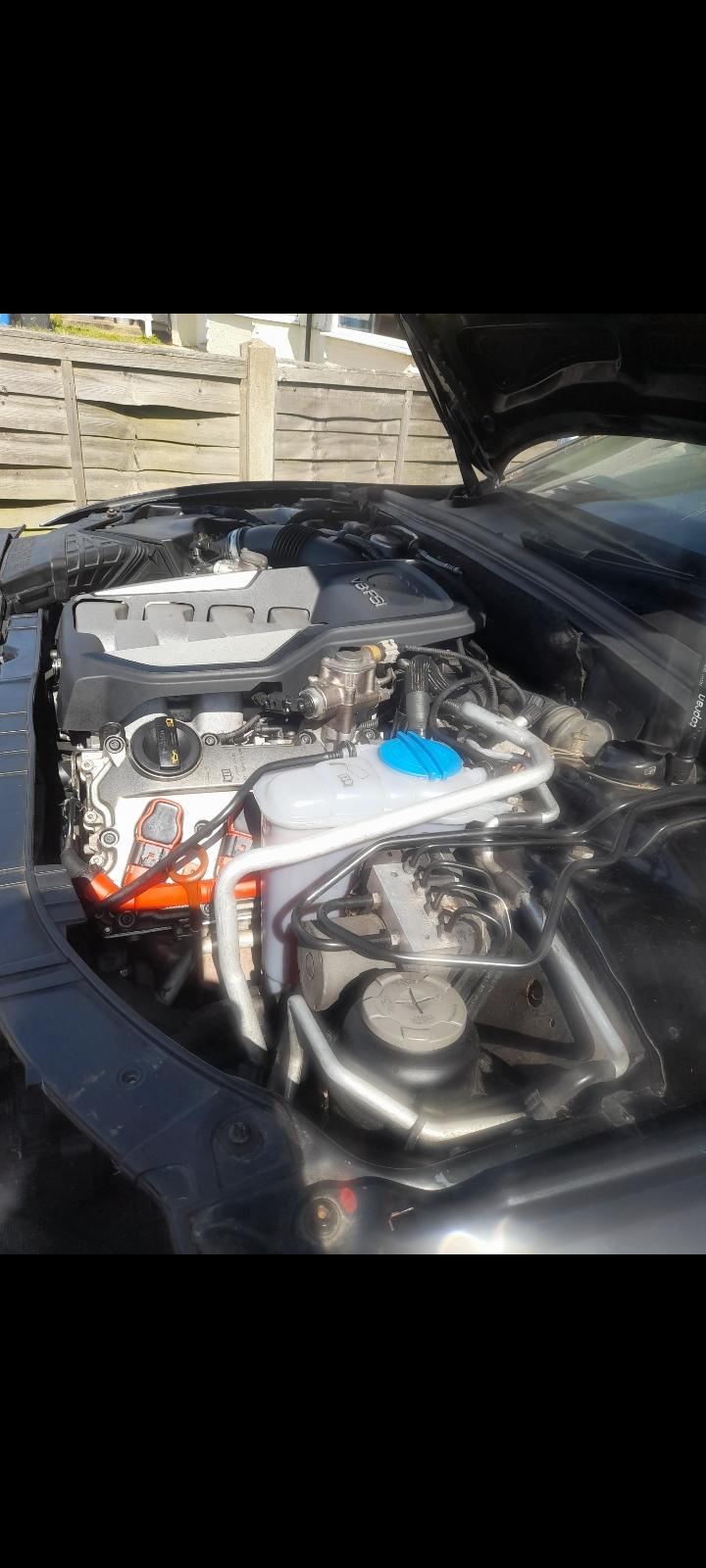

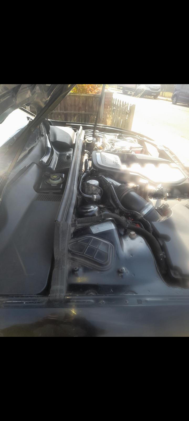

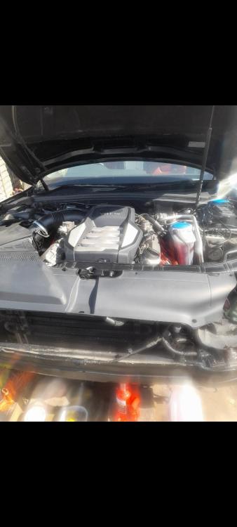

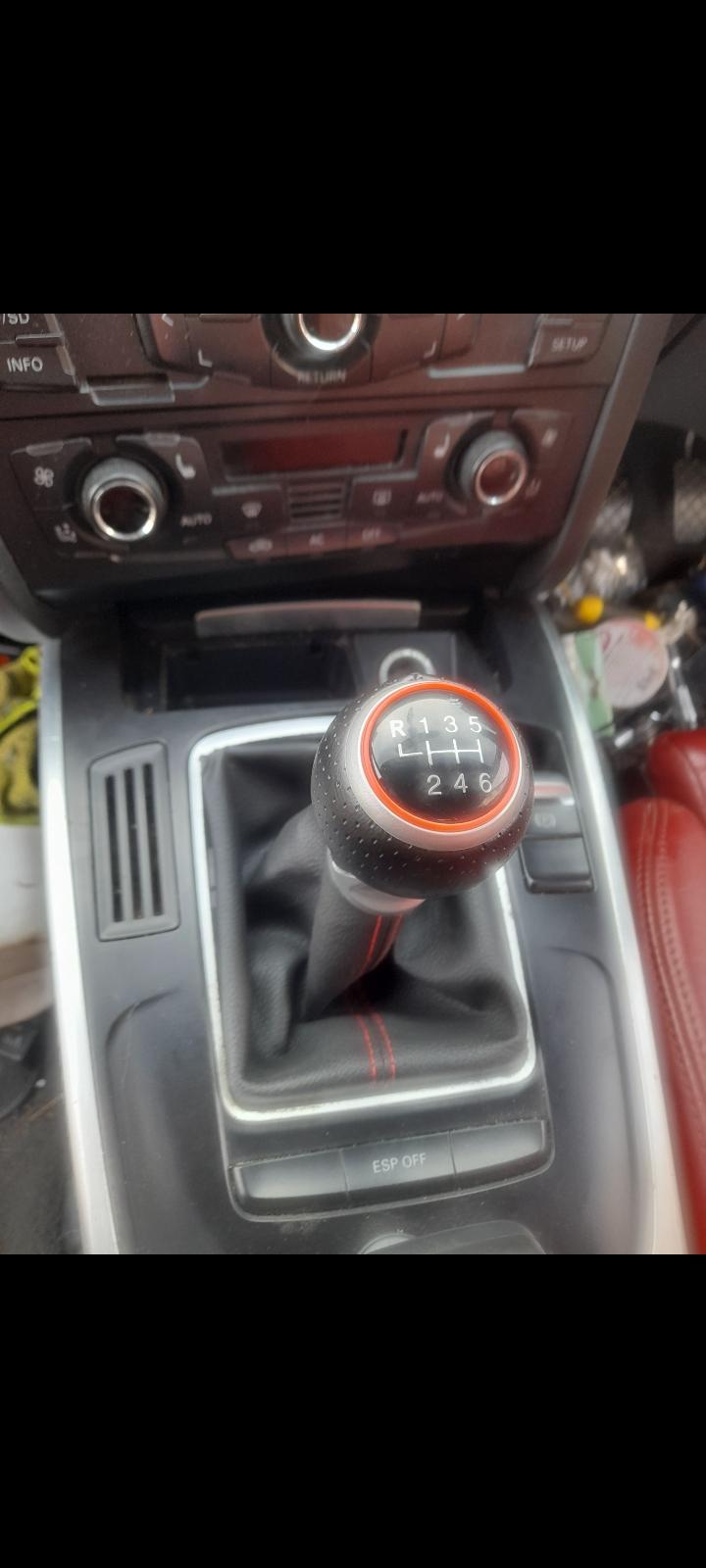

Not been on for a while, so engine now done sounds lovely just headlights to put on changed the interior and gearstick knob and gator, still got the rear lights and front and rear discs too do with front and rear dust shield

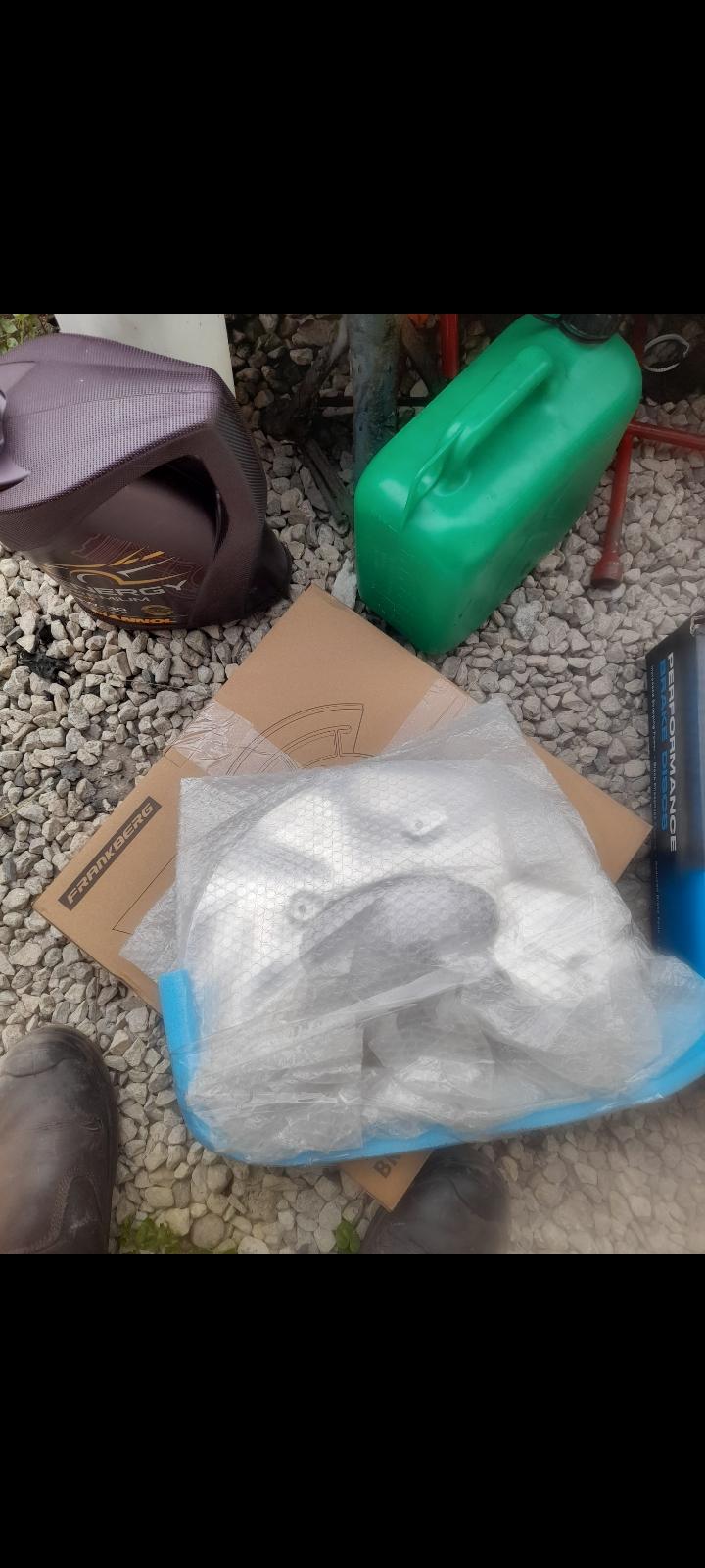

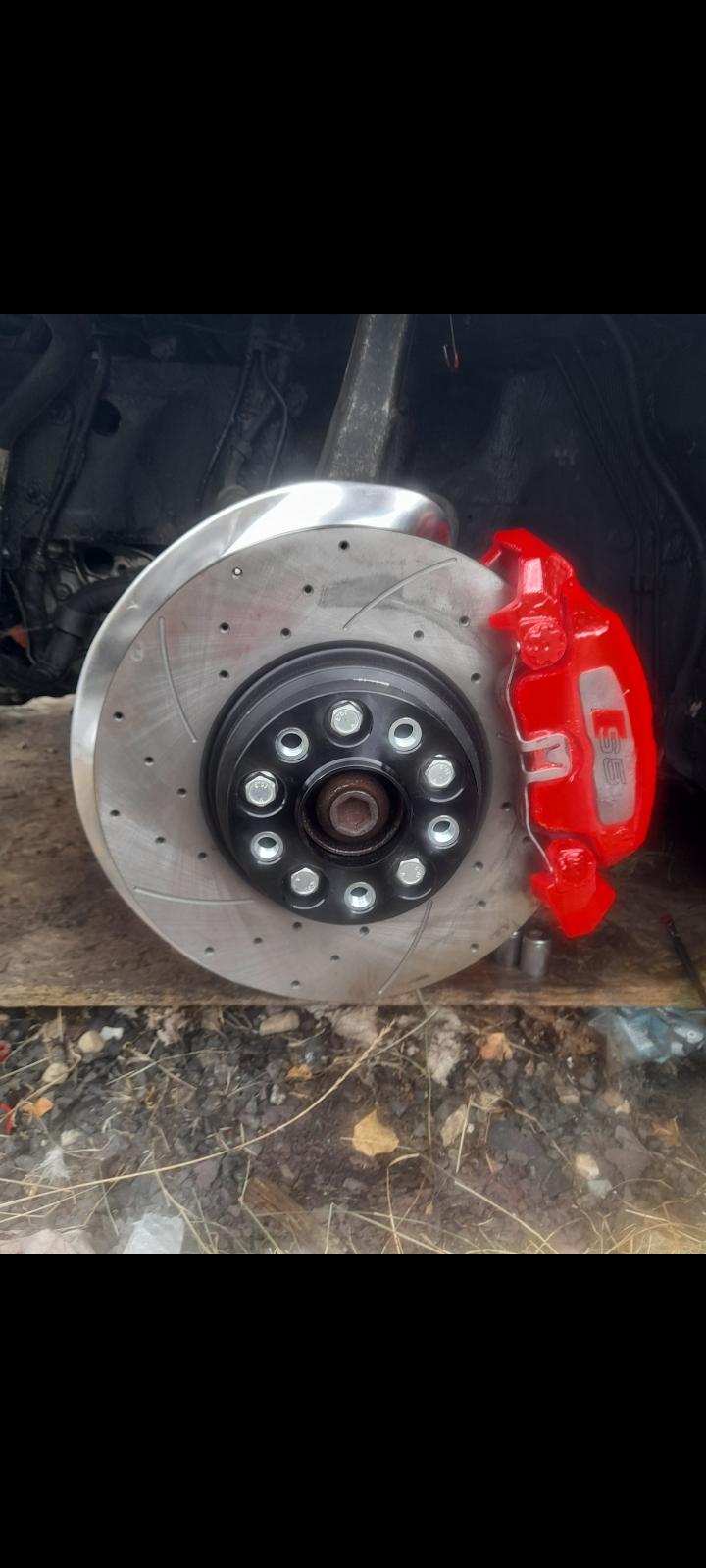

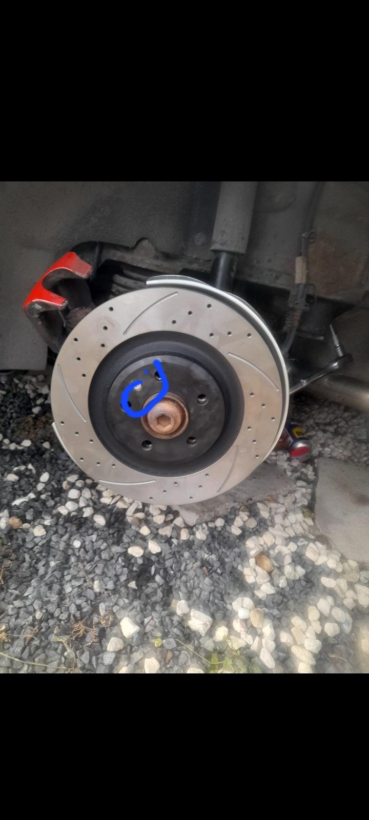

Discs and brakes and calipers with the dust shield going on lovely
Started on the back and it was a pig the screw that held the disc on was knackered so had to drill it out with a 5.5mm drill bit then tap it also see the level sencer damaged so got one of them coming
i have four of them cream crackered screws only realised when i took all the wheels off to give things a tidy up.no mention from seller about it.got them to do sometime.wish me luck lol
I only had the one to do and the air was bluer than blue used the drill with retractor just wouldn't give in the end thought f### it drill it out and tap it, so yea I do fill sorry for ya on !Removed! 4

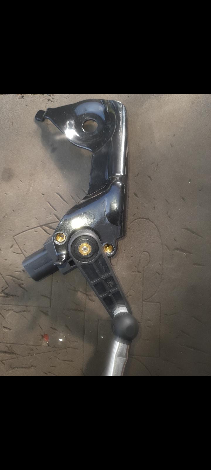

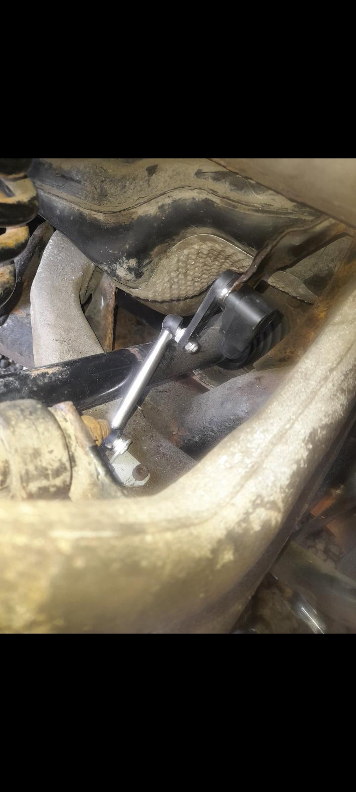

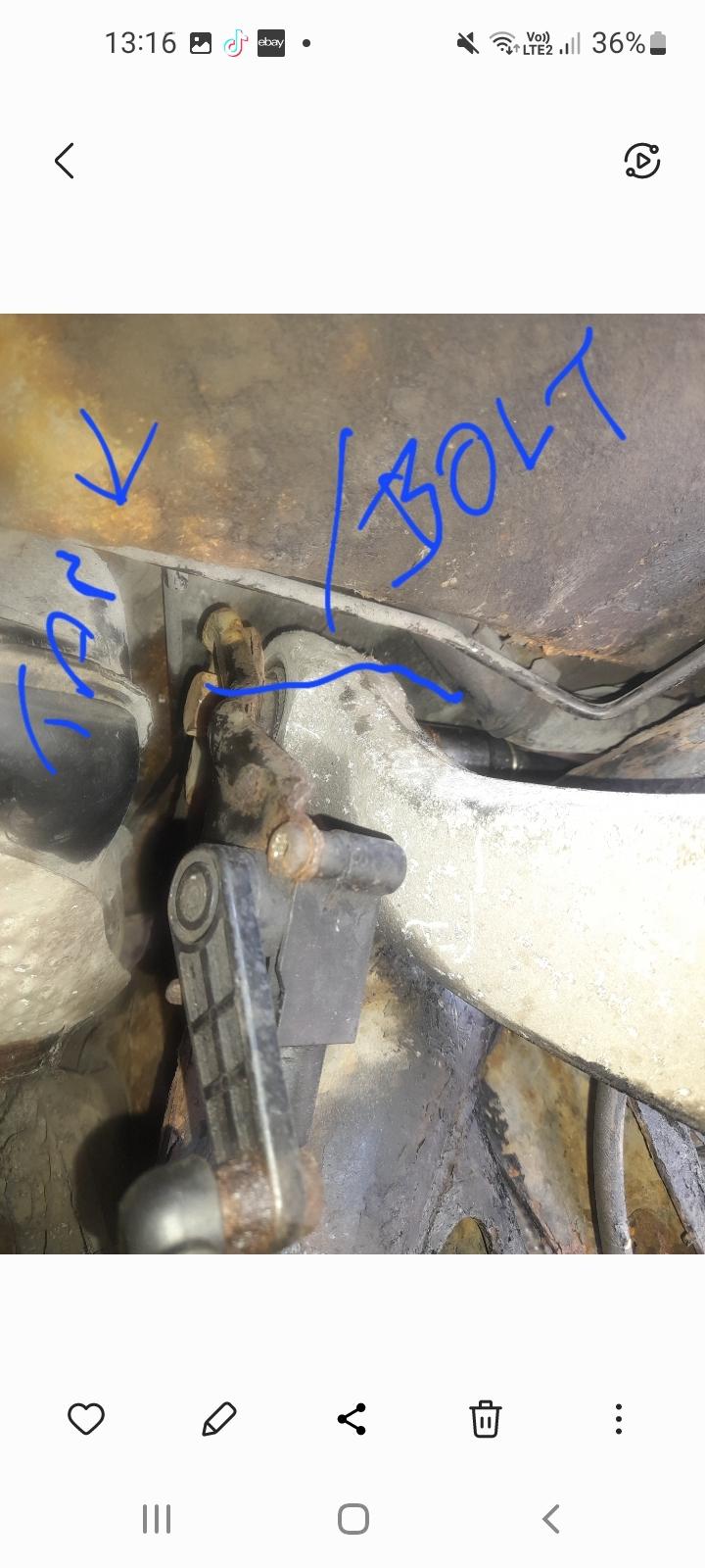

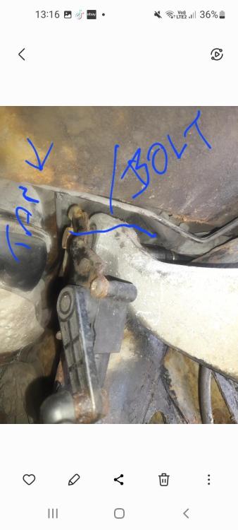

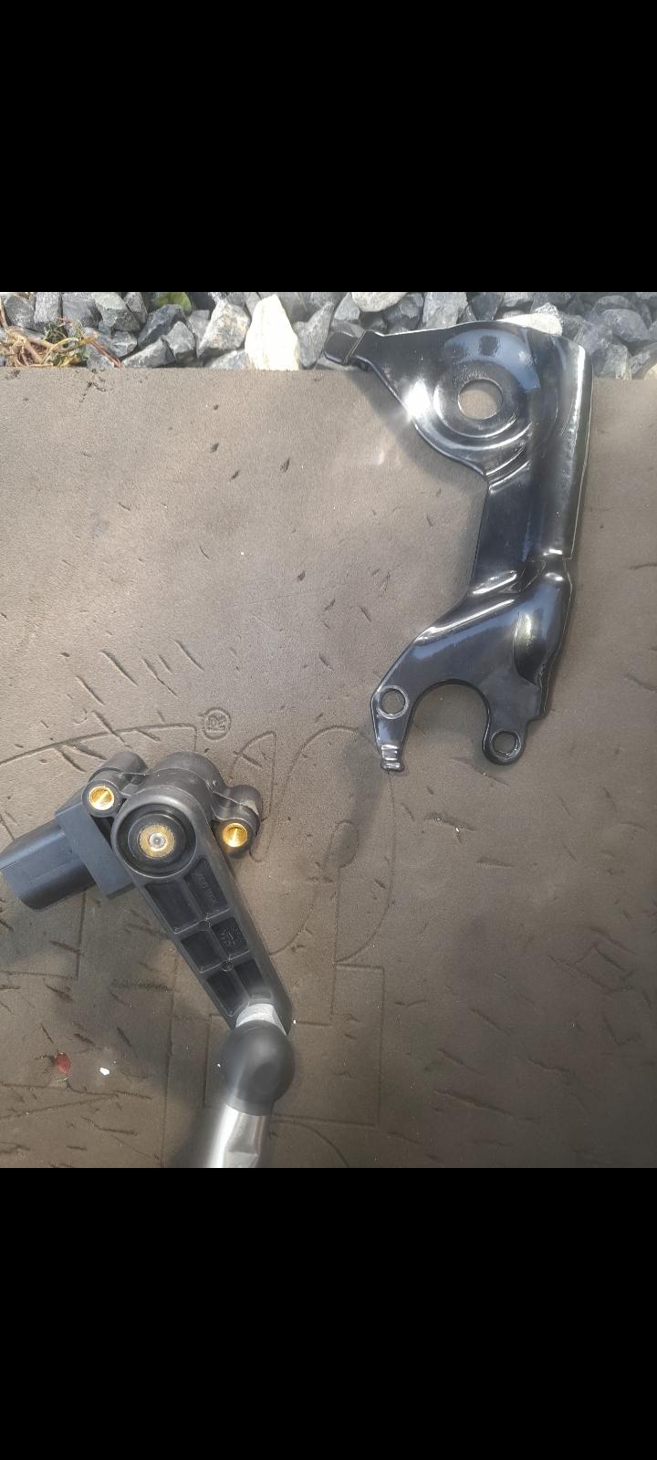

Well the rear headlight level sencer a pig it's bolted to the subframe witch is no big deal but the tank in the way👀 so thought na I'll use the old frame and just use the new sencer but had to cut the old screws off as thay was just turning but all came good in the end
I didn't have anything sophisticated (other than a small chisel) when I last had a disc screw stuck in my B8, so I hammered that into the screw in an anti clockwise direction, and it eventually came out
The headlight sensor was also noticed broken, just hanging around, when I had my rear springs changed, but we decided to just cable tie it safe 😄

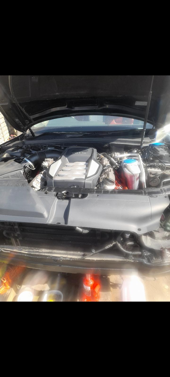

Not much done today put all the engine bay stuff all back on, ordered a new set of ballast for the lights as one wasn't working put new abs sencers on the rear, did try and start her but not enough in the battery 😔 so it be tomorrow now

nice clean engine bay
