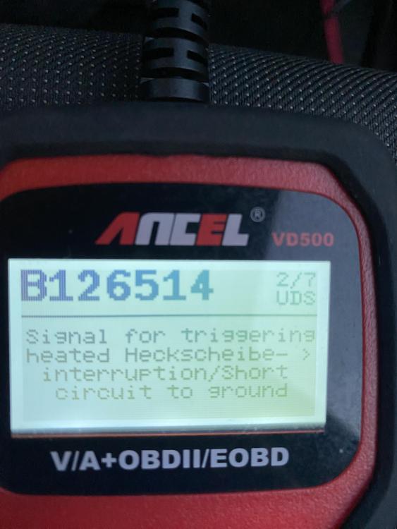

Yep, came up with the fault code B126514
Signal for triggering heated rear window interruption/short circuit to ground.4F2B27E3-400B-4EB5-AB82-EE3C6F3A9486.thumb.jpeg.4ae75224281d366ff418ad6ad4c89209.jpeg

Definitely sounds a wiring issue then. Might be worth removing the trim in the boot to inspect the wires

So I removed the trims, and everything was disconnected. 聽I鈥檝e reattached everything and all is working. 聽I noticed there are amplifiers on both sides, but there is only a suppressor on one side. 聽Don鈥檛 know if that鈥檚 right or not. 聽Not sure why they have been disconnected. Can only assume it was done when the back window was tinted.
