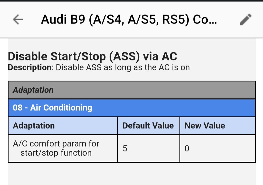

jdragon Posted October 29, 2022 Posted October 29, 2022 Have you owned your car from new? I don't have the details to hand but there's a VCDS hack that involes the stop/start and AC. Is the light on the stop/start button when it's deactivated?
NewtonHeath Posted November 1, 2022 Author Posted November 1, 2022 Hello Jon. I purchased the car 2nd hand and it is nearly 5 years old. The light on the centre console is unlit at all times, but the little A on the dash comes on green when the a/c is off (and the engine cuts out) but comes up with a line through it when the a/c is on, suggesting I have disabled the system when in fact, I have not touched it.

jdragon Posted November 1, 2022 Posted November 1, 2022 On 11/1/2022 at 3:04 PM, NewtonHeath said: Hello Jon. I purchased the car 2nd hand and it is nearly 5 years old. The light on the centre console is unlit at all times, but the little A on the dash comes on green when the a/c is off (and the engine cuts out) but comes up with a line through it when the a/c is on, suggesting I have disabled the system when in fact, I have not touched it. Expand Do you know the previous owner? The VCDS hack to disable the stop/start will only work with the AC on. When the AC is off, the stop/start works. I can understand why this may bother you. I'd be inclined to have someone with VCDS to check the module. Seems too much of a coincidence. Like @Magnet I switch of manually because of same reasons. I also never have AC switched off, so the hack wouldn't be an issue, but I don't mind pressing the button. This is where you will find in VCDS
