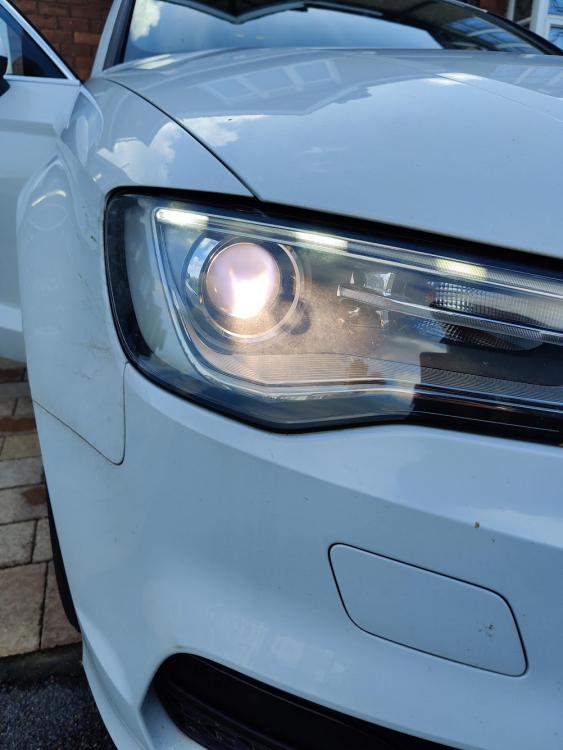

My right headlight has turned orange.
I am wondering is it just changing the bulb or something to do with the ballast?

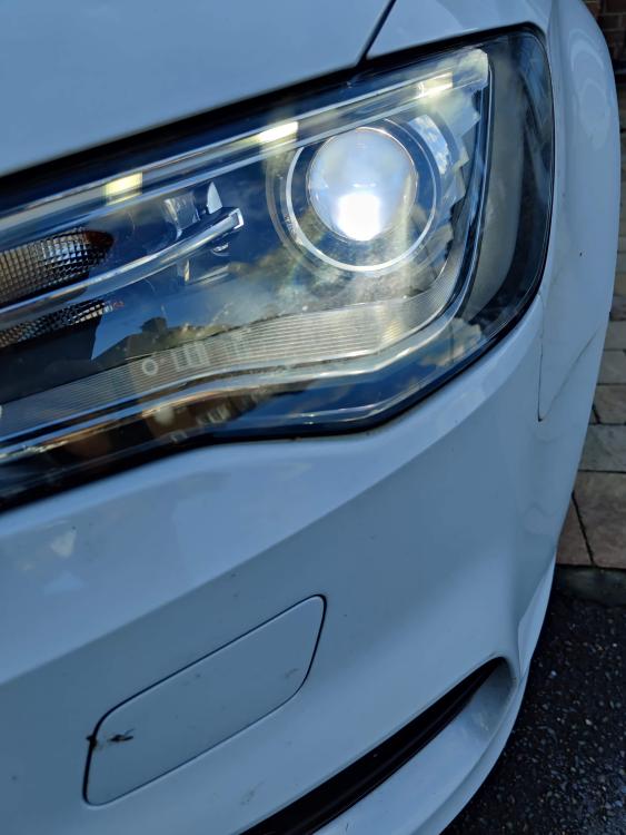

Thanks for responding, I have uploaded photo's of both sides.
Orange can't be seen properly because it's day time and the light is orange now.

Hi its the bulb needs changing if it was the ballast it would either not work or the light would flicker, its a fairly easy job to replace just remove the rear cover to find out what bulbs you have its printed on the rear of the bulb it will be a D3S or D5S which a good branded set [you need to replace both sides] will be around £130, no idea about garage costs as I have always replaced my own, 4500k is off white but if you go up to 5500k as long as the wattage is the same will give a more pure white light, the k rating equals kelvin which is light output without he heat halogen bulbs produce.

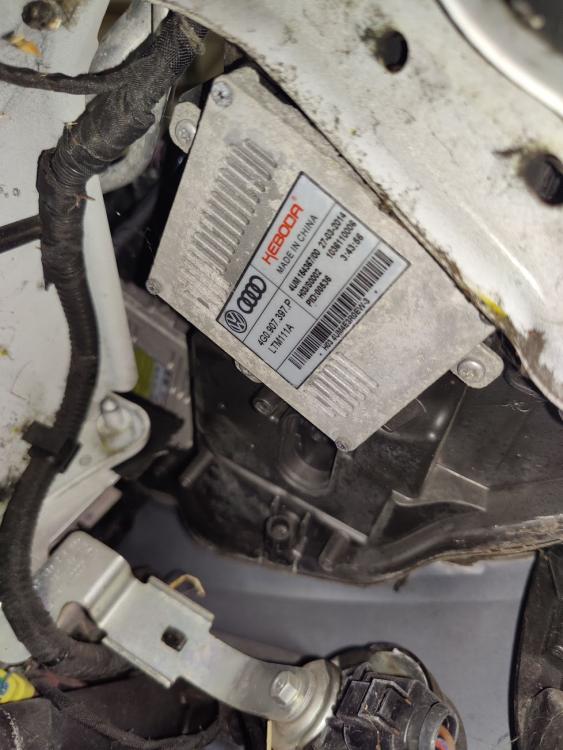

I just went to the garage today with a brand-new pair of bulbs (Philips X-tremeVision D3S)
The garage put it in (driver's side) and it would not power up. They said the ballast module is gone. This is now turning out to be a bigger headache.
Where can I get a new ballast?

Hi the part number is the 4G0 number bottom left, put that in eBay and I think you will find you are spoilt for choice they are probably used on Skodas and  a lot of other VAG models and are an easy change don't worry about the letter at the end of the number as thats a year denomination.

Hi any source you like as long as the part number matches, I would buy new as there is never any indication with second hand, I.E. how old/miles etc.
