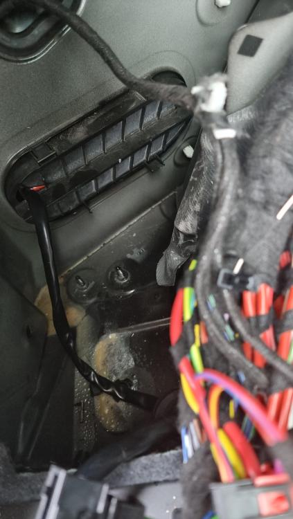

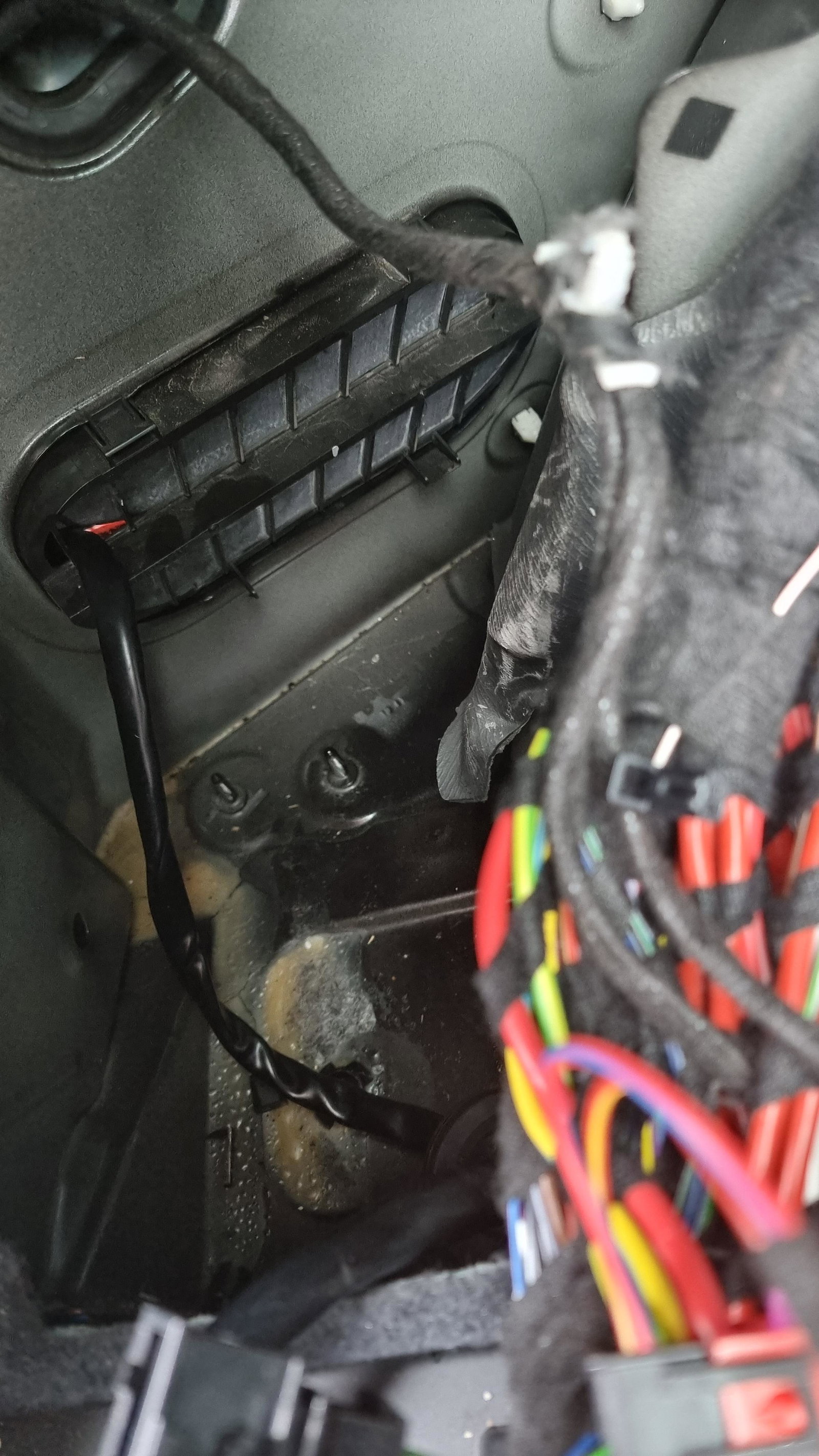

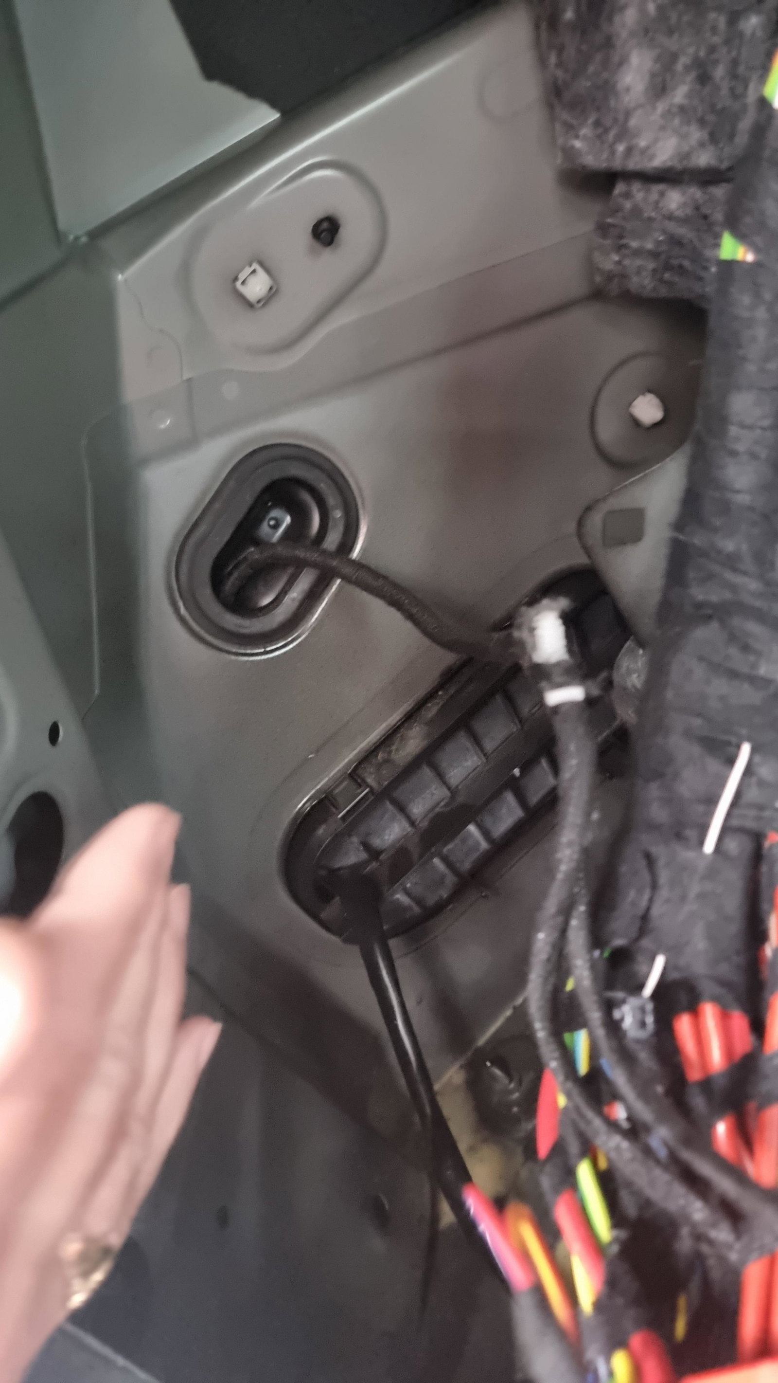

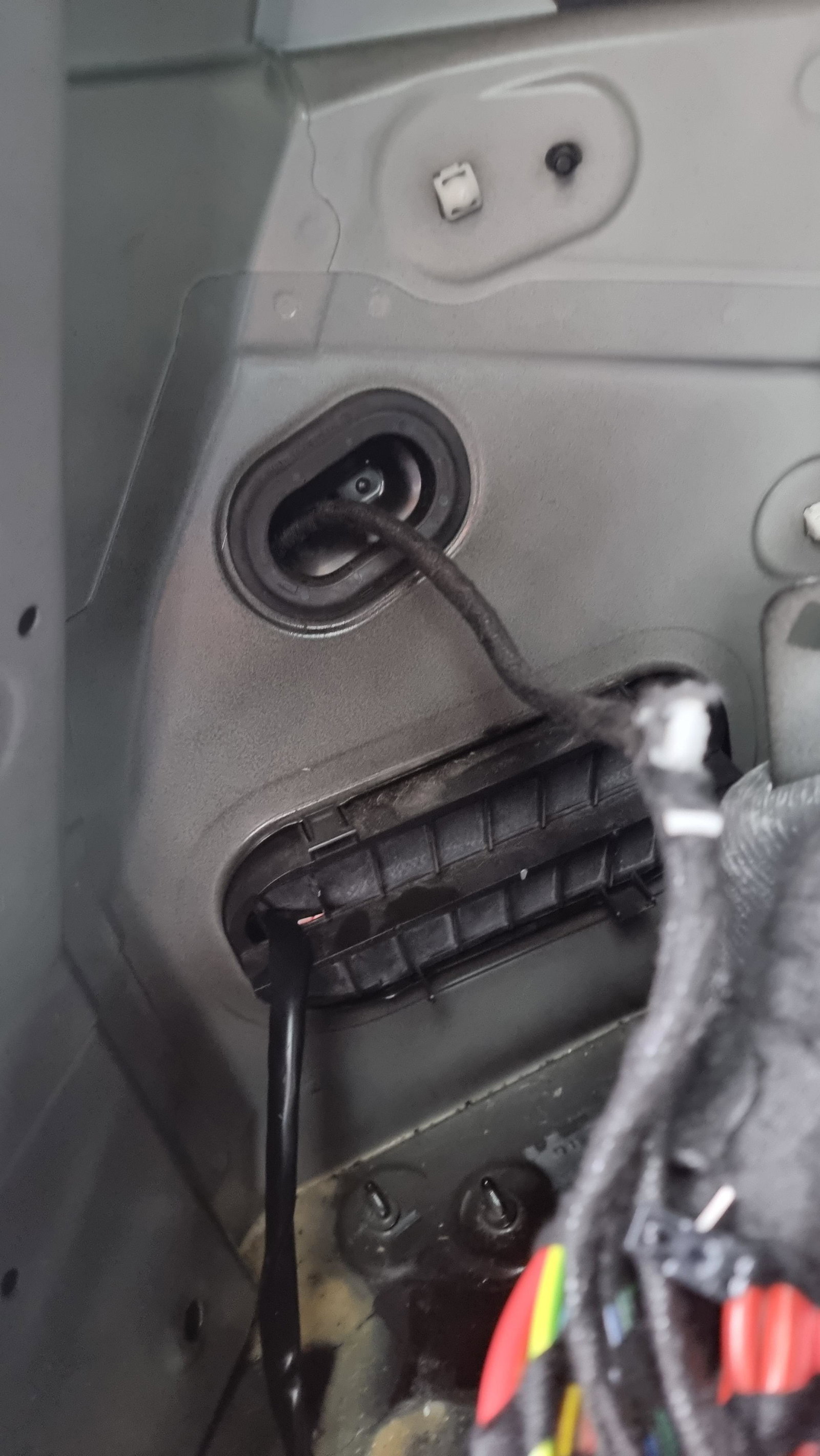

Colette Posted February 1, 2023 Author Posted February 1, 2023 Gromit was on the left you need to remove the side of the car inside this little rubber black thing is what was missing from our car and also the back vent wad broken due to being wired poorly. Here is an image if this helps
Rich88 Posted February 1, 2023 Posted February 1, 2023 Ah, thank you we have a little bit of water showing on the little vent at the bottom but the bulk of water seems to be coming from the metal part the hole where your hand is actually. and our tow bar wire comes straight from the middle of the car, pretty sure Audi are just trying to get out of warranty work if I'm honest Thanks for your help, much appreciated
