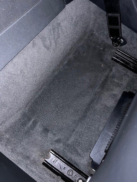

AudiTTSRoadster591 Posted November 7, 2022 Posted November 7, 2022 Hi Audi fam I drive a 2016 Audi TTS Roadster and noticed on the weekend when I got into my car that their was a pungent smell of damp in the car. After some self-investigating I established this was due to the carpet on the rear of the passenger seat becoming soaking wet which I expect is a result of the heavy rain we've had in the UK in the past couple of weeks. I believe the water is somehow coming in via the seals on the passenger side panel as there is no wet coming from the roof of the car etc. Has anyone experienced a similar issue before? Having looked on YouTube it looks like it could be down to the drain pipe in the side panel becoming clogged with debris which is causing the water to become trapped within, but this is just a guess at the moment. Have booked it in with Audi in the meantime, but any tips or tricks as to what might help would be appreciated. TIA Jordan Owner of Audi TTS Roadster 2016

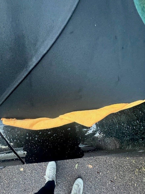

AudiTTSRoadster591 Posted November 9, 2022 Author Posted November 9, 2022 (edited) Thanks @Magnet @Steve Q - I've attached a couple of photos (one of where the leak is occurring and the other where I think the leak is coming from which I have temporarily put a micro fibre cloth over to hopefully stop some of the water ingress getting in) The seals all look intact to me and nothing unusual by looking at it. I've booked it into Audi for a diagnosis, but let's be real Audi are going to do whatever they can to financially sting me with the cost of the repair. This is the 2nd issue this year I've had as a result of water ingress in my Audi. It's not brand new but it's still not what I expect from a MK3 Audi TTS which should be built better. I never had any water ingress issues with my previous Mercedes or BMW. Edited November 9, 2022 by AudiTTSRoadster -JAM

AudiTTSRoadster591 Posted November 15, 2022 Author Posted November 15, 2022 Got an update on this guys! Had my car into my local Audi garage today and they've come back informing me that it requires cleaning to unblock the drains and removal of the carpet etc to drain out the water. They have said no parts are required, but it's quite a lengthy procedure at 8 hours labour as (apparently) they need to strip a load of parts off to get to the bit that requires cleaning. Audi have given me some good will on the labour cost, but it's still extremely expensive. They basically reduced the cost from £1622 (incl. VAT) which also includes the inspection fee down to £960 (incl. VAT) which works out at £120 per hour (incl. VAT) x 8 hours. I'm feeling an Audi specialist with a cheaper labour rate might be the way forward on this - Audi are daylight robbery, even with the good will discount 😞

En4n Posted July 23, 2024 Posted July 23, 2024 Hi, I have a 2015 TTS roadster, and have had the same problem. The drain pipe becomes clogged up with leaves, and so forth. Which then overflows, into the rear of the passenger seat. Where the Amp for the sound system lives. What a great design NOT! I had a light bulb moment, which was why not try a sink unblocker! That Cleans out grease and all sorts of stuff. So after pouring half of the (£4) bottle into the water collecting tank, I watched it for a few minutes. Then glug, glug the blockage seem to slow give way. I left it for about 10 minutes, then poured Luke warm water down the pipe. It had really cleared it out, I was amazed this simple but effective trick worked. So don't pay alot of money to a garage, get a sink unblocker. I also did the other side for good measure.
