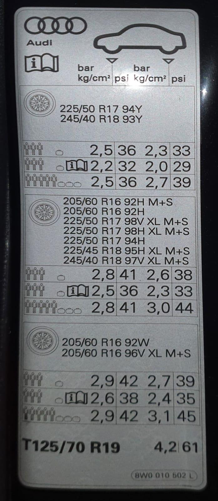

FMOB Posted January 21, 2024 Posted January 21, 2024 Look at the rating plate with the tyre pressures on (by catch on the drivers side door pillar), this will tell you the wheel/tyre combos that will fit as standard and doesn't knock the speedo out, etc. If none of these work then go off-piste with calculators and the malarkey. As for wheels, part numbers, etc - you need to find the parts diagrams online for your car as these will list part numbers for the OEM wheels, obs check with Audi the part number is correct before buying so you get the right wheels.
bhuman Posted November 11, 2024 Posted November 11, 2024 Hi All, took my sweet time to get this done as I just couldn't find genuine 18" Rotas with the correct center bore. So have opted for replicas. I just purchased these: https://www.omiwheels.com/products/18-audi-ttrs-style-alloy-wheel-gun-metal?_pos=1&_sid=f48303742&_ss=r I didn't get them machined as I don't want to deal with the corrosion and have booked in (not paid yet) for All Season Michelin Cross Climate 245 40 R18 to be fitted as it was the only 18" selection when booking. This was before I remembered there was a rating plate (sorry @FMOB)that says 225 45 on winter tyres (Now I understand the OEM for 18" is 245 40). Does anyone know whether I should change them to 225 45 - considering narrow tyres are better in snow, and these have less difference on the speedo and overall diameter and probably fewer issues with width than the 245 40 as the new rim is now 8in with ET 45 rather than the 7/7.5in ET 39 I have just now. Any advice is really welcome - I live in central belt Scotland where snow can be intermittent and sporadic - you might get it, you might not - though allegedly it is due next week!! ive attached the rating plate
Magnet Posted November 11, 2024 Posted November 11, 2024 Hello S ( could you let us know what your name is please - it’s far more personal to be able to address you). Anyway, first point- it appears that both 18 inch are XL rated, and these will obviously adversely affect the ride quality. I can see a number of 17 weren’t. I’m not sure where the narrow tyre/ better snow grip comes from. I must admit that theory is new to me, and can only run that to a limit of considering the grip on your bike tyre on ice, compared with the car tyre !? The choice of 225 or 245 and their associated profiles may be strongly influenced by price, which will be affected by popularity. Kind regards, Gareth.
bhuman Posted November 12, 2024 Posted November 12, 2024 Hi @Magnet Many thanks and I believe it's exactly as you mentioned -narrow tyres cuts thru snow better, but I've since read other people's comments saying the wider wheel didn't have too adverse an effect in winterish weather. I've left it too late anyway - this is what happens when you ponder for too long and then just go for it. It's all being delivered & fitted on Thurs, I'm sure it'll all be alright on the night as they say. 🙂
