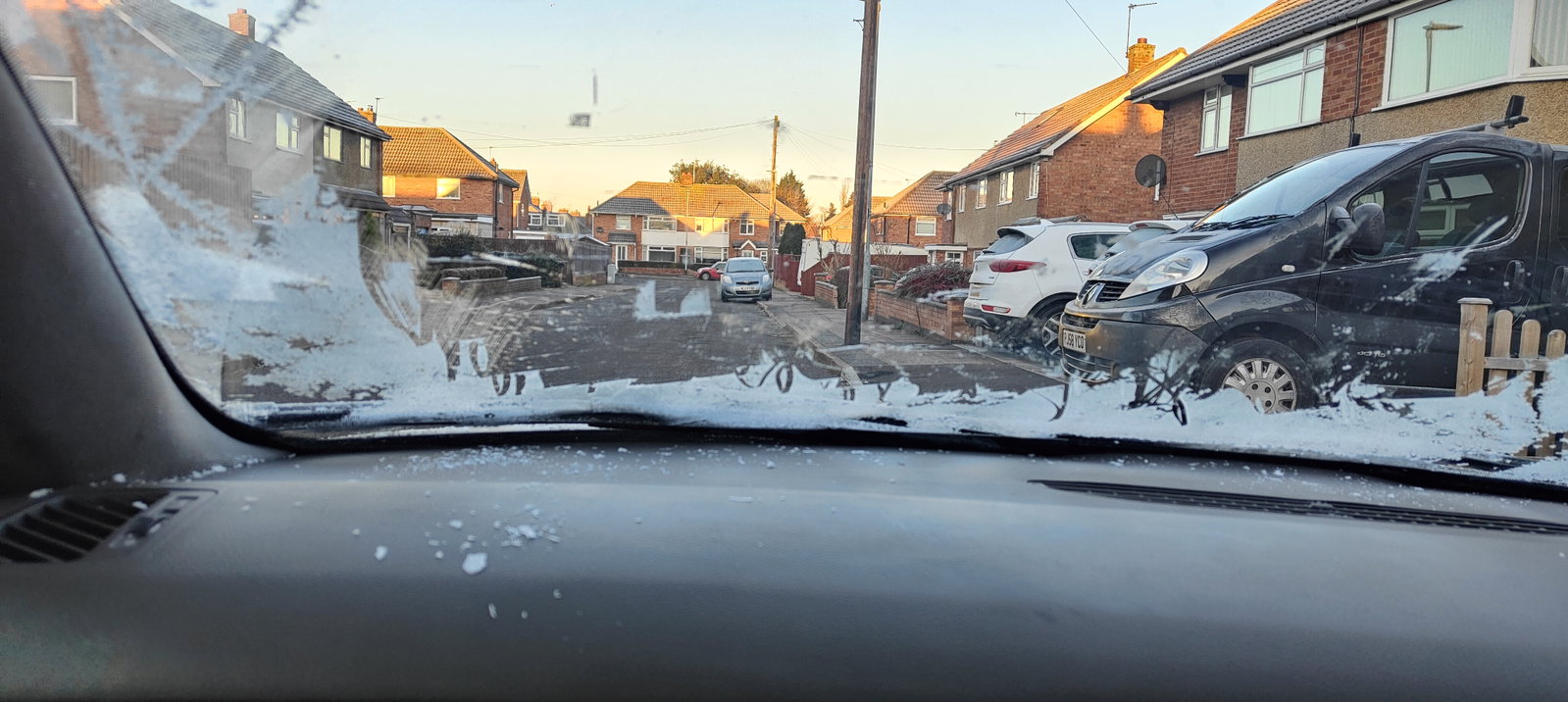

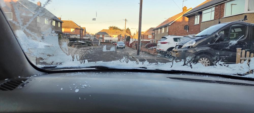

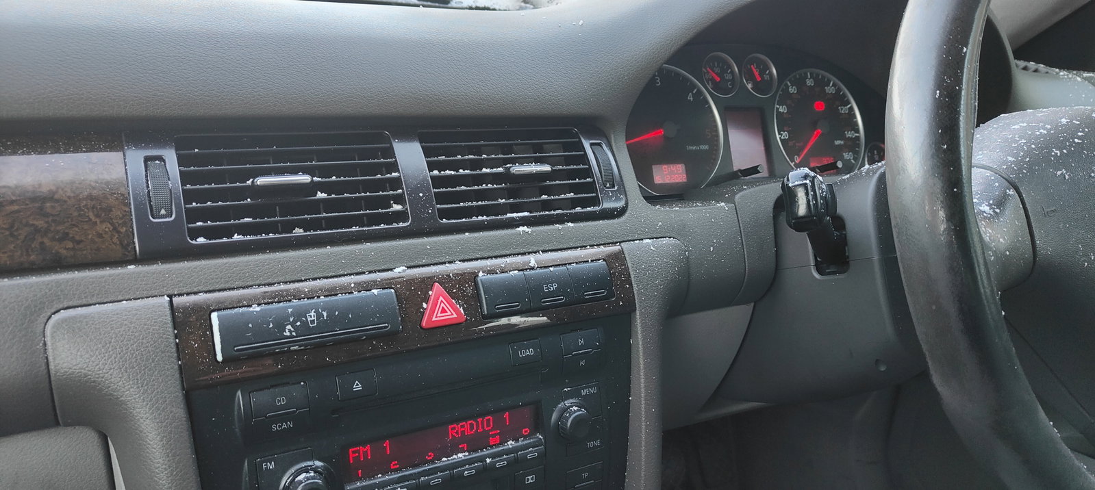

Steve Q Posted December 15, 2022 Posted December 15, 2022 Interesting day. Not only did I have to defrost the windscreen on the inside which created nice snow shower, but the outside temp gauge was telling me it was 13 degrees. Oh the irony 😂🤣 just to add no wet carpets. No issues with battery tray or pollen filter housings etc.
