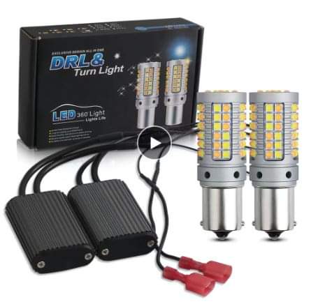

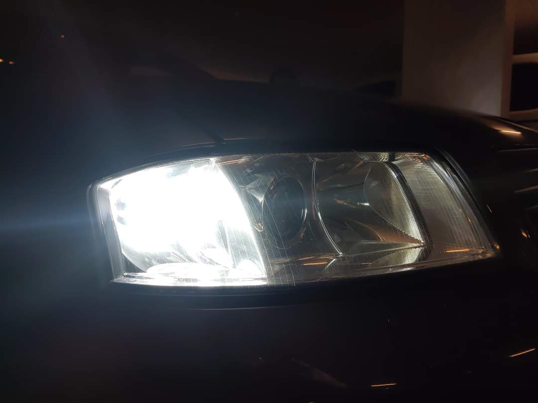

Now in my A6 4.2 I simply integrated DRL in Turn Signal Lights with Special BAU15S DRL Bulbs from China. See Pictures. To check if DRL Works, I added a Control Light on the Light Switch.

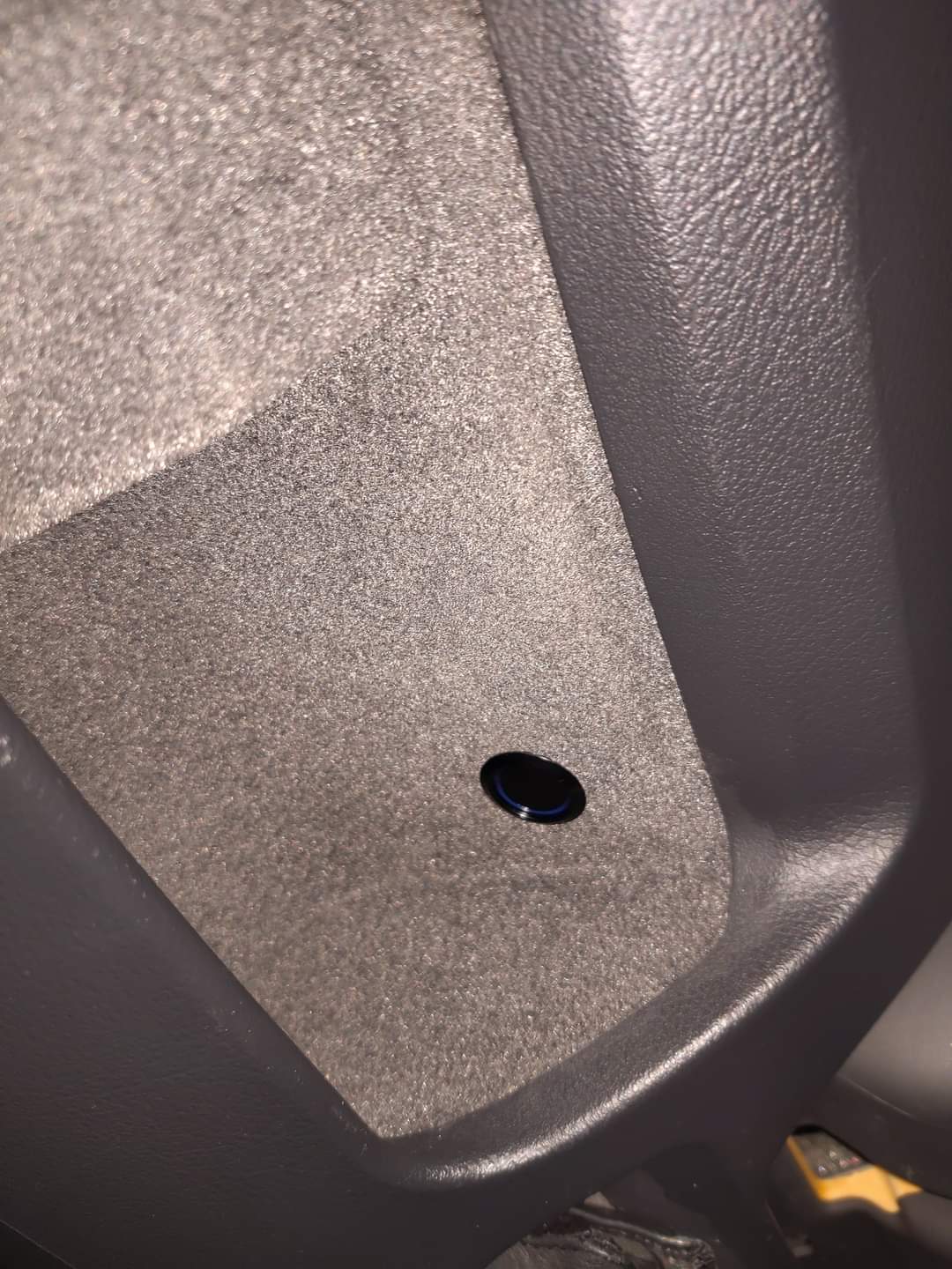

- Added a new Wire from the Light Switch, DRL Pin, to an additional Switch, in the Storage Department left underneath the Steering Wheel. Have this Switch to Switch Off the DRL if I don’t want.

- To install the Bulbs I had to bore small Holes in the Bulb Holder… Then Cut the Cables from the DRL Lights, pull the DRL Cables through the Holes in the Bulb Holder, install the Bulbs, solder Cables together, seal rest of the Hole with Silicone and install the Bulb Holder with new Bulbs in the Headlight. Then Connect with the new DRL Wire. Done!
The Bulbs will work as DRL now, if you use Direction Light the DRL Switch off on this Side and then Switch on again.
Like this Solution very much. Does not change the Look from the Car and I don’t need to wear out my Headlights!
