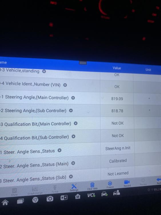

Clintski Posted December 29, 2022 Posted December 29, 2022 Steering angle sensor i recalibrated it but I get this in image I attached can anyone please help?
Stevey Y Posted December 29, 2022 Posted December 29, 2022 2 minutes ago, Clintski said: Steering angle sensor i recalibrated it but I get this in image I attached can anyone please help? Hi sorry but why did you recalibrate the sensor was it replaced? Steve.
Clintski Posted December 29, 2022 Author Posted December 29, 2022 I changed my battery then abs light came on with fault 00778 steering angle sensor fault so recalibrated it but fault would not clear
Gadgetman Posted December 29, 2022 Posted December 29, 2022 Silly suggestion, but did you drive it after battery change as this normally clears it.
Clintski Posted December 30, 2022 Author Posted December 30, 2022 Thanks for reply yes I’ve been driving it since and hasn’t cleared!! I’m unsure from the picture it says main controller 819.09deg and sub controller 818.78 is the sensor broke?
Ahmed el aoufi Posted February 9, 2024 Posted February 9, 2024 On 12/30/2022 at 2:10 PM, Clintski said: Thanks for reply yes I’ve been driving it since and hasn’t cleared!! I’m unsure from the picture it says main controller 819.09deg and sub controller 818.78 is the sensor broke? Yes you need to charge it or do the reset in the eeprom
