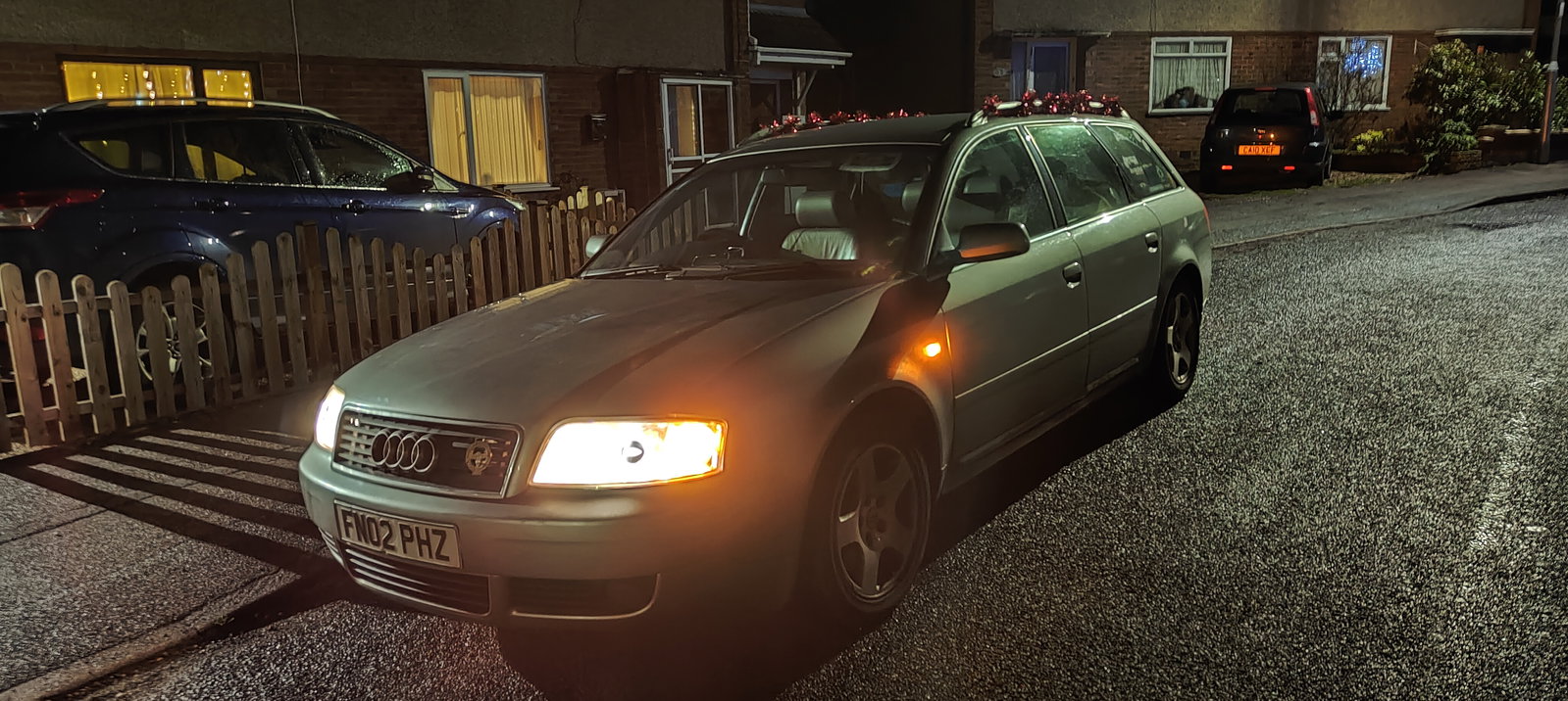

Steve Q Posted December 30, 2022 Posted December 30, 2022 As you can see the indicators are stuck on when the stalk is used. I'm suspecting the hazard switch or one of two relays In the switch has failed. What are your thoughts?聽 聽
coupe4 Posted December 30, 2022 Posted December 30, 2022 i had a 2004 model steve and mine went the same way,it was the hazard switch that had failed.an easy fix. 1
Steve Q Posted December 30, 2022 Author Posted December 30, 2022 1 hour ago, coupe4 said: i had a 2004 model steve and mine went the same way,it was the hazard switch that had failed.an easy fix. Thank you so much 馃槉馃檹 at least I'm on the right lines.聽
