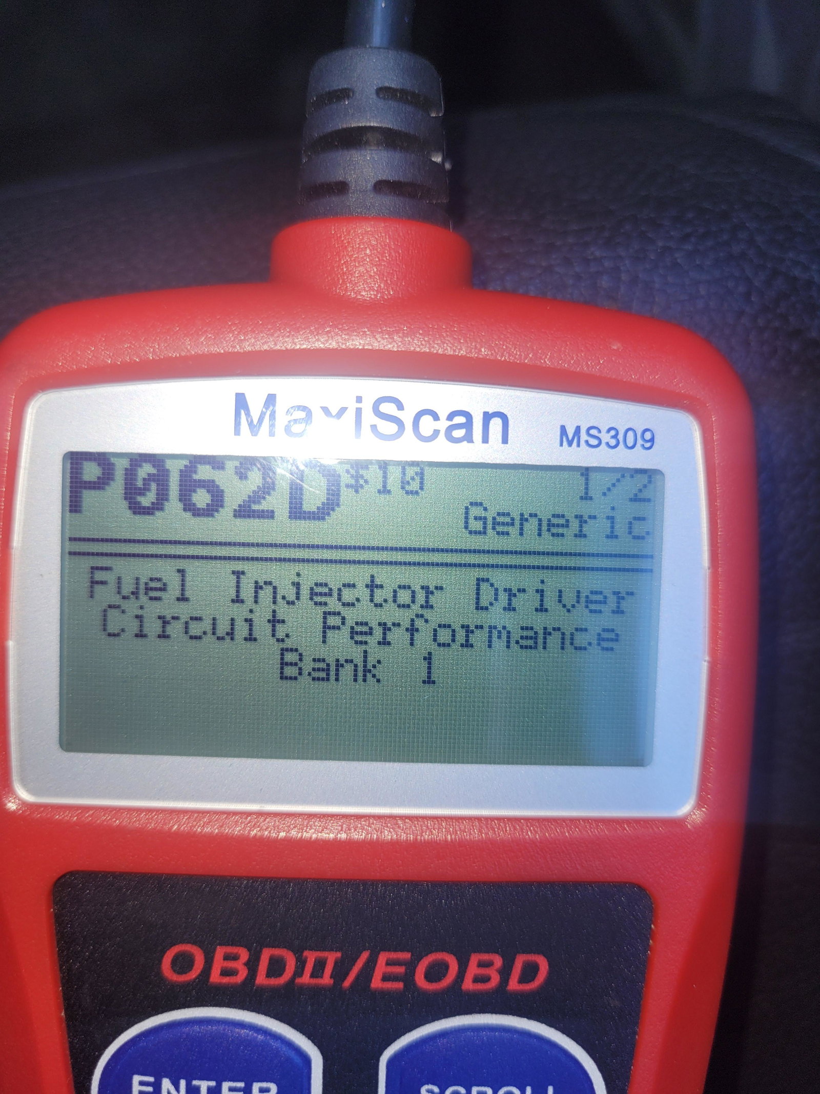

marc74 Posted January 22, 2023 Share Posted January 22, 2023 Guys I have a audi a3 8p 2.0 tdi bkd Over the last week it's a pain to start in the morning but when it's started runs absolutely mint Quote Link to comment Share on other sites More sharing options...
Steve Q Posted January 22, 2023 Share Posted January 22, 2023 Could be an injector as per the diagnostic check. You could also look at changing the glowplugs and glowplug relay to see if that helps it start quicker. When I had a similar issue on my V6 A6 diesel only 3 of the 6 glowplugs were working. Quote Link to comment Share on other sites More sharing options...

marc74 Posted January 29, 2023 Author Share Posted January 29, 2023 Hi guys changed the injector and all four glow plugs and it's still the same? Quote Link to comment Share on other sites More sharing options...
Steve Q Posted January 29, 2023 Share Posted January 29, 2023 1 hour ago, marc74 said: Hi guys changed the injector and all four glow plugs and it's still the same? Did it say which injector was at fault? Quote Link to comment Share on other sites More sharing options...
Magnet Posted January 29, 2023 Share Posted January 29, 2023 Hello Marc, Sorry to hear all your good work and expense has unfortunately not solved the issue. I’m very much from the school of DIY fixing wherever possible, and so can sympathise with your plight. If it were mine, having spent time, effort and expense on it, I would now seriously consider ‘investing’ in an hour’s expertise with a trusted local diesel specialist - not an ‘ordinary’ local garage. It’s quite possible that they will have come across such issues before, and would be able to home in on the offending component. Kind regards, Gareth. Quote Link to comment Share on other sites More sharing options...
marc74 Posted January 29, 2023 Author Share Posted January 29, 2023 (edited) 2 hours ago, Steve Q said: Did it say which injector was at fault? The fault said injector driver bank one Edited January 29, 2023 by marc74 Quote Link to comment Share on other sites More sharing options...
