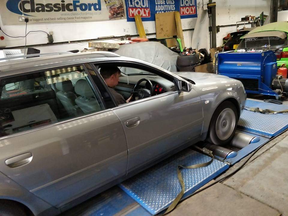

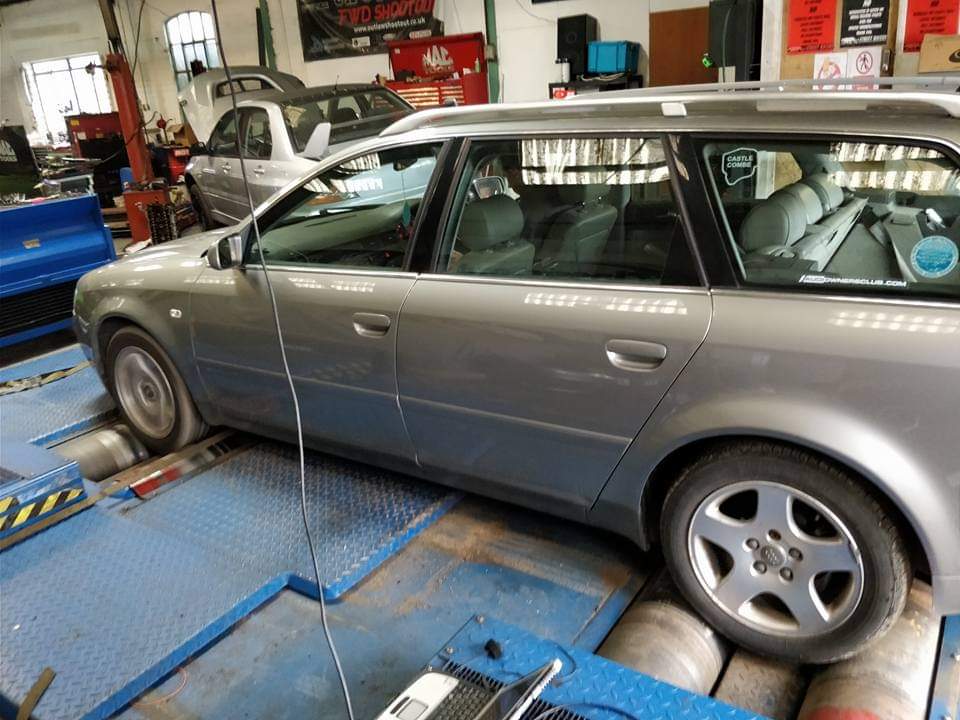

Steve Q Posted February 7, 2023 Posted February 7, 2023 Worth seeing I'd they do. This is a rolling road, with my car on it. It allows to get a more accurate map tailored to the car
