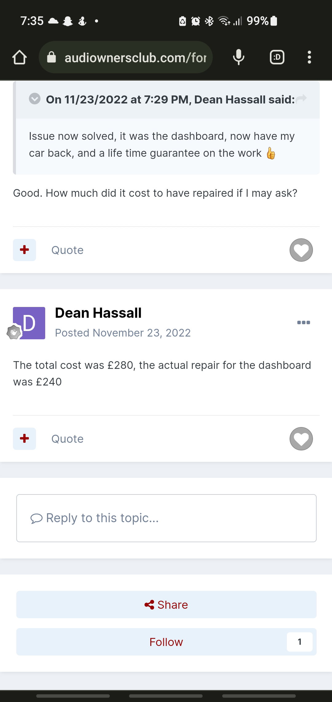

Darylbob Posted February 27, 2023 Author Posted February 27, 2023 14 hours ago, cliffcoggin said: What thread do you mean? The only one I saw was about a fuel pump. This one
Darylbob Posted February 27, 2023 Author Posted February 27, 2023 14 hours ago, Stevey Y said: Hi there are tutorials for this dash removal on YouTube they are not difficult, would suggest using ECU Testing, google up their site and put in a request they are very efficient and that is where the other guy got his fixed. Steve. Yes cheers Steven I've already seen them, looks straight forward I'm going to remove it later this week, I've spoken to a few auto electricians who've said they'd put money on it being the instrument cluster needing repaired with it being fairly common on a3's. Will definitely consider them if the other guy had a good experience with them, I'll get in touch today, thanks👍.
