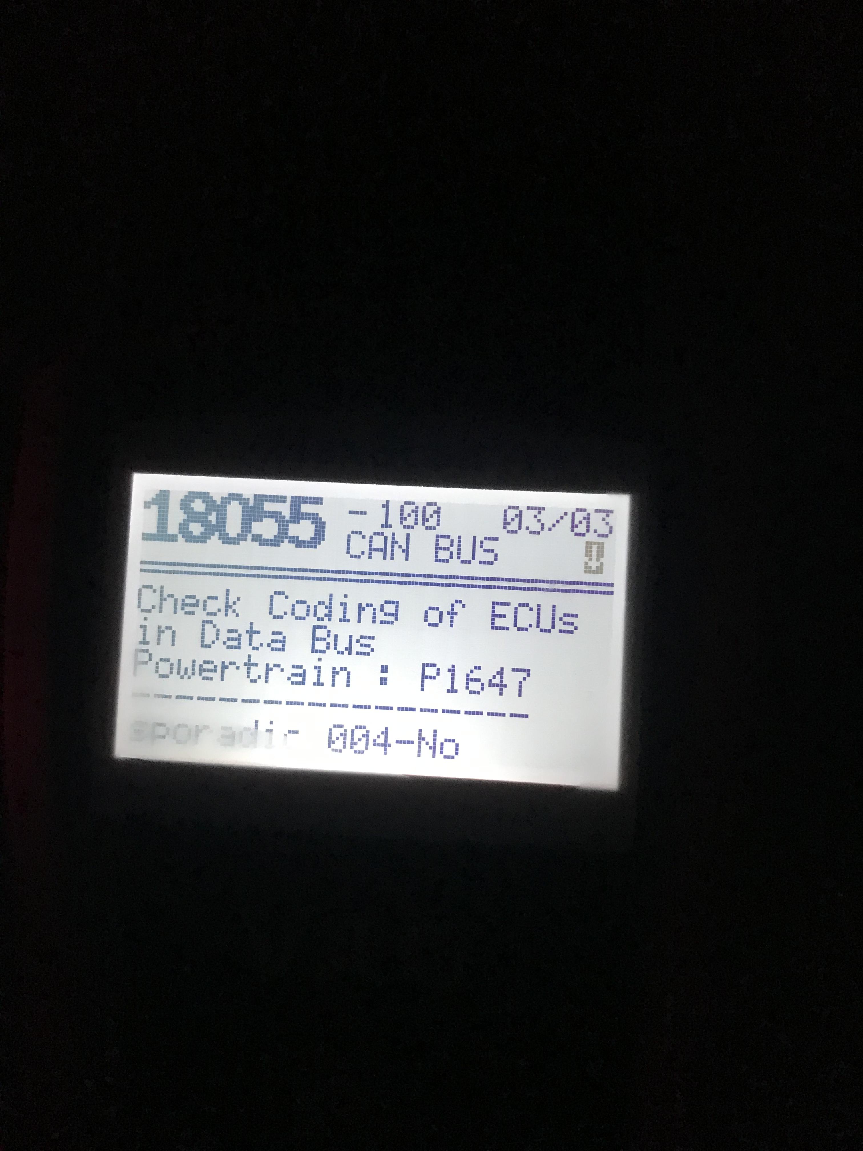

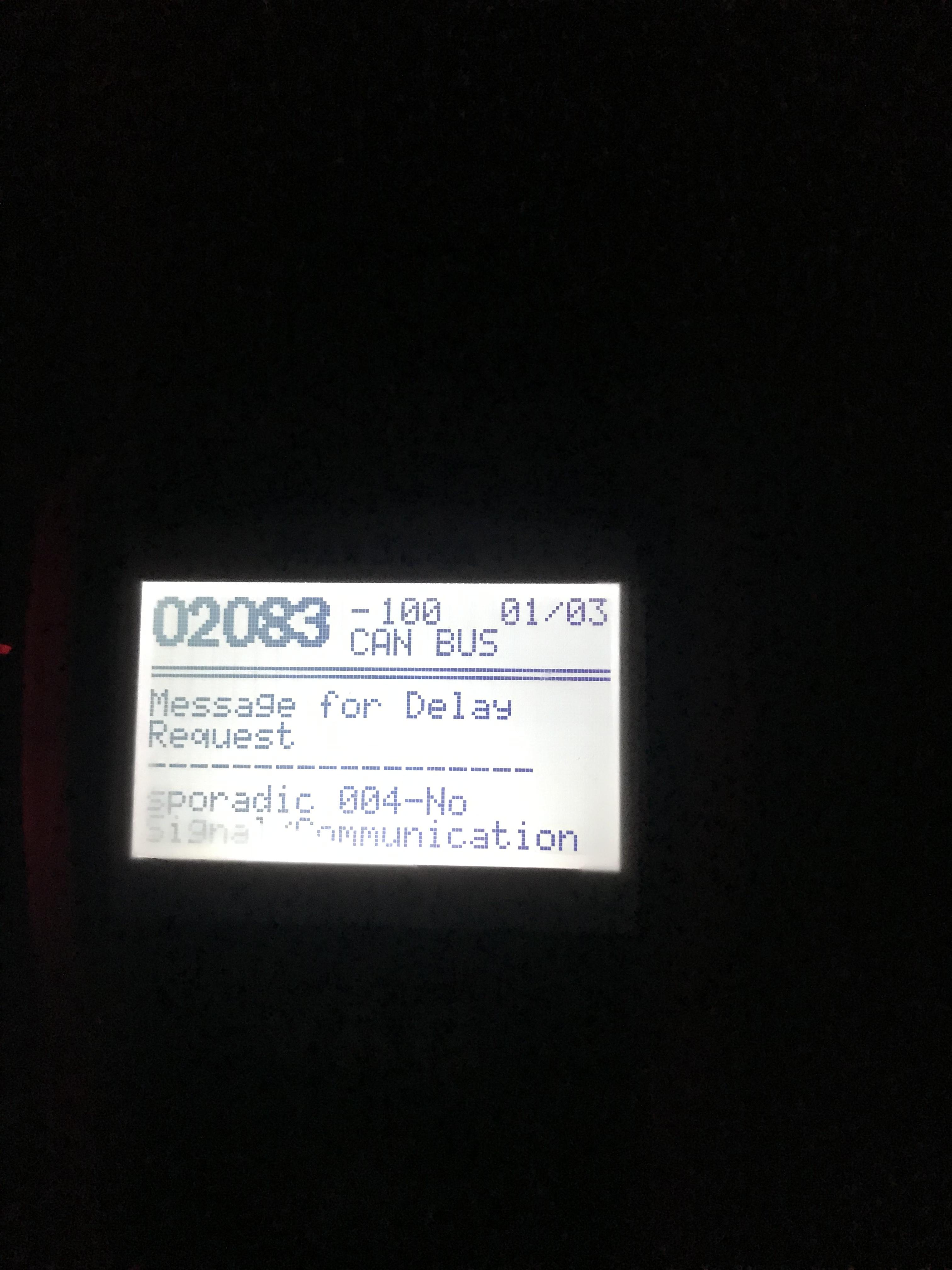

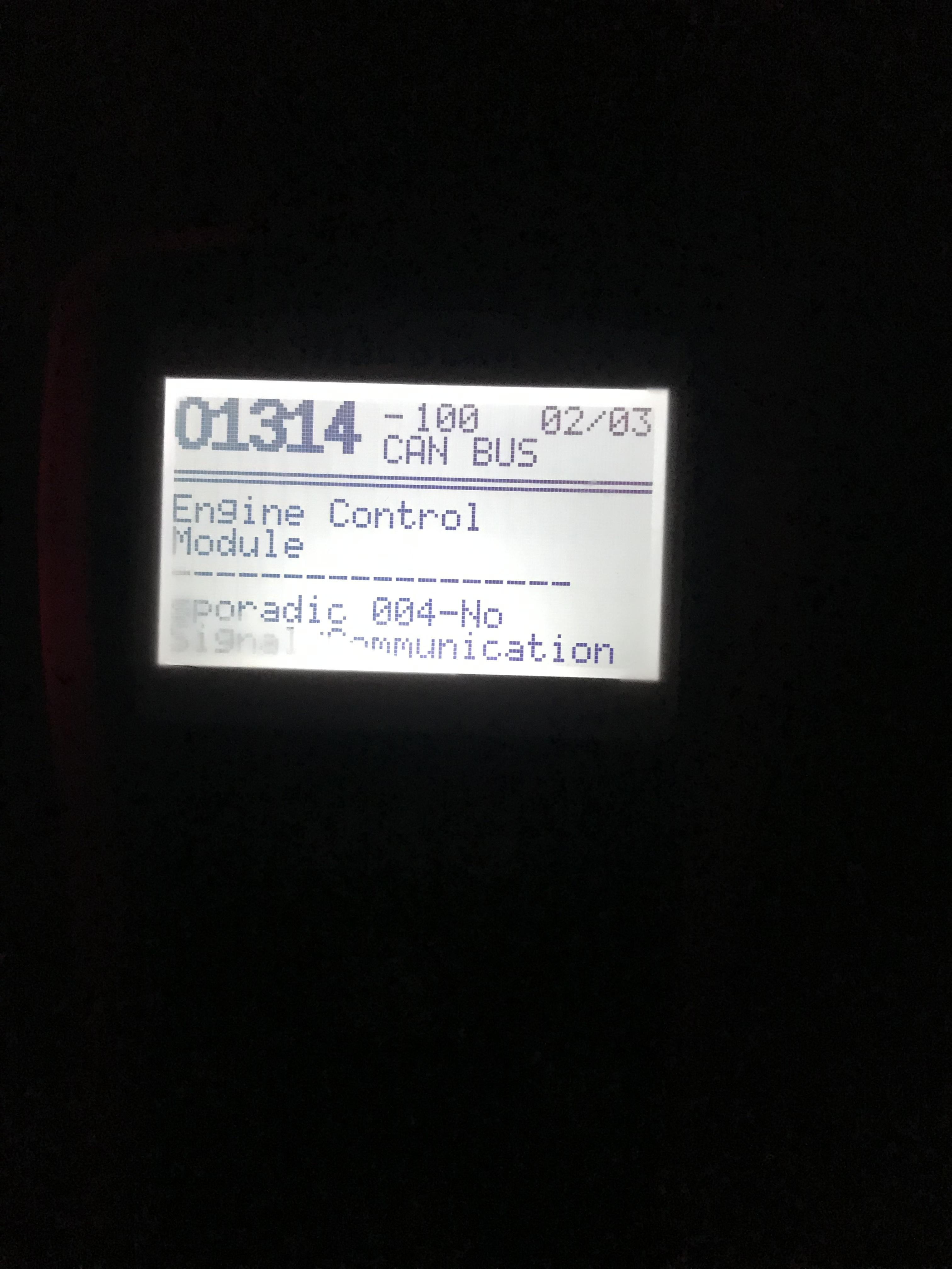

2A2-1A6 Posted March 11, 2023 Share Posted March 11, 2023 Anyone had the following issue? car stopped suddenly and just about every warning came up in the dash. handbrake fault abs light esp warning steering lock fault car will not start now turns over but feels like no fuel is pumping. I’ve plugged in a fairly basic code reader and get error codes shown in photos. a local garage tried their reader and can’t get connection to the ecu. where do you think I should start? Thanks in advance. Tony. Quote Link to comment Share on other sites More sharing options...

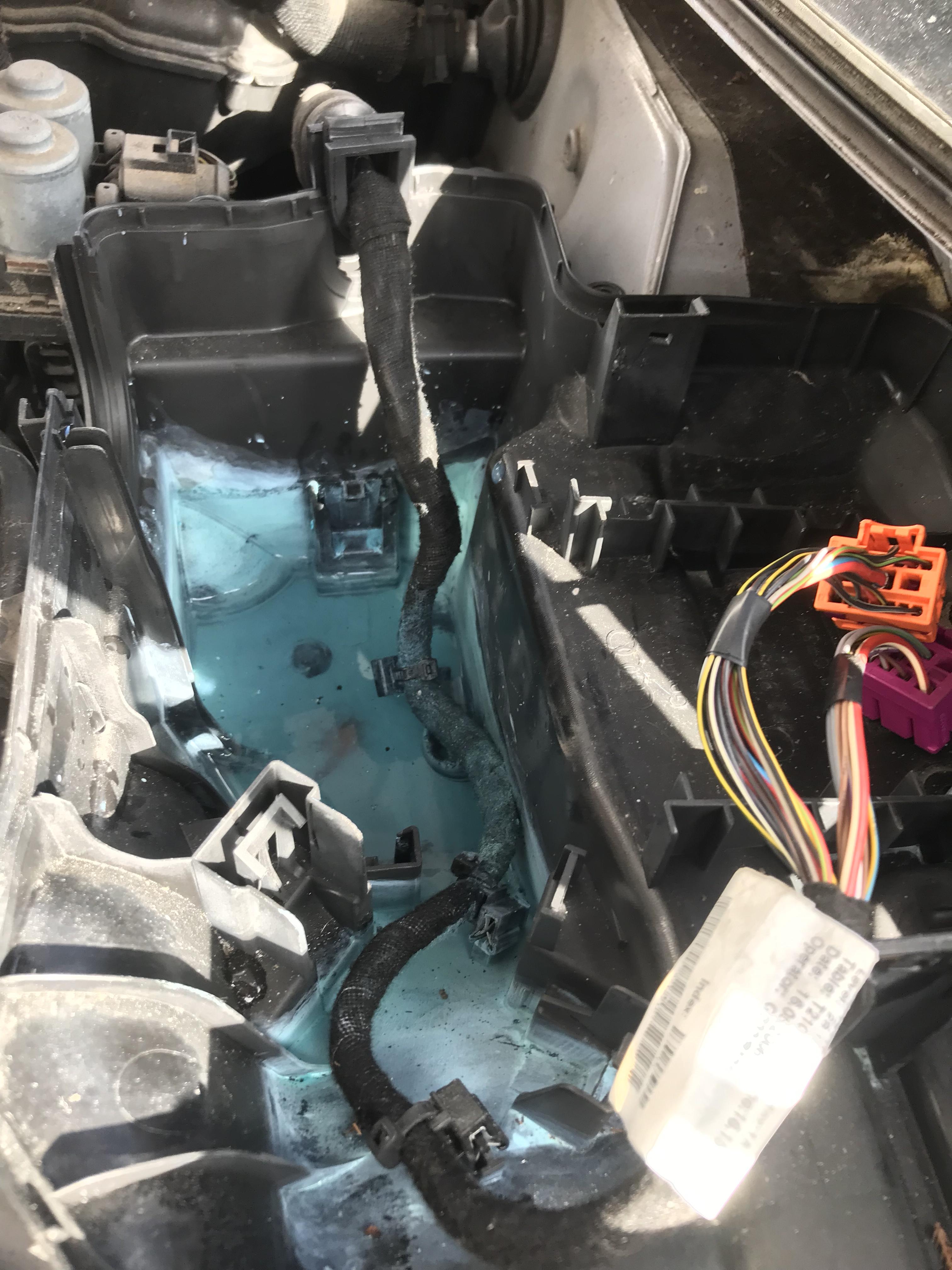

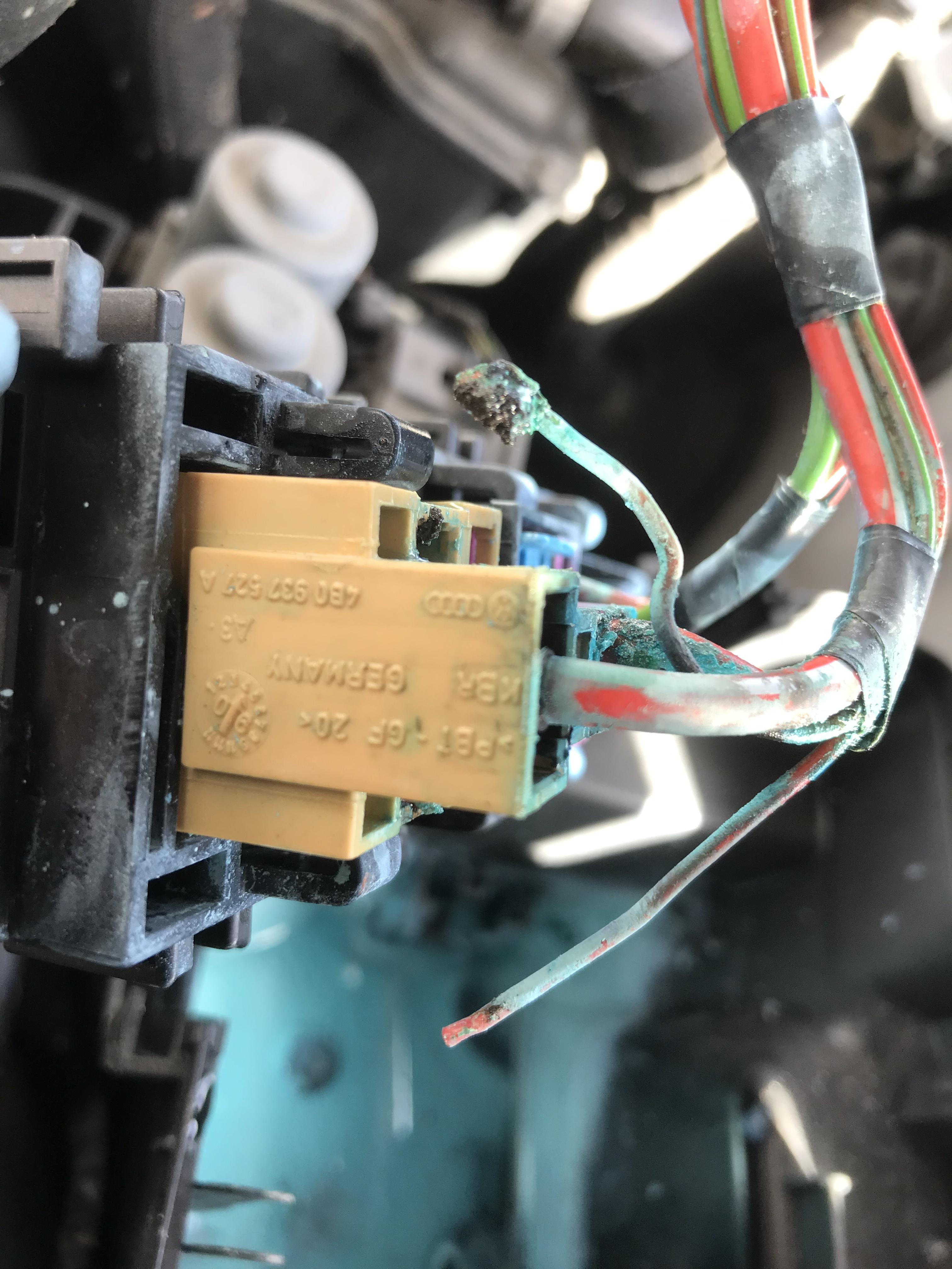

2A2-1A6 Posted March 22, 2023 Author Share Posted March 22, 2023 Fixed it. Relay holder was sat in water and had dissolved. 1 Quote Link to comment Share on other sites More sharing options...
Steve Q Posted March 24, 2023 Share Posted March 24, 2023 On 3/22/2023 at 9:15 PM, 2A2-1A6 said: Fixed it. Relay holder was sat in water and had dissolved. No way! Is that due to blocked drains? Quote Link to comment Share on other sites More sharing options...
2A2-1A6 Posted March 24, 2023 Author Share Posted March 24, 2023 Yep. There is one fairly central at the base of the windscreen. Fairly large diameter but enough leaves and mud washed down had blocked it. I’d recommend checking it ASAP. Quote Link to comment Share on other sites More sharing options...
Steve Q Posted March 24, 2023 Share Posted March 24, 2023 31 minutes ago, 2A2-1A6 said: Yep. There is one fairly central at the base of the windscreen. Fairly large diameter but enough leaves and mud washed down had blocked it. I’d recommend checking it ASAP. I had something similar on my much older A6. Seems to be common problem on Audi's. Quote Link to comment Share on other sites More sharing options...
