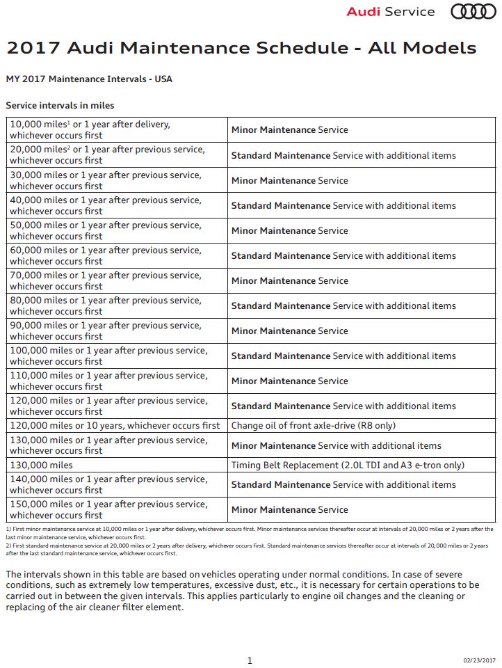

Steve Q Posted March 25, 2023 Posted March 25, 2023 Just found this one for 2017 cars. It's for USA though. But looking at mileage its not different. 1

Magnet Posted March 25, 2023 Posted March 25, 2023 Thanks Steve, I would have thought that most of the basic ‘inspection’ principles would be much the for most models - belts vs. chains excepted. Kind regards, Gareth.
Steve Q Posted March 25, 2023 Posted March 25, 2023 3 hours ago, Magnet said: Thanks Steve, I would have thought that most of the basic ‘inspection’ principles would be much the for most models - belts vs. chains excepted. Kind regards, Gareth. Very true, I think it is. The exception might also be e tron models (hybrid ones)
