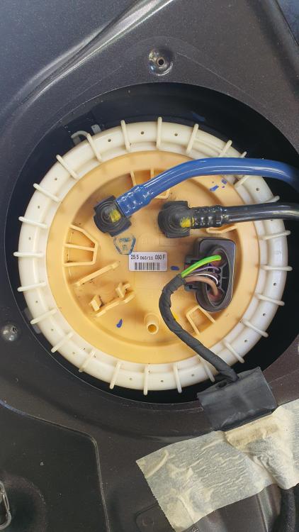

JDD Posted March 30, 2023 Share Posted March 30, 2023 (edited) How many fuel sensors does a 2011 A6 Allroad have? Seriously! ... apart from the sensor/pump combo Part #4F0 919 050F Edited March 30, 2023 by JDD Add text Quote Link to comment Share on other sites More sharing options...

JDD Posted April 2, 2023 Author Share Posted April 2, 2023 (edited) On 4/1/2023 at 4:07 PM, Steve Q said: Just one I think. Well that seems fairly normal! So a quote for £1500 to replace both fuel sensors (parts only £750 each!) would seem to me a bit excessive? ... oh, and no guarantee it would work after fitting! Edited April 2, 2023 by JDD Quote Link to comment Share on other sites More sharing options...
Stevey Y Posted April 2, 2023 Share Posted April 2, 2023 1 hour ago, JDD said: Well that seems fairly normal! So a quote for £1500 to replace both fuel sensors (parts only £750 each!) would seem to me a bit excessive? ... oh, and no guarantee it would work after fitting! Hi are you talking the ones on the low pressure pumps or the one on the end of the fuel rail. Steve. Quote Link to comment Share on other sites More sharing options...
Stevey Y Posted April 2, 2023 Share Posted April 2, 2023 8 minutes ago, Stevey Y said: Hi are you talking the ones on the low pressure pumps or the one on the end of the fuel rail. Steve. Hi the part number you gave was for the main in tank sensor/pump there is also a secondary unit next to it under the rear seat but I just found a new Bosch unit on Autodoc for £150.00 and they are not hard to fit. Steve. Quote Link to comment Share on other sites More sharing options...
JDD Posted April 2, 2023 Author Share Posted April 2, 2023 (edited) Hi Stevey Y I can only see the one sensor/pump under the rear seat. It's the only thing connected... and, it's not the problem! Bosch new for 150 is excellent! What's in the picture is the only thing I can see, no secondary unit? Thanks though, you have gone part way to answering where I am heading with this. Edited April 2, 2023 by JDD Quote Link to comment Share on other sites More sharing options...
