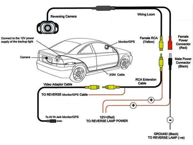

Steve Q Posted April 2, 2023 Posted April 2, 2023 Please see the attached image for the wiring diagram to fit an aftermarket reverse camera. 1
Gowardo Posted October 20, 2024 Posted October 20, 2024 (edited) Thank you, this is very useful. I am new to the forum so please forgive me if this post lacks etiquette, or if I am not posting in the right spot, but I have a couple of questions... Firstly, does the diagram you posted apply to all Audi models? I have a 2017 model Q5. Secondly... does "aftermarket" refer to audi genuine camera and wiring, but installed privately, or to any completely aftermarket cameras? Lastly, do you have any sense of whether the camera can then be natively integrated into the existing display, or if there needs to be any re-coding done on a software level? Thank you in advance for any help you are able to provide. Edited October 20, 2024 by Gowardo
Steve Q Posted October 21, 2024 Author Posted October 21, 2024 Hi there, this is for non Audi ones. If you wanted the Audi one hooked up to the mmi then you'll need to get a company like Audi retrofits or autologics to help. Members have used them for retrofits and been happy with the results
