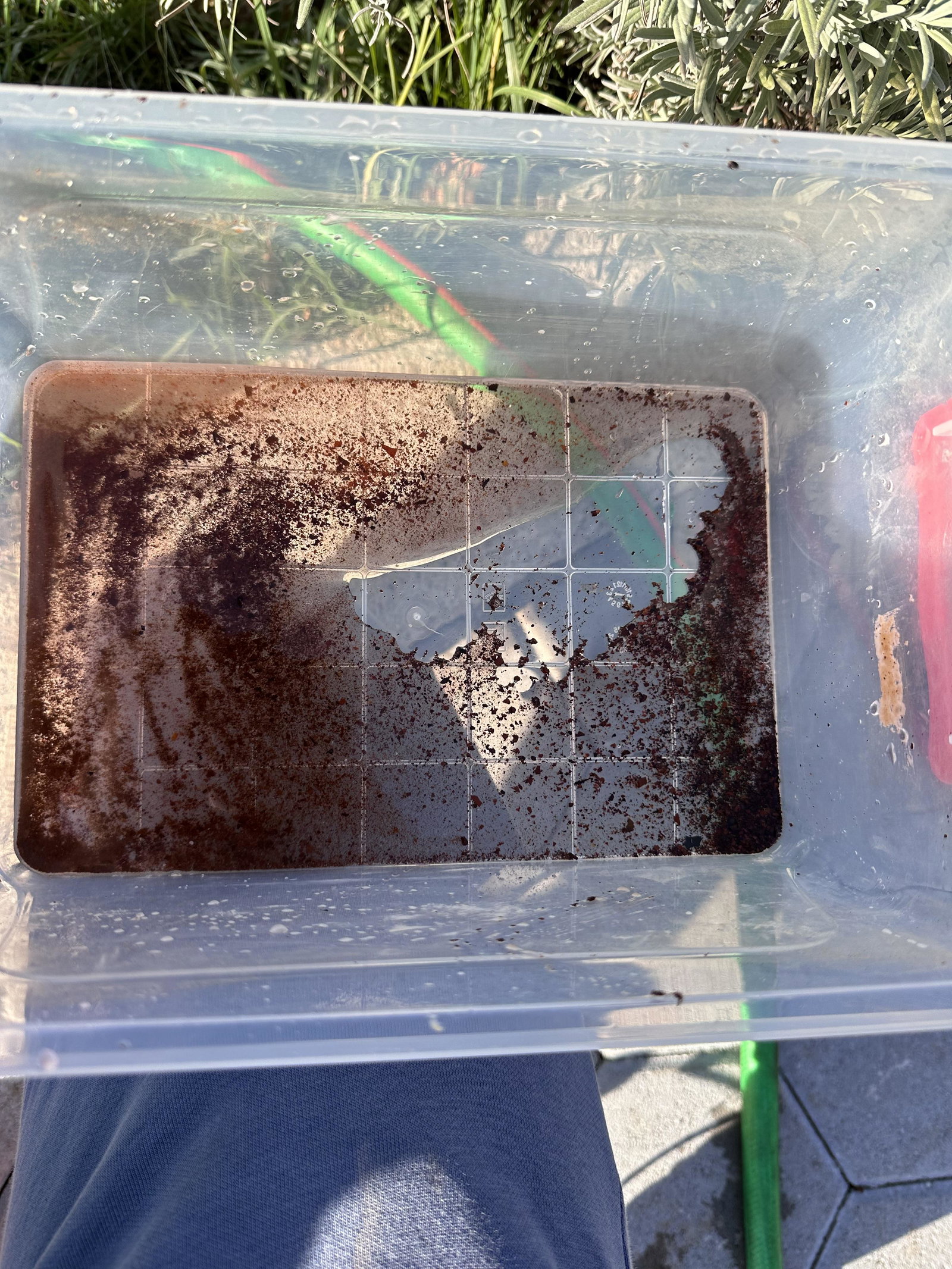

Solution Matrix44 Posted November 25, 2024 Solution Posted November 25, 2024 On 11/20/2024 at 8:16 PM, Stevey Y said: Hi yes but there is a lot more to remove to get to it, try flushing it on the inlet then in reverse on the outlet, you have to give it a couple of goes but that method cleared mine. Steve. Hi steve, i flushed the heater with water for about 10min, there a lot of dirt comming out the heater, you can see on picture, so after 10min it comming clear water from heater, and connect everything and thats fix the problem, now i have hot air on passenger side also, so that fixed the problem thanks a lot. 1
Stevey Y Posted November 25, 2024 Posted November 25, 2024 16 minutes ago, Matrix44 said: Hi steve, i flushed the heater with water for about 10min, there a lot of dirt comming out the heater, you can see on picture, so after 10min it comming clear water from heater, and connect everything and thats fix the problem, now i have hot air on passenger side also, so that fixed the problem thanks a lot. Hi, well done, a lot of that is accumulated rust and crud from the block, I would recommend a complete drain down of the system and a refill with good quality antifreeze to prevent it happening in the future. Steve. 1
Steve Q Posted November 25, 2024 Posted November 25, 2024 2 hours ago, Matrix44 said: Hi steve, i flushed the heater with water for about 10min, there a lot of dirt comming out the heater, you can see on picture, so after 10min it comming clear water from heater, and connect everything and thats fix the problem, now i have hot air on passenger side also, so that fixed the problem thanks a lot. Great work! 👍
cliffcoggin Posted November 25, 2024 Posted November 25, 2024 2 hours ago, Stevey Y said: Hi, well done, a lot of that is accumulated rust and crud from the block, I would recommend a complete drain down of the system and a refill with good quality antifreeze to prevent it happening in the future. Steve. I second that recommendation. Decent antifreeze has corrosion inhibitors to prevent that sort of corrosion; the cheap stuff does not.
