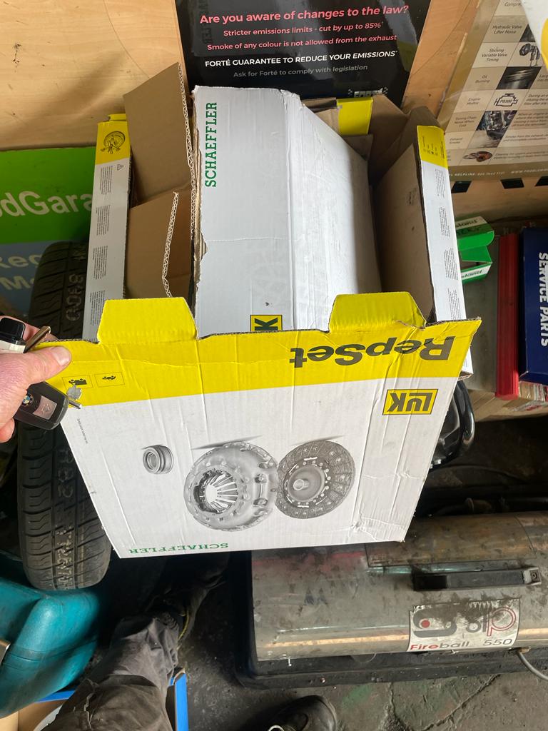

a6blacked007 Posted May 1, 2023 Share Posted May 1, 2023 Just done mine clutch was fine but with all work involved everything was changed. £1100 in total 1 Quote Link to comment Share on other sites More sharing options...

a6blacked007 Posted May 1, 2023 Share Posted May 1, 2023 Parts all in £750 luk Labour mammoth job £350 Flywheel Alone £500 .. The £350 Labour is a good price for the job you'll find some garages putting massive price in because don't want to do the job. my advice replace the lot 1 Quote Link to comment Share on other sites More sharing options...

a6blacked007 Posted May 1, 2023 Share Posted May 1, 2023 4 hours ago, fak said: So £250 for clutch kit? Does that include release bearing? And concentric slave cylinder? Was it from dealers? Depends what you buy. The flywheel and clutch come as complete unit just to bolt on if you but luk kit slave cylinder comes with it. Quote Link to comment Share on other sites More sharing options...
a6blacked007 Posted May 1, 2023 Share Posted May 1, 2023 Just now, a6blacked007 said: Depends what you buy. The flywheel and clutch come as complete unit just to bolt on if you but luk kit slave cylinder comes with it. You don't want miss match parts in there thats for sure it's not a regular clutch replacement very different sort of setup my mechanic told me. Quote Link to comment Share on other sites More sharing options...
Stevey Y Posted May 1, 2023 Share Posted May 1, 2023 5 hours ago, fak said: So £250 for clutch kit? Does that include release bearing? And concentric slave cylinder? Was it from dealers? Hi the slave and bearing are all one piece the slave is about £100 on eBay, genuine part, then you will need the seal that goes in the middle of it, Mark is right its nothing like any other car I have worked on as the driveshaft runs in the middle of the flywheel edge so when you remove the driveshaft you have to replace that seal as well and to remove the old seal you have to remove the diff housing as the seal is fitted inside that, yes its a monumental task I didn't do mine but the guy that did it is a friend and I was there for nine hours on cleaning and tea detail so I saw the whole process including when the clutch master cylinder wouldn't pressure up, if you buy these cars there are a good few items that aint cheap but shopping around gets it cheaper, like my mates MK2 Escort clutch £140 but for anything later those days are long gone. 2 Quote Link to comment Share on other sites More sharing options...
