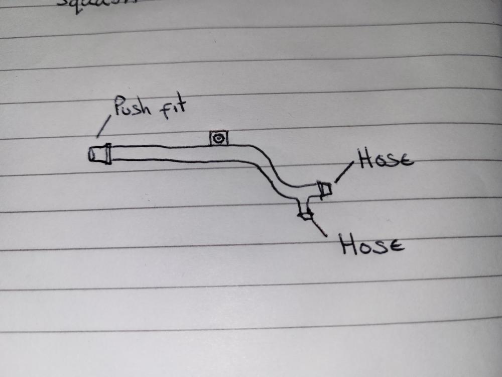

Robbie56 Posted May 6, 2023 Share Posted May 6, 2023 Hi peeps So I have a nasty coolant leak on a piece of the steel coolant line. I've searched endlessly for this part with no joy. It runs down the side of the engine behind the oil filter casing (passenger side) and what looks like a push fit into the engine. Also attached with a bolt behind oil filter casing which Is impossible to get to. Any help appreciated 馃檹聽 Quote Link to comment Share on other sites More sharing options...

Robbie56 Posted May 6, 2023 Author Share Posted May 6, 2023 No I'd already seen this one...but thanks for looking 馃憤馃徎 Will do a crude sketch of it... Quote Link to comment Share on other sites More sharing options...

Magnet Posted May 6, 2023 Share Posted May 6, 2023 Hello Robbie,聽 Probably a daft question and a daft price, but not available at Audi?聽 Have you tried eBay Continental-wide.聽 Last resort maybe to have yours suitably weld repaired.聽 Kind regards, Gareth.聽 Quote Link to comment Share on other sites More sharing options...
Steve Q Posted May 6, 2023 Share Posted May 6, 2023 4 hours ago, Robbie56 said: What engine has your car got?聽 Quote Link to comment Share on other sites More sharing options...
Robbie56 Posted May 8, 2023 Author Share Posted May 8, 2023 (edited) Found it, eBay....here's the part number if anyone else has the same problem. 03G121065R....just need to get the !Removed! thing off now!! Lol Thanks to all who took time to help 馃憤馃徎 Edited May 8, 2023 by Robbie56 Wrong part number Quote Link to comment Share on other sites More sharing options...
