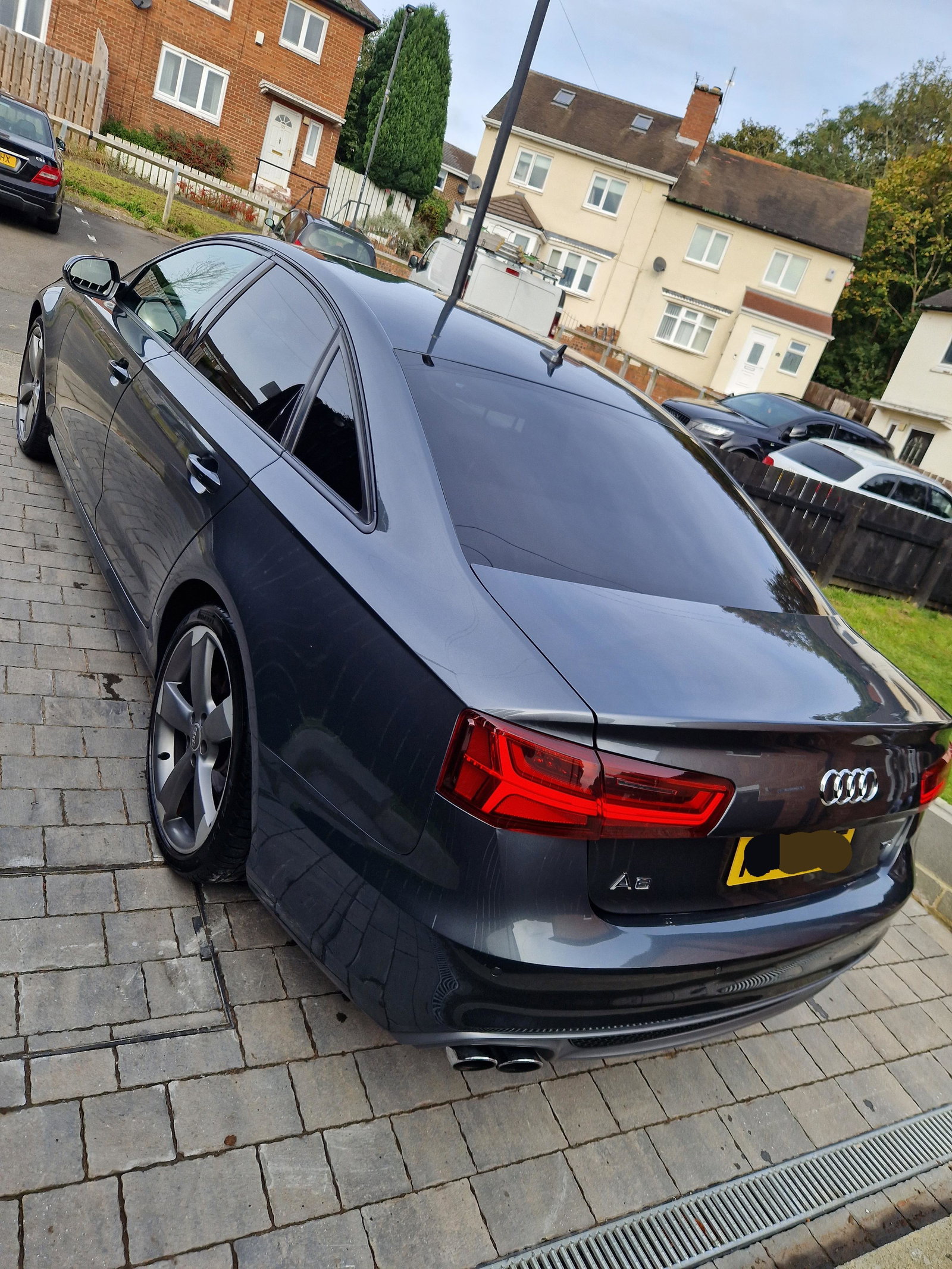

a6blacked007 Posted December 22, 2023 Author Posted December 22, 2023 28 minutes ago, mesza said: Added these rimblades Your a6 looks identical to mine
mesza Posted December 22, 2023 Posted December 22, 2023 Had it about 6 weeks, added the rimblades, and some interior stuff and had a stage 1 remap. Very happy with it. Got any pics of yours?
mesza Posted December 22, 2023 Posted December 22, 2023 Also added red air vent strips and a red led dash light strip
a6blacked007 Posted December 22, 2023 Author Posted December 22, 2023 2 hours ago, mesza said: Had it about 6 weeks, added the rimblades, and some interior stuff and had a stage 1 remap. Very happy with it. Got any pics of yours? 1
