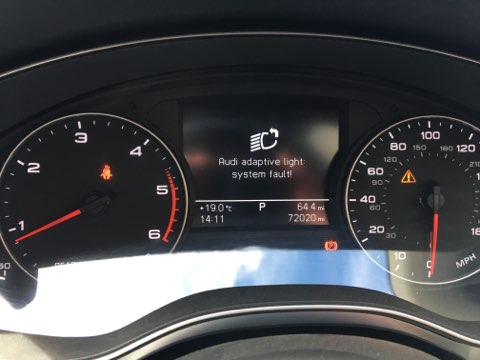

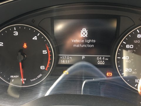

just had a new led headlight fitted and garage have sent me pics of the faults after coding and calibration they are now at a loss as what to do next any advice please they are fitting a new ride height sensor but they dont think it will solve the problem thanks
Did they run a scan what fault codes come up ....
Is it a regular garage or audi specialist ..
will ask them to do scan today car is in bodyshop following accident but think it may have to go to audi
Now the garage are telling me the car is throwing up headlight cooling fan fault after replacing led headlight can anyone shed some light on this as I am losing faith in their ability to repair car

Hi the LED units are hell and have to go through rigorous tests by the light control module to be accepted as there is no real manual adjustment its all fly by wire, thats why they cost three times as much new, only other question is the unit O.E. Genuine if not the only way is get a can bus bridge cable which fools the light module into thinking its the original unit.
Hi Steve yes the unit is genuine Audi I have seen the part numbers and cost they have also replaced high beam and low beam modules and it still keeps throwing up error codes
Hi much as I loath to say this it sounds like a dealer/IDOS job as this system runs a diagnostic and then tells the idiot running it how to step by step repair it, all part of the new A.I. strategy, I am assuming you won't be paying for the trip to Audi.
