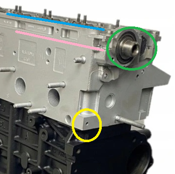

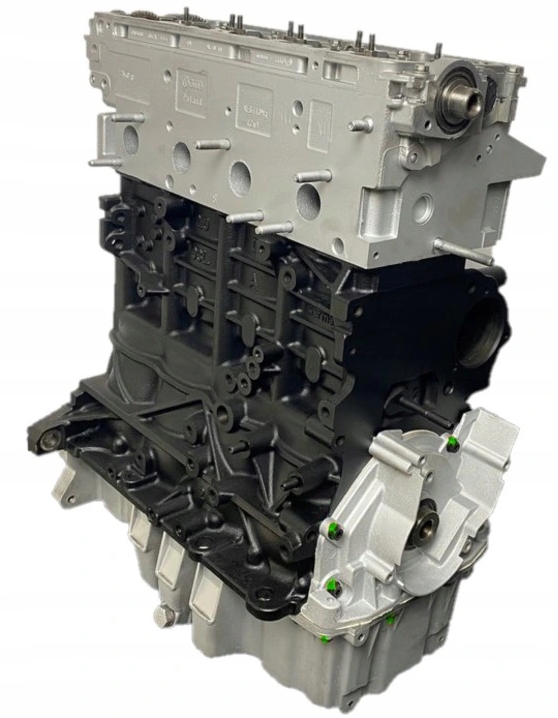

Image 1 is an Image from the Web of a Reconditioned CBAB engine for reference to help show where my images relate to.
IMAGE 1

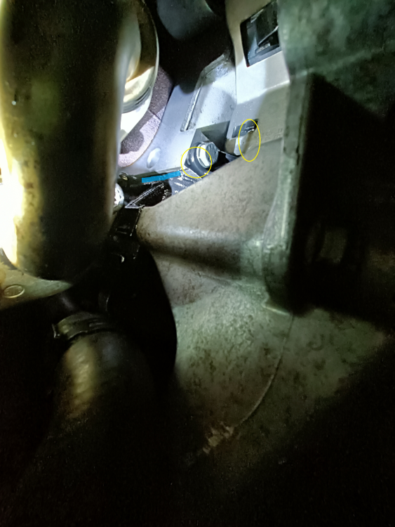

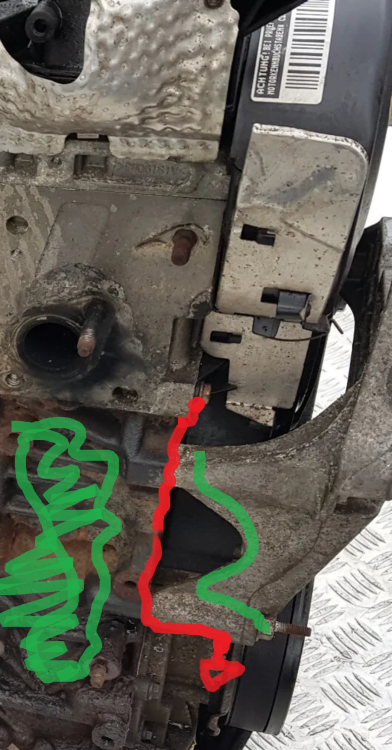

At first sight, I spotted the oil dripping from the lower bracket of the engine mount, and traced this up the engine. Image 2 shows in RED where the oil is coming from, and Green where there is no trace of oil. (This is an image of a used engine from ebay)

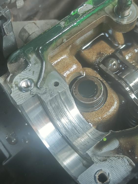

IMAGE 2

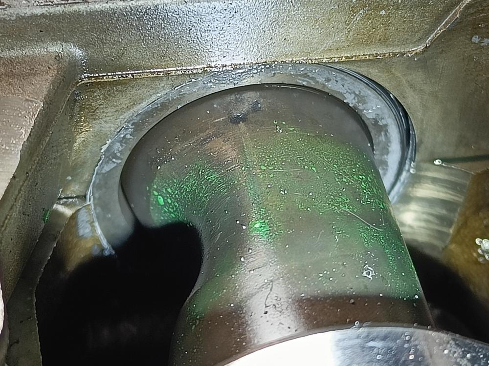

Image 3 shows the Oil leak as high as I can see where it starts to Pool, and drip/run down the block. Yellow Circles show where the Oil appears to be coming from. The Blue line is where oil is sitting along the Head gasket, but I believe that this is where it's running down to, as the source of the oil is pooling on the Rear Cambelt Cover Bolt.
Image 4 is the same as Image 1, but cropped.  Yellow circle shows where I'm seeing the oil "Pooling" around the rear cam cover bolt.
The only places that I can think that the oil COULD be coming from is:
Camshaft Oil seal or Front Cam Blanking Plug (GREEN) - However I'd have thought I'd see oil flicking around the cambelt or on the cam sprocket, which I don't
Camshaft Carrier to Head (PINK) - This is a Sealing surface that clamps the CAMS into the head.. There doesn't appear to be oil running down from here, but hard to tell as the oil "trail" seems to disappear above the bolt.
Rocker(Cam) cover gasket (BLUE) - I have had the Rocker cover off, cleaned the sealing surface and replaced the rocket cover gasket - no joy whatsoever. The Rocker cover is currently OFF again so I could check again!

Well.. I appear to have found the cause of the leak.
Camshaft oil seal... Until I looked deeper..

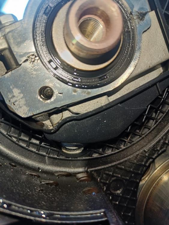

Took off the Cambelt and Camshaft sprocket -To see a nice oily drip from the Camshaft seal. Image below:
I looked on the inside after spotting this, and noticed that the where the exhaust cam exits the Head, there looked to be excessive rubbing/wear on one side and a gap on the other (the green is UV dye from when I was tracing).. Image below:

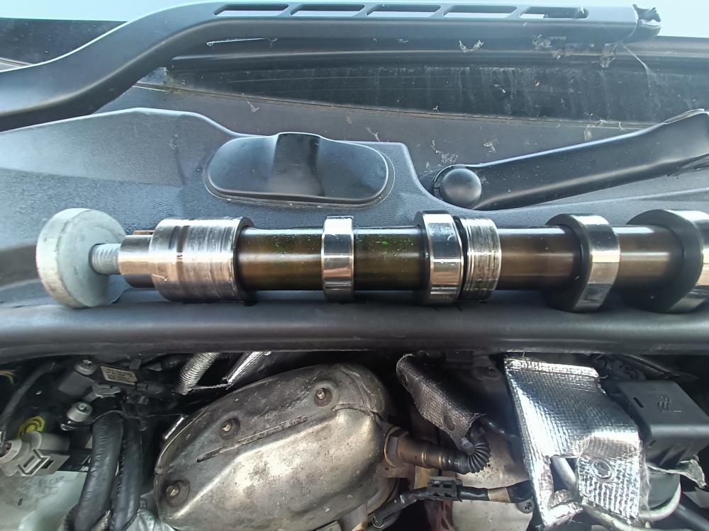

So I decided to take the Camshaft retaining frame off to have a better look and ohhhh dear... See images:
Interestingly, There aren't Bushes/Bearing shells to replace as i'd have thought there would be... The Cams just run directly in the seats of the Head & Cam carrier... Is this even fixable?

Hi Al that is a disaster in so much as the oil pressure issues have done for the head the cam seal is leaking from the movement in the camshaft, all that scoring is from intermittent loss of oil pressure which has caused the two components to meet and rub on each other causing the scoring, there are no bearings as most modern engines run interference fit bearings and rely on a oil pressure wedge to keep the cam and bearing surfaces apart, either way you will need a new cylinder head/camshaft and depending on the milage one would have to consider the expense of that in view of the fact that the big end bearings are probably the same.
