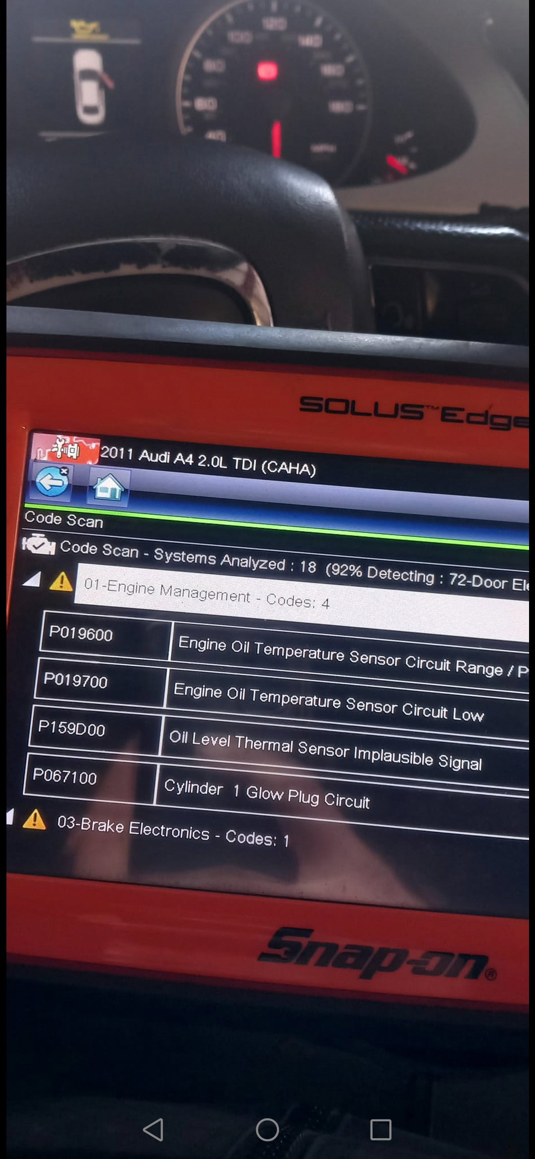

Michael Daly Posted June 6, 2023 Share Posted June 6, 2023 Hi all, New to this group, I bought an a4 170bhp with oil leveling sensor fault, bought oil leveling sensor and still on, bought hood lock and still on. Mechanic said he has checked wiring and can't see anything wrong, where do I go from here, Thanks Quote Link to comment Share on other sites More sharing options...
coupe4 Posted June 6, 2023 Share Posted June 6, 2023 when you say its on. what fault is showing? Quote Link to comment Share on other sites More sharing options...
Michael Daly Posted June 6, 2023 Author Share Posted June 6, 2023 Attaching picture thanks Quote Link to comment Share on other sites More sharing options...
Stevey Y Posted June 6, 2023 Share Posted June 6, 2023 22 minutes ago, Michael Daly said: Attaching picture thanks Hi these things are a piece of rubbish, if you change the oil as I have after driving the thing still says its low despite having the right amount of oil, if I drive another three cycles so its then nice and hot if I wait five mins and then check it comes right, try deleting the codes and then run it as suggested, its all down to the bonnet counter, worst case scenario yo might need to find someone with VCDS to re adapt the sensor. Steve. Quote Link to comment Share on other sites More sharing options...
