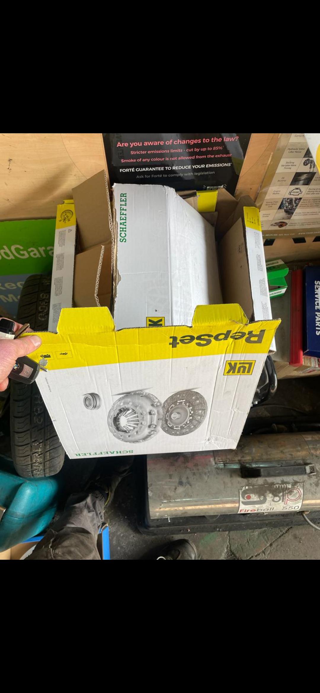

a6blacked007 Posted July 12, 2023 Posted July 12, 2023 I got luk kit on mine 1000 miles ago £750 with release bearing fitting £350 all in £1100 apparently nightmare to fit. 1
DarrenJC Posted July 12, 2023 Author Posted July 12, 2023 Did the LUK kit for £750 include the dual mass Flywheel and if so, can you remember where you got it?
a6blacked007 Posted July 12, 2023 Posted July 12, 2023 On 7/12/2023 at 6:29 PM, DarrenJC said: Did the LUK kit for £750 include the dual mass Flywheel and if so, can you remember where you got it? Expand Yeah that was everything Its 1 full unit buddy can't buy it separately apparently clutch was ok it was dmf knackered knocking badly when a was slowing down. Also judder when pulling away. Garage got luk kit not sure where from. 1
DarrenJC Posted July 12, 2023 Author Posted July 12, 2023 On 7/12/2023 at 6:41 PM, a6blacked007 said: Yeah that was everything Its 1 full unit buddy can't buy it separately apparently clutch was ok it was dmf knackered knocking badly when a was slowing down. Also judder when pulling away. Garage got luk kit not sure where from. Expand Happy days! At least now I know it comes as one full kit and price wise it sounds a lot better than buying separately. Good man 👍 1
