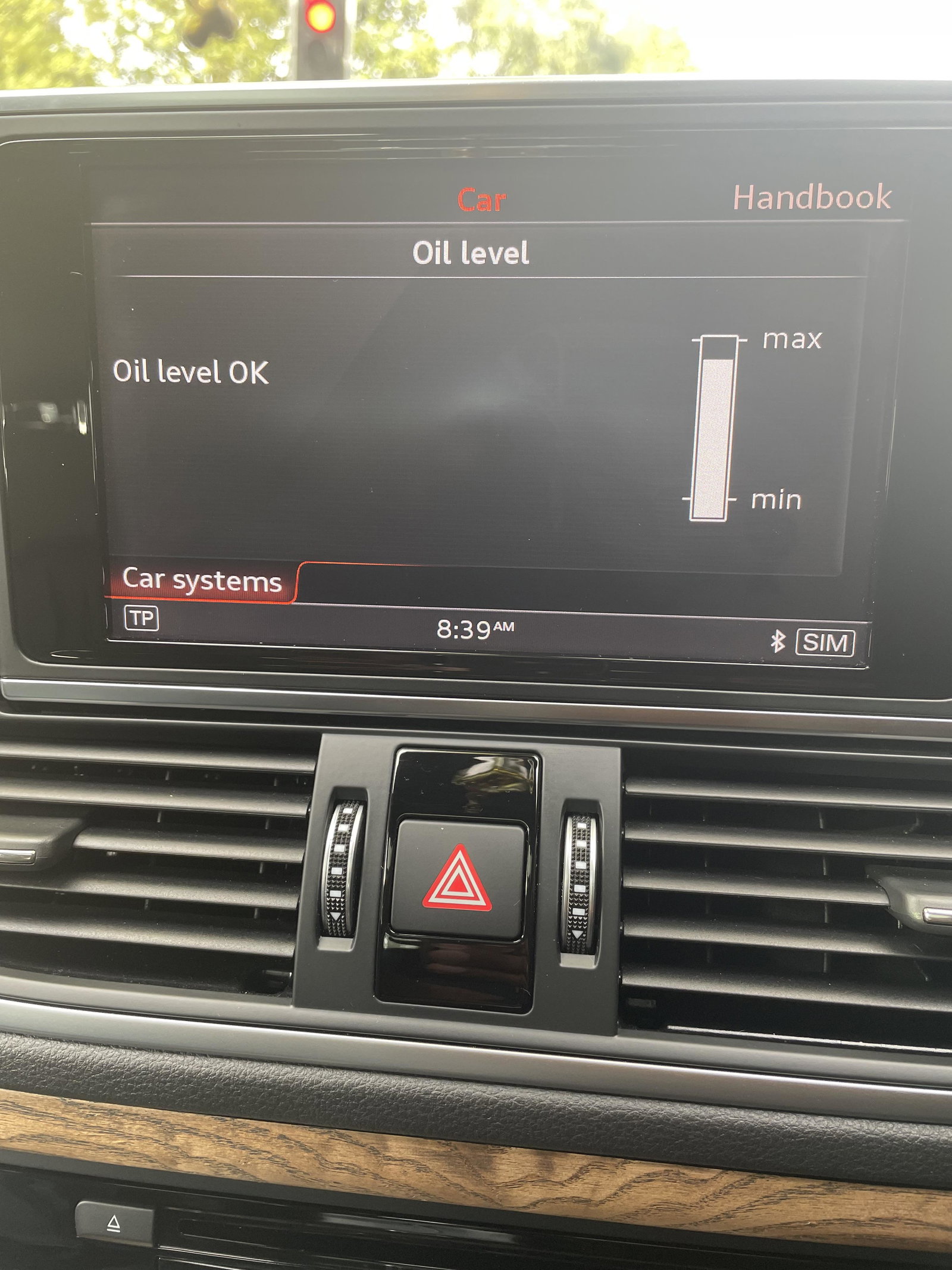

Gary Bayley Posted July 31, 2023 Posted July 31, 2023 So I had the car serviced at an Audi dealership last week and randomly flicked through the car settings a couple of days later and noticed the oil level was about a quarter of the way from maximum. I questioned the dealership who assured me that this is absolutely fine and normal. I'm no expert but surely this isn't right? Your thoughts on this would be appreciated before I take this further.
NJP10 Posted July 31, 2023 Posted July 31, 2023 Hi, that doesn’t look right to me, it should be to the max line especially if you’ve had it serviced. just check mine and this is after 7000 miles it’s showed this today. 1
Magnet Posted August 2, 2023 Posted August 2, 2023 How strange Stephen, I’ve always (manually) checked oil levels when cold, and all the circulated oil has had sufficient time to return into the sump. My routine has been before start up after being stationary overnight. I now have this new fangled! no dipstick in a non Audi, and understandably the display will not work until the engine is cold. Why on earth should Audi suggest it check it when warm? - when some oil is still retained in the block and moving parts. Logic suggests that since it is true , then a lower than desired cold reading will be even lower if checked when warm. If this were mine, I would be taking taking the car to another Audi dealer, armed with the photo. Kind regards, Gareth. 1
alpha omega Posted August 2, 2023 Posted August 2, 2023 lol thats my logic too gareth check oil when cool....but funny enough the car wont let me have a reading unless under certain circumstances 1
Gary Bayley Posted August 2, 2023 Author Posted August 2, 2023 This was their response to me questioning it. It still doesn’t sit right with me but I’m no expert. I think I’ll do the old fashioned dipstick check in the morning.
Steve Q Posted August 3, 2023 Posted August 3, 2023 Hadn't realise you had a dipstick too. If you have a dipstick then that is the best way of doing it.
alpha omega Posted August 3, 2023 Posted August 3, 2023 lol i never realised either steve keep us updated gary
Guest Posted August 3, 2023 Posted August 3, 2023 (edited) I was worried about my oil level on the digital gauge too, as mine got to the minimum. Bought 1L of oil, and used 500ml which brought it all the way to MAX! So it seems it's not a huge amount, just a prompt to top up a touch. Just had my oil changed and the digital gauge was 3/4, I'd rather have slightly less than too much oil. EDIT: I should add I did provide my own oil Castrol EDGE 2x4L, and there was some left over so it definitely, took around 7-7.5L Edited August 3, 2023 by Tommym92
Mick B Posted August 3, 2023 Posted August 3, 2023 In my opinion , If the correct amount of oil is added at service change,the gauge will not show full so this is normal and nothing to be concerned about. My last two oil changes from different garages,one a main dealer was the same.
Gary Bayley Posted August 4, 2023 Author Posted August 4, 2023 So I’ve been out and popped the bonnet……there is no dipstick other than the one stood looking at the engine. The consensus seems that the gauge reading is accurate. 1
