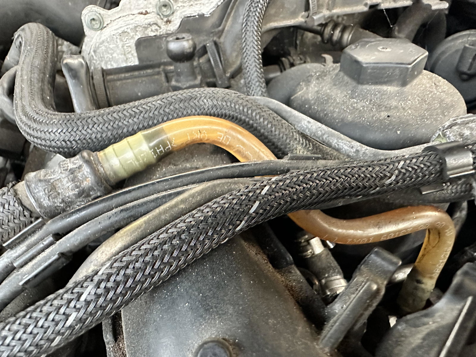

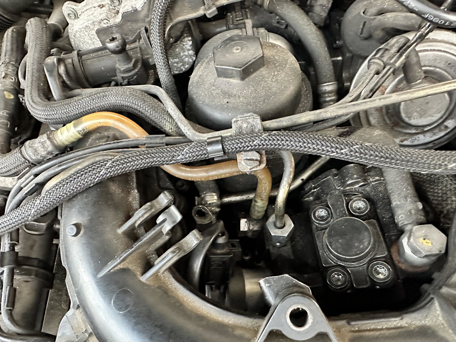

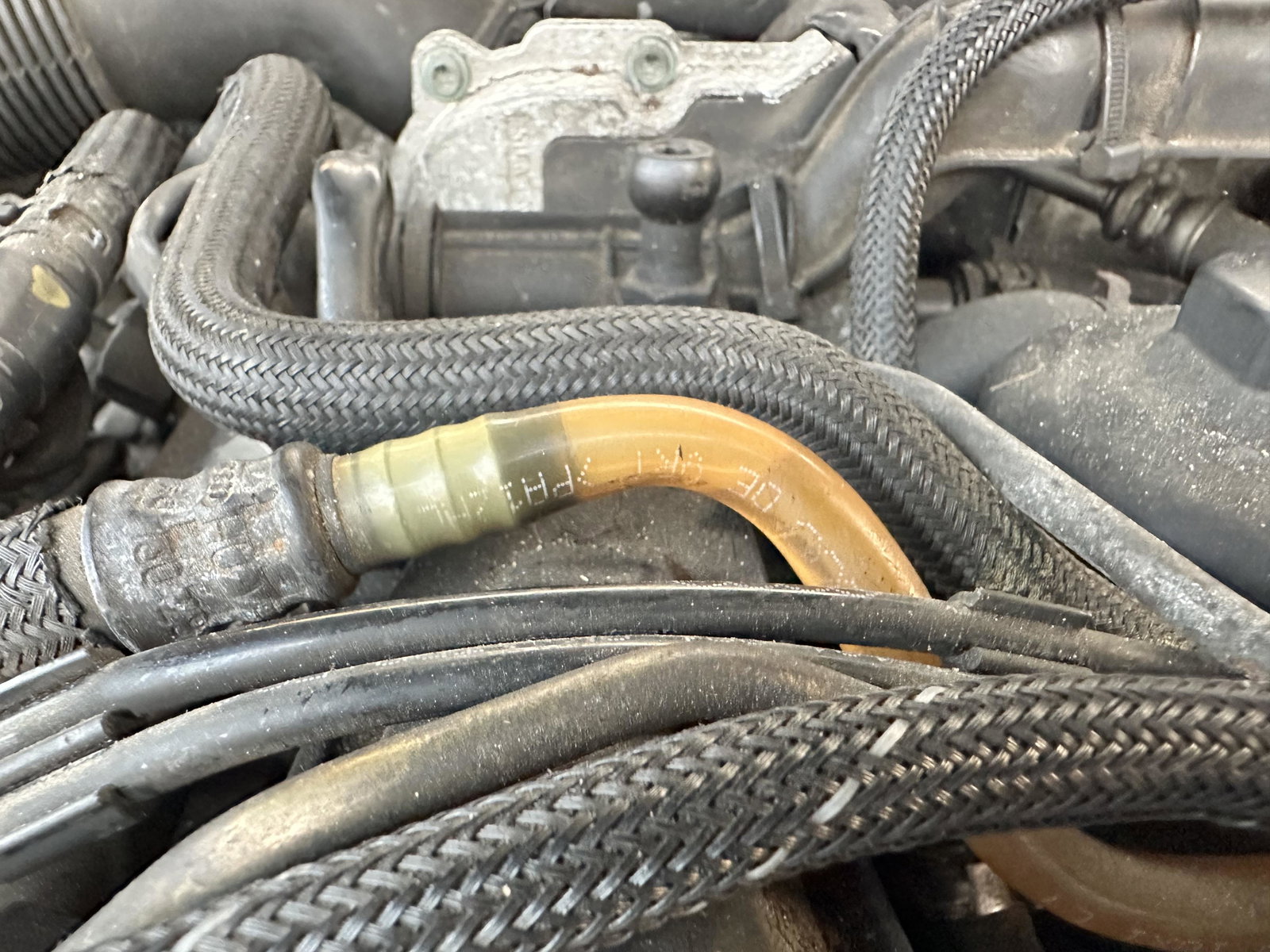

Should there be an air bubble in the top of this clear pipe? It goes to the HPFP I think… but when I try and start the car the air bubble moves but the pipe doesn’t fill with fuel as I would expect it too…

Hi I think you will find thats the return to the tank looking at the middle picture I would say the infeed is the large banjo bolt to the right of the the pump, if you can't see the fuel moving through the return pipe that would suggest the lift pump, you will always see air bubbles in the clear pipe as thats the HPFP self bleeding and if the HPFP was getting fuel the bubble would move when cranking.
