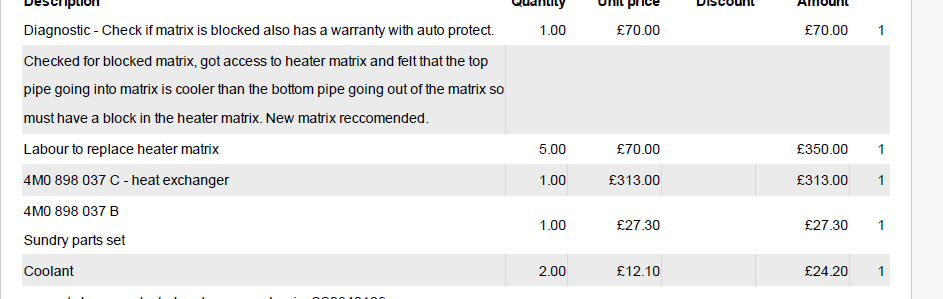

Vytas Posted December 11, 2024 Posted December 11, 2024 16 hours ago, ian.f said: So I’ve just spoken to the garage. They’re not able to find anything specifically wrong. They advised that it’s probably a stuck thermostat, or the heater core. So I think I’m going to have a go at doing the heater core, as that’s where the majority of the issues seem to get resolved. Does anyone have the part number for the core please? I’d like to check before I buy a replacement and strip it all down! Thanks Here`s what the garage quoted me with part numbers.
Magnet Posted December 11, 2024 Posted December 11, 2024 Thanks, Could you confirm that the coolant temperature gauge reaches 90 within about 3 miles, and holds that reading for the rest of the journey? Sorry to point this out, but I guess the above quote will be plus VAT?? Kind regards, Gareth.
ian.f Posted December 11, 2024 Posted December 11, 2024 1 hour ago, Vytas said: Here`s what the garage quoted me with part numbers. Thanks, that matches my part number also. 22 minutes ago, Magnet said: Thanks, Could you confirm that the coolant temperature gauge reaches 90 within about 3 miles, and holds that reading for the rest of the journey? Sorry to point this out, but I guess the above quote will be plus VAT?? Kind regards, Gareth. From my side, yes. I hit 90 pretty quickly…dependant on ambient temps. Stays at 90 constantly. When I did a core flush 6mnths ago, all the pipes were hot enough to the touch as well.
Vytas Posted December 11, 2024 Posted December 11, 2024 4 hours ago, Magnet said: Thanks, Could you confirm that the coolant temperature gauge reaches 90 within about 3 miles, and holds that reading for the rest of the journey? Sorry to point this out, but I guess the above quote will be plus VAT?? Kind regards, Gareth. Hi Yes + VAT. The total was ~950 including the diagnostic 84£ charge.

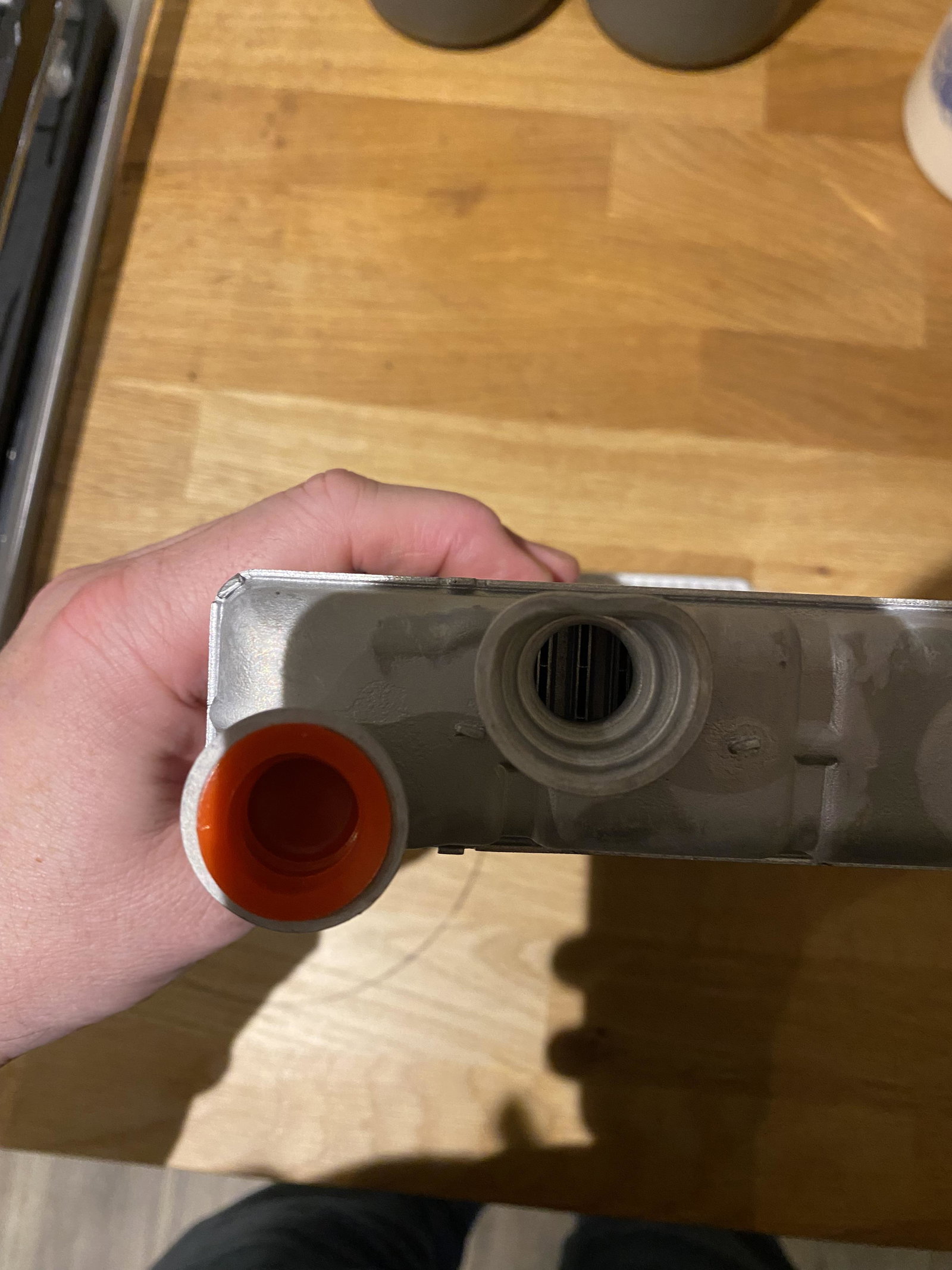

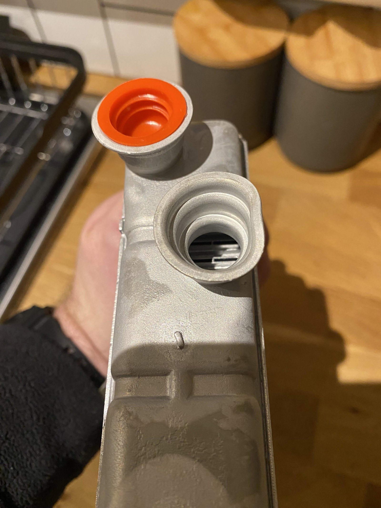

ian.f Posted January 19 Posted January 19 evening all, so I stripped mine down this weekend ready to install my new one…which was broken again 🤦♂️ putting it back together whilst I source another, I cannot for the life of me relocate the pipes in to the core. No amount of pushing will compress the washer enough that I can get the clips on. did anyone else struggle with this? Any tips greatly appreciated!!
Sid2020 Posted January 19 Posted January 19 Little bit of grease on the O rings helps, might be a locator on it to get the rotation correct
Sid2020 Posted January 19 Posted January 19 Locator will be on the connector body if it has one, not inside near the O rings helps
ian.f Posted January 19 Posted January 19 52 minutes ago, Sid2020 said: Little bit of grease on the O rings helps, might be a locator on it to get the rotation correct Hmmm good shout. So a bit of grease round the mouth on the core, then the o ring should slip in easier? I can’t see any specific connection/connector/locator, but will check tomorrow. if I take the o ring out, the pipe sits in flush to the core and I can fit the connector…but it leaks badly…obviously!
ian.f Posted January 28 Posted January 28 Ok, so finally I’ve fitted the new core. The old one was completely blocked. When blowing in to one side, nothing out of the other side. I rinsed it a few times and flushed it. Little blobs of some pink stuff came out. I’m guessing that’s the burst silica bag. With the new core in, the heat is much better, but it’s still not a patch on my wife’s gla. I guess it’s just not a hot motor! I bought two cores from AutoDoc, in case one was damaged like my first attempt. Means I have a spare. Listed here if anyone’s interested https://www.ebay.co.uk/itm/186917272022?mkcid=16&mkevt=1&mkrid=711-127632-2357-0&ssspo=wxS-jJ-HRf6&sssrc=0&ssuid=wxS-jJ-HRf6&var=&widget_ver=artemis&media=COPY
