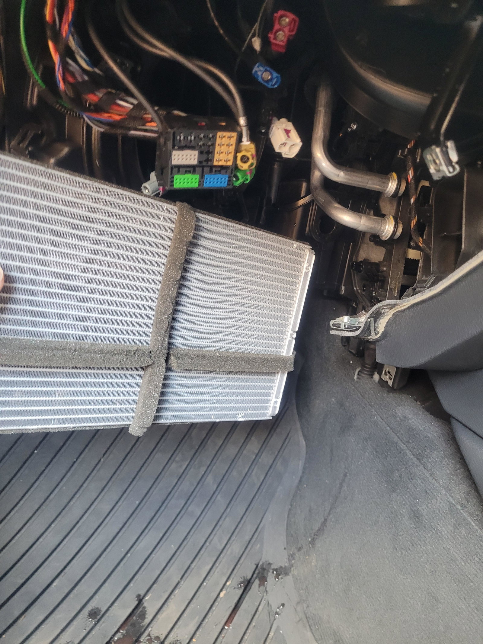

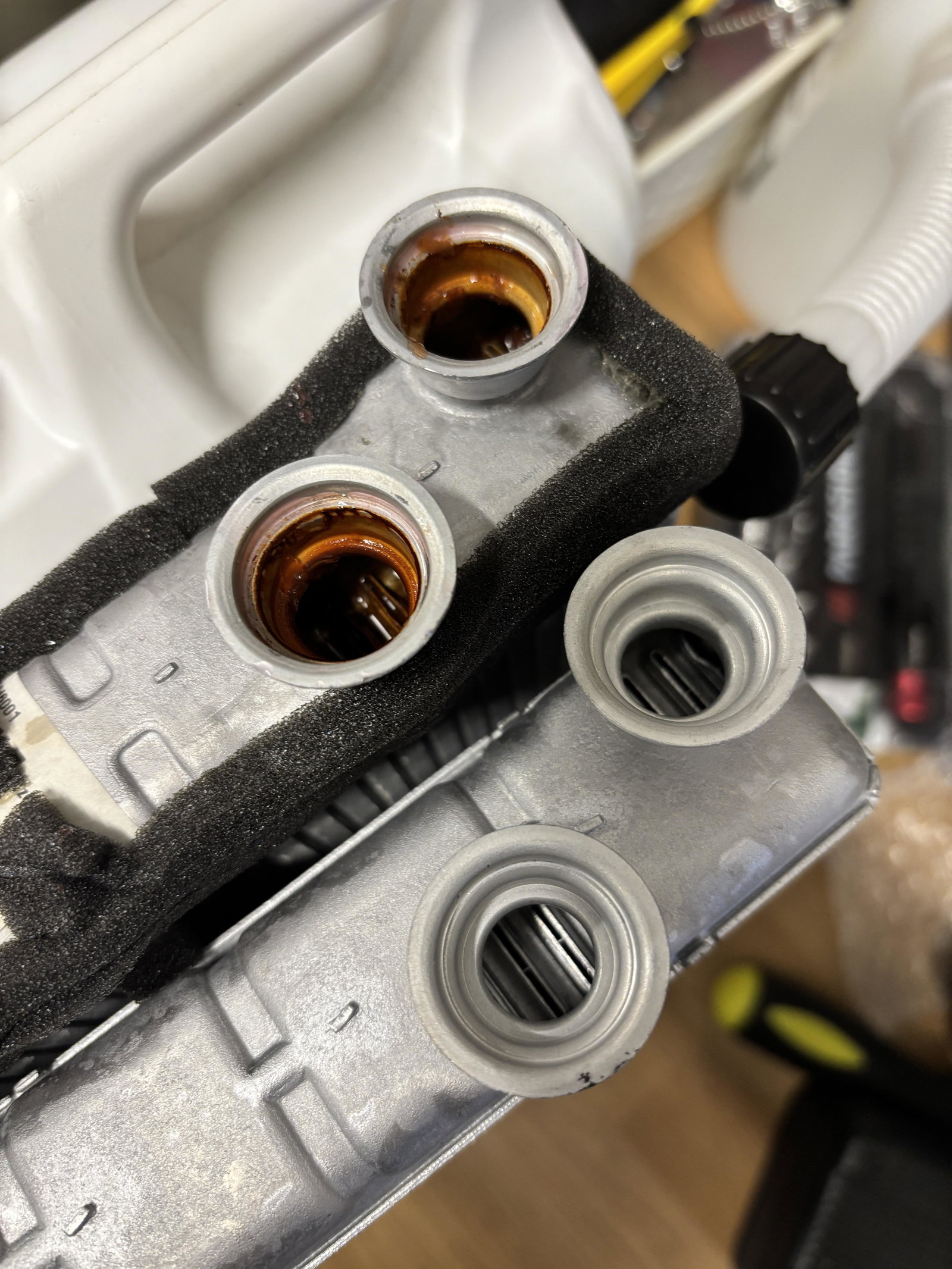

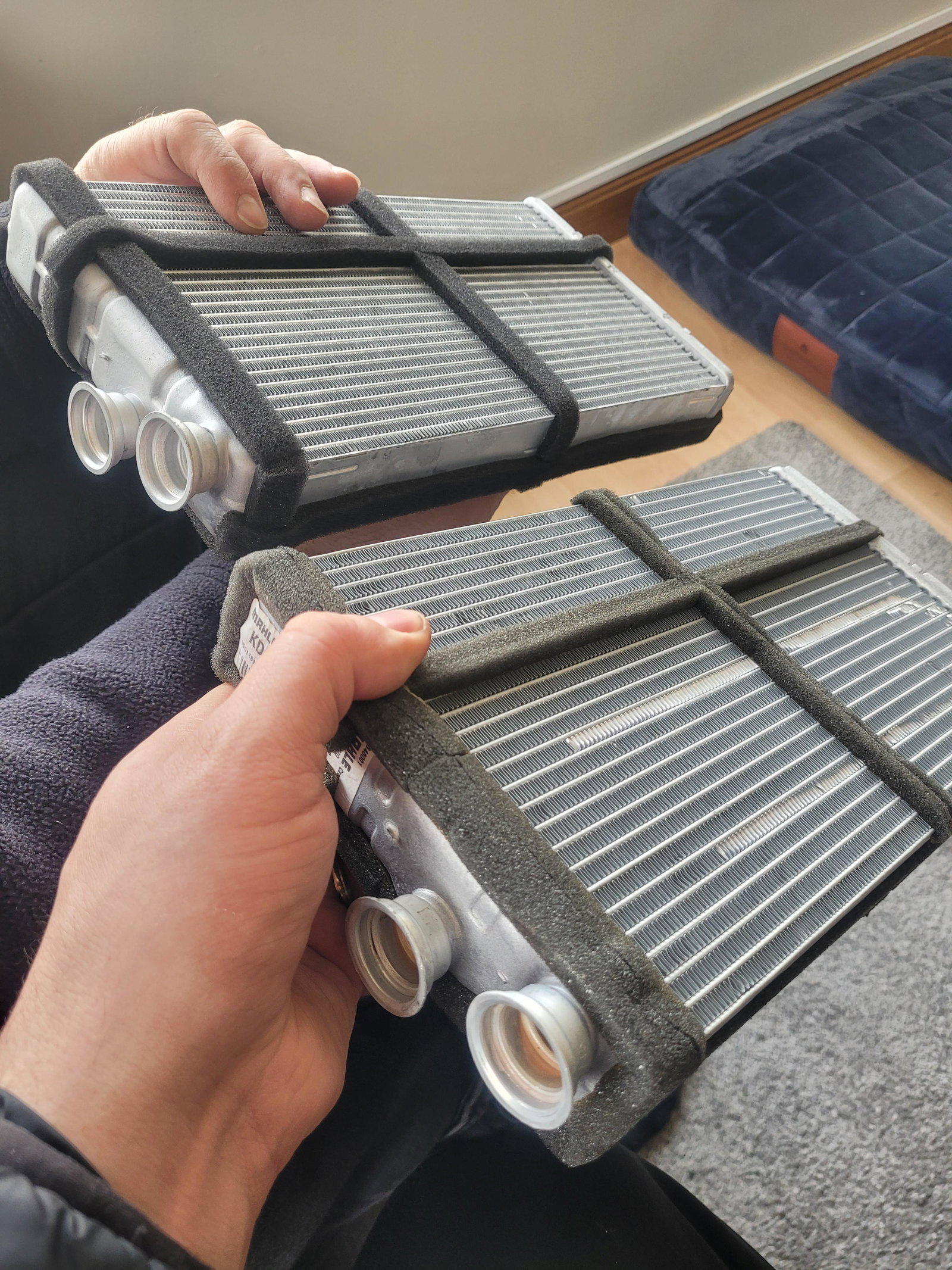

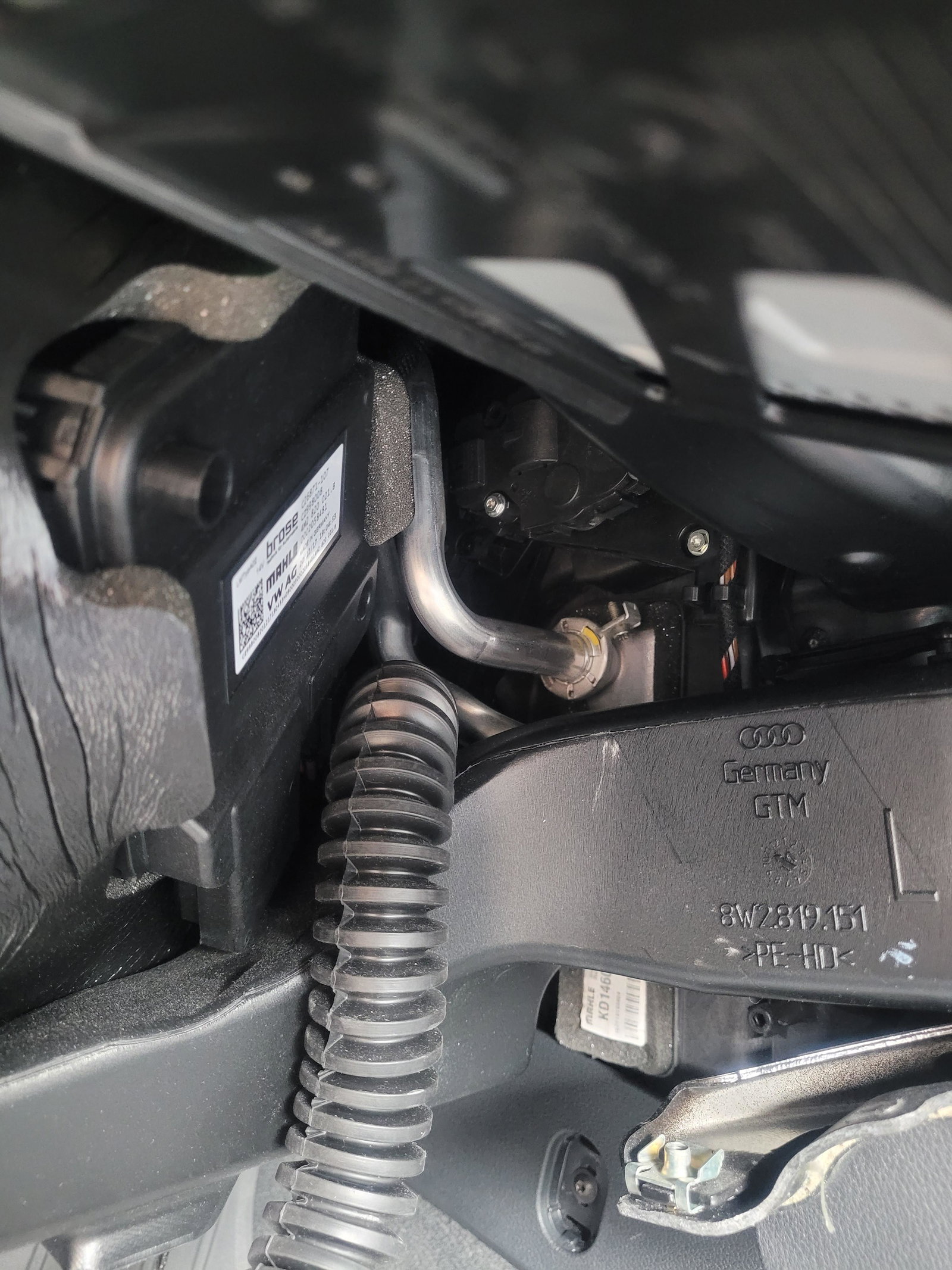

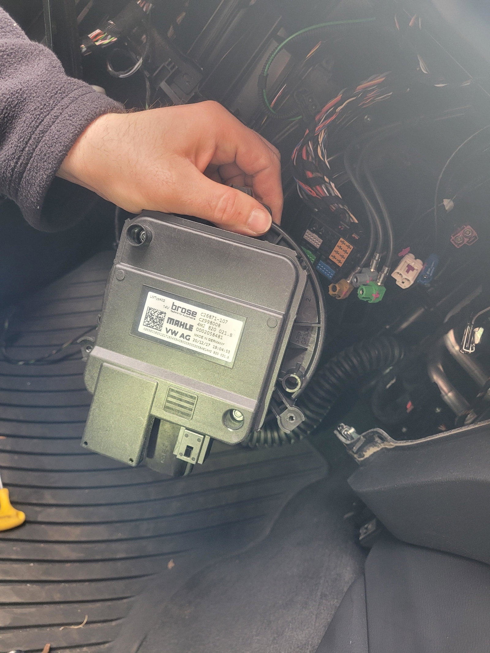

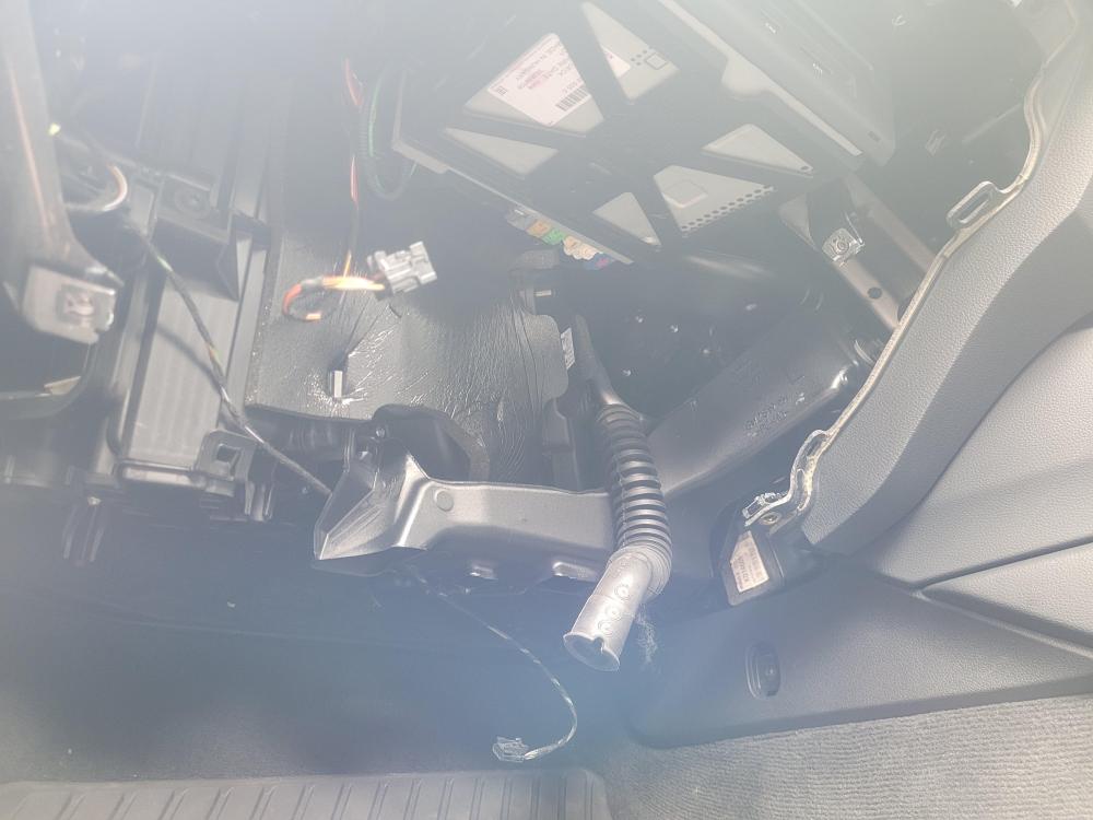

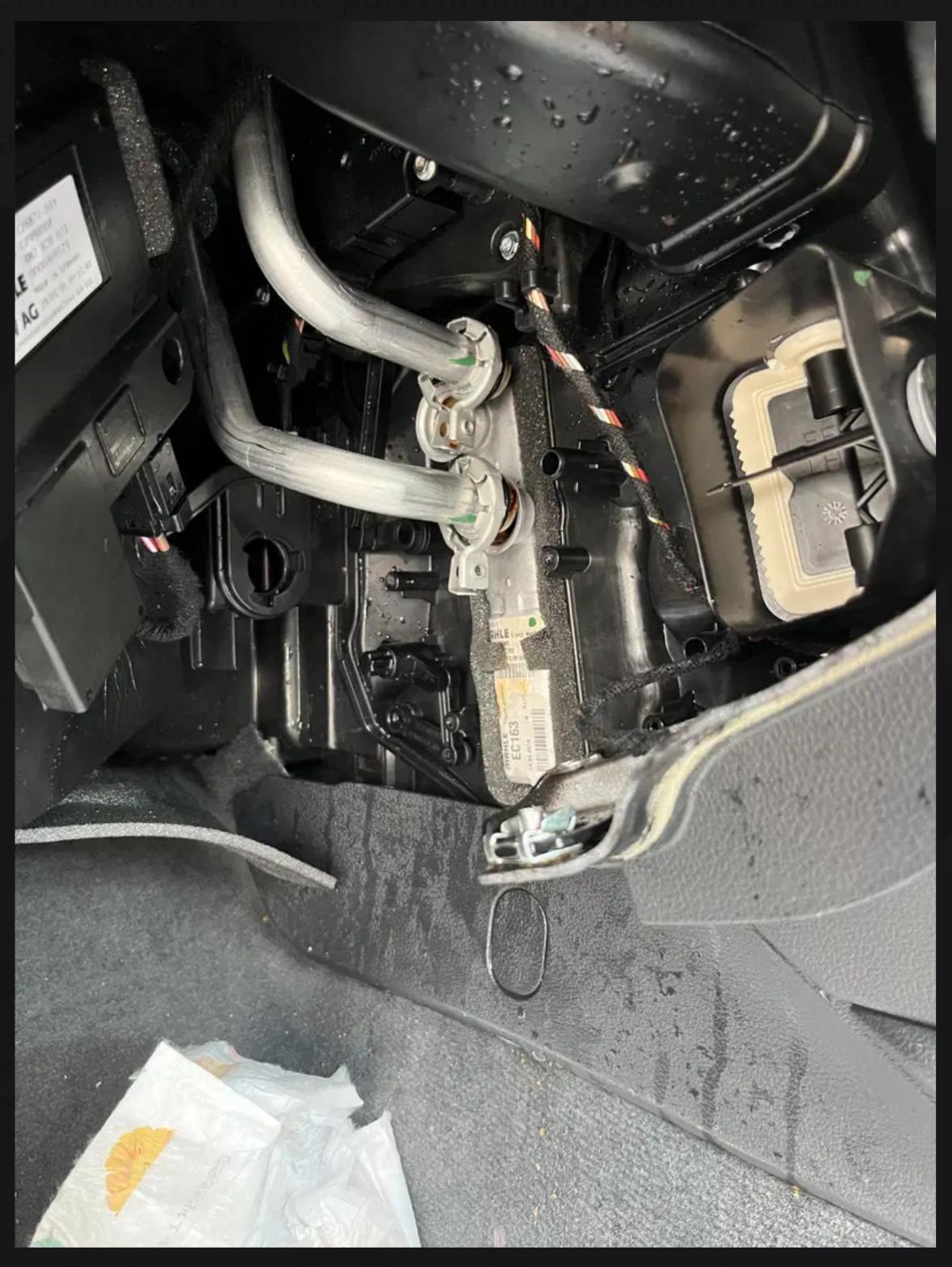

The one I bought only came with the foam to wrap round the core. I did buy the additional fitting kit which had new clamps and O rings, but taking the old one off and inspecting the old kit, it was in good working order, so I didn’t need the new kit.
The fitting kits can be bought on eBay, part number 4M0898037B
