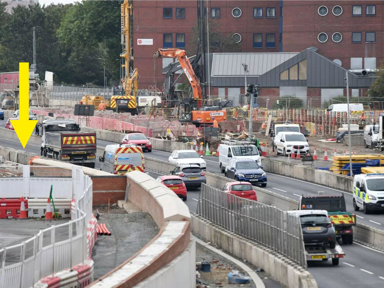

I broke down here in narrow lanes between concrete blocks running for hundreds of yards with no escape route.Breakdown.thumb.jpg.72ee2c84b7b0de4e853032f39369b71c.jpg
