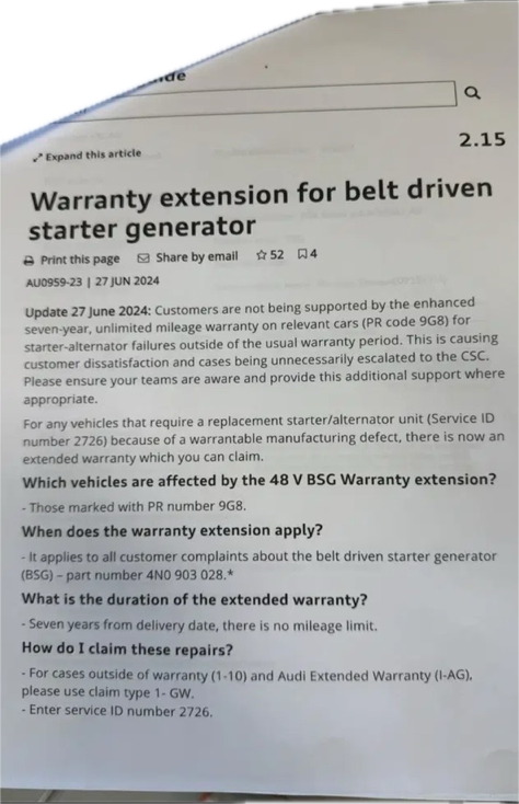

The note from Audi U.K. to all dealers about the 7 year extended warranty is in this thread. I attach again for convenience. You just need to make sure your car has the 9GB PR number (can usually be found on inside cover of owners manual).
I just contacted service department at deal and explained situation. They denied knowing anything but once I directed them to the note from Audi U.K. they found it on the system. Ofcourse they will tell you we don’t know if it’s this we need to investigate etc.
Them seeing this note will greatly help though as it alerts them they can claim the money back. I then  took it in they ran diagnostics found it was alternator and got approval from Audi U.K. to carry out free of charge.
No parts at the moment so a bit of a wait.
Ignore Audi U.K., they are of little help just get in touch with your preferred Audi dealer and make them aware of the attached.
Good luck!
Thanks so much, really appreciate that! Fingers crossed mine had the PR number required for it to be covered, I’ll check that today. Glad you managed to get it sorted. Out of curiosity, did Audi give you a courtesy car free of charge as it’s a manufacturer problem?
