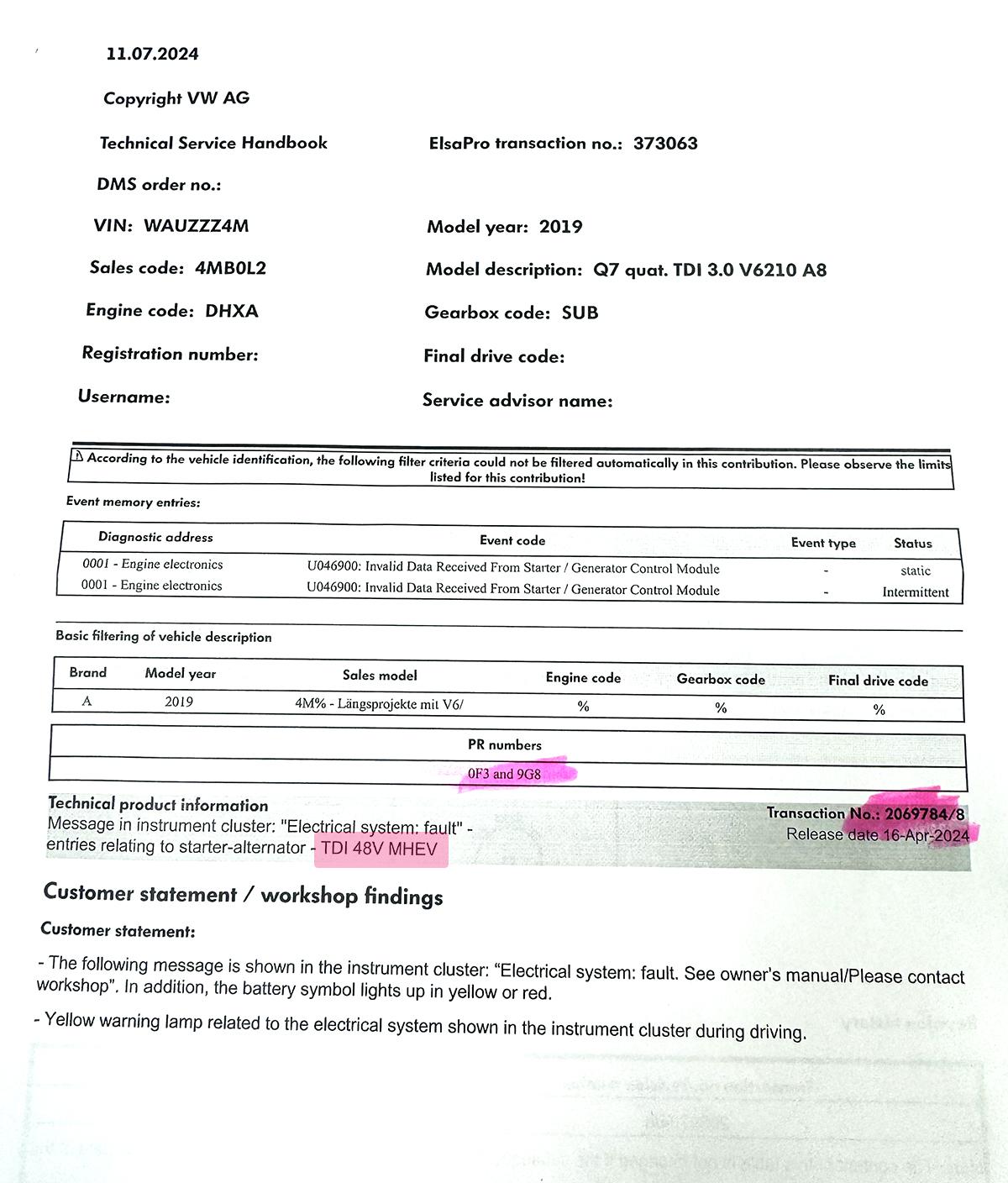

Email from my dealer to Audi UK
The 7 year Audi warranty extension refers to TPI number 2069784/8. This TPI isn’t applicable to the chassis number of (customer) vehicle. The TPI states the extension is applicable to TDI 48V MHEV. The customer was in procession of a bulletin but I’m unsure the detail of this as he hadn’t left this with us. I’ve asked my Service Advisor to reach out to obtain this.
We’ve applied for factory goodwill on request number 114307461 that returned a 0% contribution.
As the customer hasn’t an Audi extended warranty in place the cost at this stage would sit with the customer unless Audi UK are willing to contribute towards the repair. This is a new customer to (Town) Audi so I wouldn’t be in the position to contribute towards the repair.
I’m in agreement with the customer though to some degree, these starter generator issues are widely known and are multiple cases on such failure, I have 5 onsite at this current time. I’d question why both the customer and (Town) Audi should be expected to pay towards such a common placed issue. Happy to proceed under warranty should the decision to cover with a 100% contribution.
I've had a chat with the service manager today. I told him I'm in no hurry for the car back but I like the dealer to work with me  to get this claim through Audi UK out of principle. He advised there is different level in an event like this, where the dealer feels its also wrong for the dealer or customer to pay for such defect. So first stage is Audi UK customer service, second is then escalate the case and lastly direct contact with UK Audi CEO: Andrew Doyle. I've told the service manager to take every step if needed as I'm not the only person in UK with this issue and that Audi UK needs to take responsibility like Audi US.
I've attached a copy of what my dealer can find from a Q7 Diesel relating to the 7 Year Drivetrain Warranty. But there isnt a specific one for the RS6? If anyone have a TPI number specific to the RS6 that be awesome!

I don’t know if this is helpful to you but as to know the part number of your alternator. I was told by Audi the affected alternator part number which are covered under the 7yr warranty is..4N0 903 028. Don’t let them fob you off like Bristol did telling me they couldn’t give me that information. I politely told them under the freedom of information act they certainly could and they then gave it to you.

I picked up my spare alternator from Bath Audi yesterday and it’s part number is 4N1-903-028-B interesting thst it is one digit different. Makes me wonder if this has been upgraded ?
Thanks @Mark2 For your reply. That come in good use. Can I ask which dealer finally wont the battle with Audi UK for you? I see your location is up the road from me. Was there any specific details of the process that helped with getting the claim Authorized with Audi UK? My car is  in the same situation. Its 3 Months out of its original 3 year M/W.
Hi @Steph1234 thats good information. I was told originally by Audi Cheltenham that my alternator part number was not covered, which I asked why, and that doesnt make any sense. Next day they simply told me there is not a 7 year drivetrain warranty on the Audi A6 and only on the Q7 (Attached above).
So the cars with the Audi 7 Year Drivetrain warranty covers alternator with part numbers 4N0 903 028 - Is this confirmed?
Lastly from @Mark2 the newest version of the alternator have part number: 4
N1-903-028-B
Looks like a newer version of the superceeded part number 4N0 903 028.
