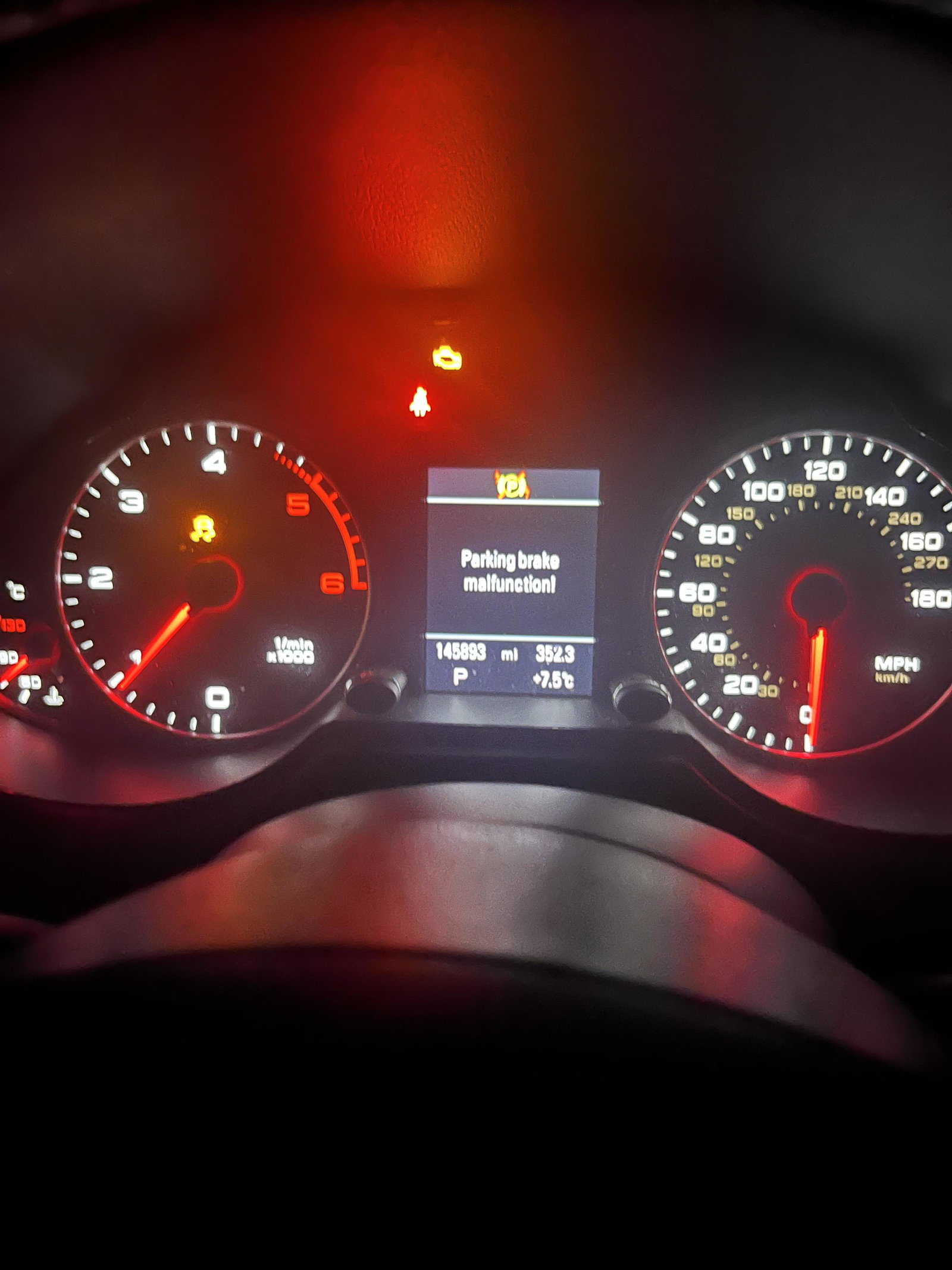

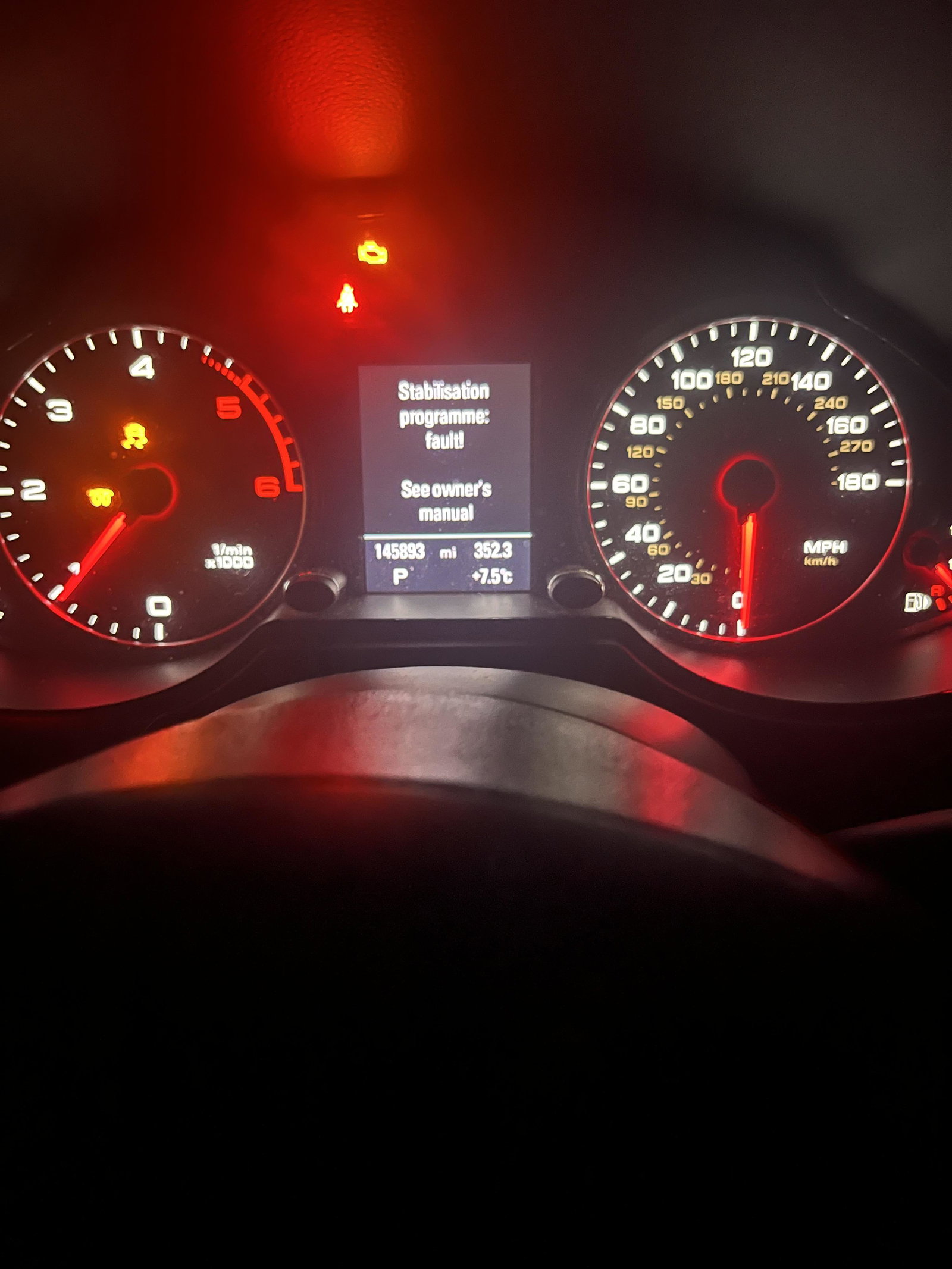

FrannyB Posted October 26, 2023 Posted October 26, 2023 Hi Guys, I wondered if anyone has experienced this fault on an audi q5 2011. “ stabilisation programme fault see owners manual. “ Thanks
Steve Q Posted October 30, 2023 Posted October 30, 2023 Id recommend a diagnostic check to see if any fault codes flag up. I'm wondering if your battery is failing if it's old as a failing battery can throw up unusual electrical gremlins. 2
FrannyB Posted October 31, 2023 Author Posted October 31, 2023 On 10/30/2023 at 6:38 AM, Steve Q said: Id recommend a diagnostic check to see if any fault codes flag up. I'm wondering if your battery is failing if it's old as a failing battery can throw up unusual electrical gremlins. Hi Steve thanks for your reply. My battery is reading 12.2v which is a bit low? 4892 code is showing which I believe has something to do with the EGR valve. thanks
FrannyB Posted October 31, 2023 Author Posted October 31, 2023 Just now, FrannyB said: Hi Steve thanks for your reply. My battery is reading 12.2v which is a bit low? 4892 code is showing which I believe has something to do with the EGR valve. thanks The previous faults have now cleared but the coil is now flashing. The only way I can reset it by switching the engine off then back on again.
Magnet Posted October 31, 2023 Posted October 31, 2023 Hello Francis, If your battery is reading 12.2 volts then that’s not a good sign of its efficiency, and below par batteries can lead to all sorts of ‘stray’ warning codes. My advice would be to first get its efficiency checked. Halfords and others can do this, but please come back to us before committing to buy - if found to be substandard. Kind regards, Gareth. 1
Steve Q Posted November 4, 2023 Posted November 4, 2023 I agree with Gareth. Get the battery changed then see if fault codes return
