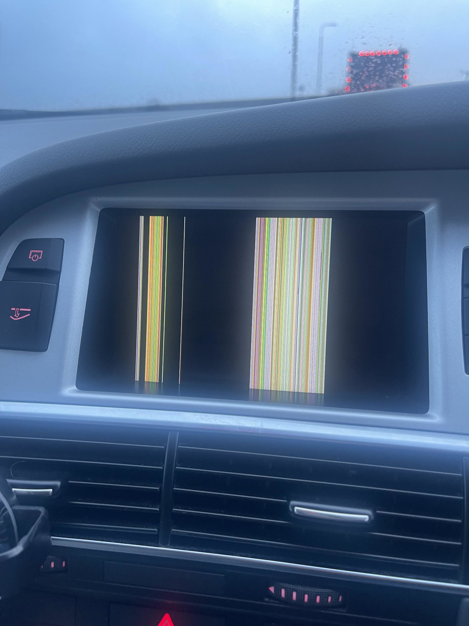

Sparkysi Posted November 3, 2023 Share Posted November 3, 2023 Hi all, thanks in advance for your expertise. Sorry if this has been covered. I have an Audi A6 Allroad 2011. The MMI was displaying correctly until an hour into the drive when the screen just displayed coloured lines. See attached image. Everything still seemed to work, radio, nav etc but screen displayed nothing. Any advice would be great. Quote Link to comment Share on other sites More sharing options...
Steve Q Posted November 4, 2023 Share Posted November 4, 2023 I think it's an issue with the screen. You could try disconnecting it and reconnect it but I think you might need to source a second hand unit as the most cost effective option Quote Link to comment Share on other sites More sharing options...
Solution Sparkysi Posted November 4, 2023 Author Solution Share Posted November 4, 2023 8 minutes ago, Steve Q said: I think it's an issue with the screen. You could try disconnecting it and reconnect it but I think you might need to source a second hand unit as the most cost effective option Hi Steve, Thanks for your reply. I did wonder if it could just be the screen as everything seems to work other than the screen. Quote Link to comment Share on other sites More sharing options...
Steve Q Posted November 4, 2023 Share Posted November 4, 2023 Yea I'd suspect it is. Quote Link to comment Share on other sites More sharing options...
Sparkysi Posted November 4, 2023 Author Share Posted November 4, 2023 Cheers Quote Link to comment Share on other sites More sharing options...
Sparkysi Posted November 17, 2023 Author Share Posted November 17, 2023 Just to close the post. I finally got round to changing the screen and all sorted. many thanks Quote Link to comment Share on other sites More sharing options...
