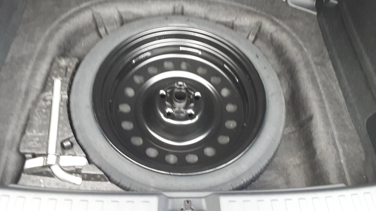

Phil-S Posted January 30, 2024 Posted January 30, 2024 (edited) As a follow-up to my earlier comment the wheel I got from eBay from an A3 8V does indeed fit my 2022 A3 8Y. The wheel you need should have a fitting of 3.5 Jx16 ET25.5 (May look like 31/2…….) which should be stamped on the steel rim somewhere. It has a tyre size 125/70 R16. Don’t always believe what the sellers say it came off or what eBay thinks will fit your car! I think this space saver fits a lot of VAG cars but they charge more if they say it fits an A3 when it came from a Golf! I already had a pack of tools (brace, cap remover, towing eye, torx and screwdriver rods etc) but found the full Audi pack on eBay too apparently from a 2021 A3. It’s L shaped styrofoam and sits in the near left corner round the space-saver as you look into the boot. It included all the other tools I had but critically a Jack which was niftilly sandwiched between the styrofoam. Good luck! Edited January 30, 2024 by Phil-S Wrong part number quoted
joe6 Posted Thursday at 04:11 PM Posted Thursday at 04:11 PM Raising an old thread but spent some time on researching fitments so thought it might help . All mk7 appropriately sized parts fit as well as A3 8v parts. I recently bought an A3 35tfsi with 19" wheels. Bought on eBay a spare wheel 18" from a vw mk7 gti 2018 for £75, a jack set from vw mk7 for £45, a spare wheel well liner from an A3 8v for £35 and plastic bolt for £7.50. Could have got a spare wheel for less but of indeterminate age. Very pleased with the result and price😬
