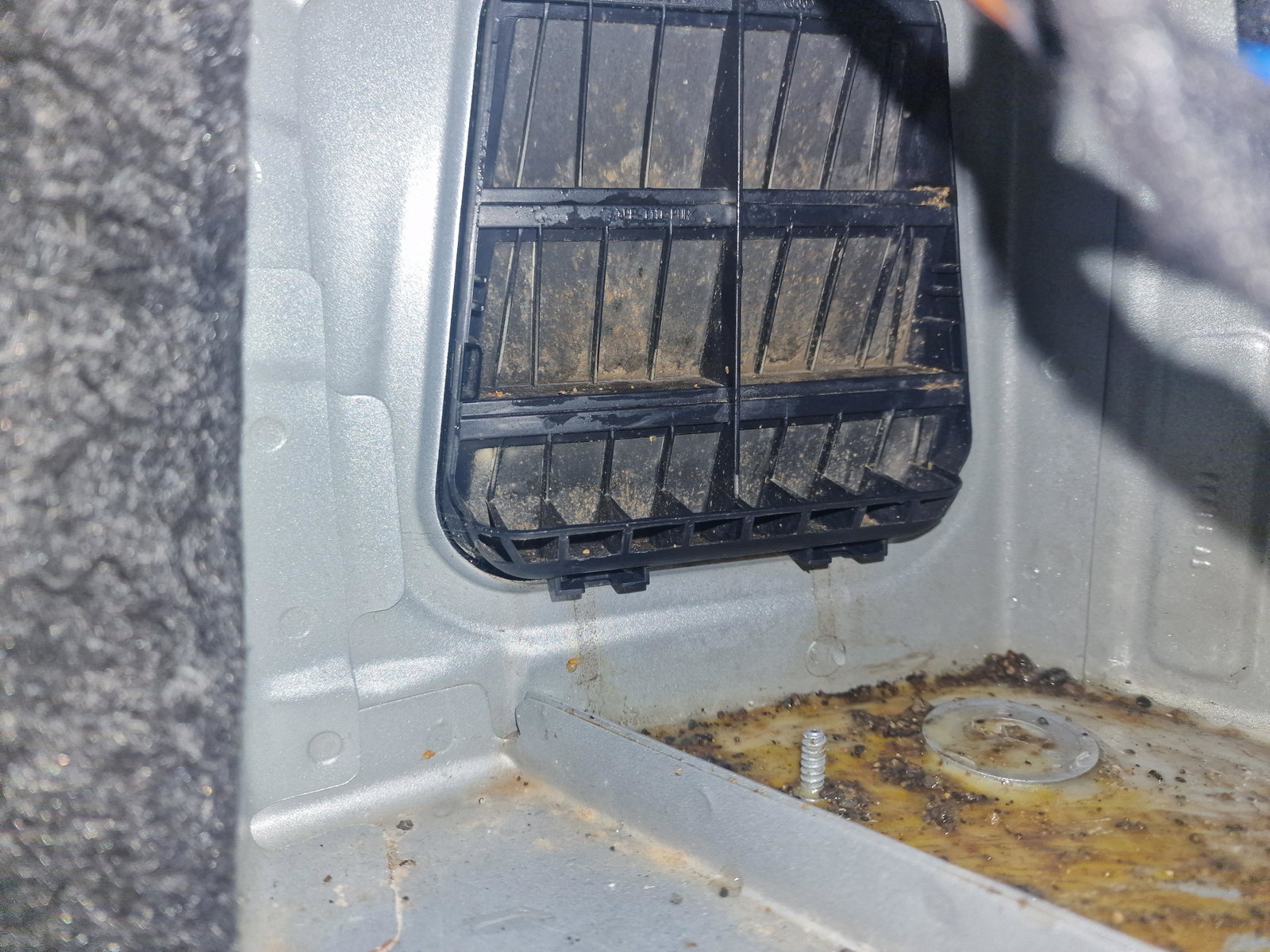

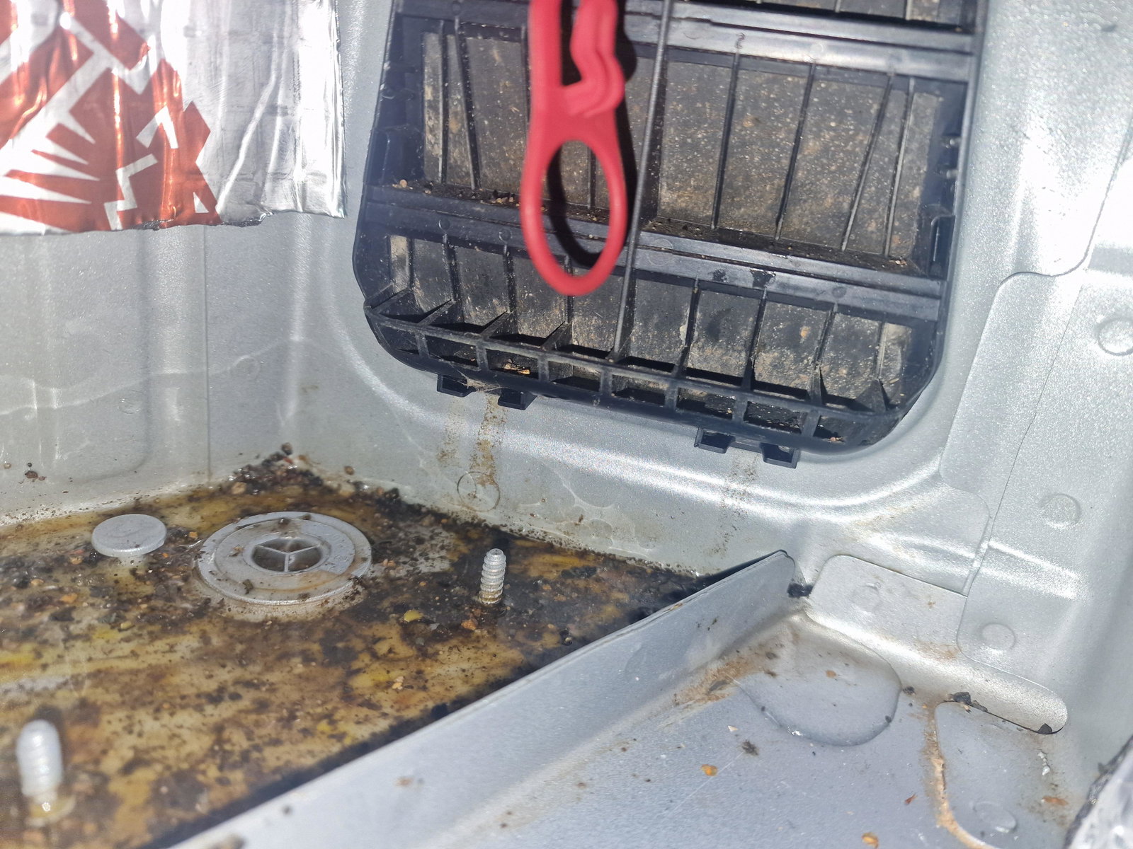

MattLNUFC Posted November 3, 2023 Posted November 3, 2023 On several occasions I've noticed that there has been loads of water in the boot, under the removable flooring. After the recent heavy rain, this was really bad! Any suggestions on where it could be coming in from? Seals look good all around, and the boot floor isnt wet, so can only assume it's coming in from underneath somewhere....
Solution Joe8v Posted November 30, 2023 Solution Posted November 30, 2023 For me was coming from the side air wents. See pics. I quick fix would be to remove the two plug from the bottom.
