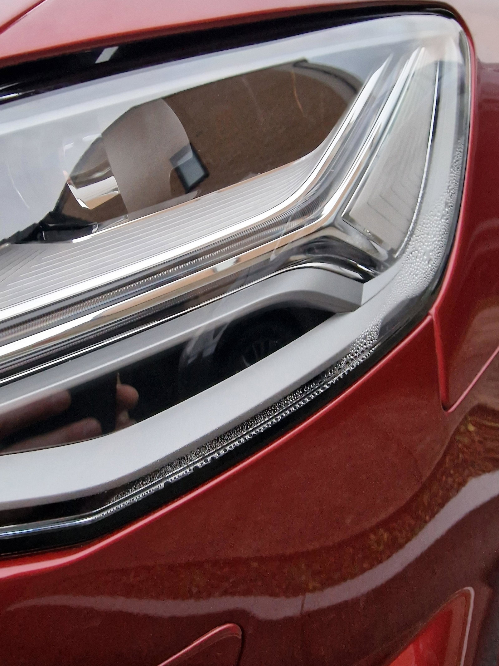

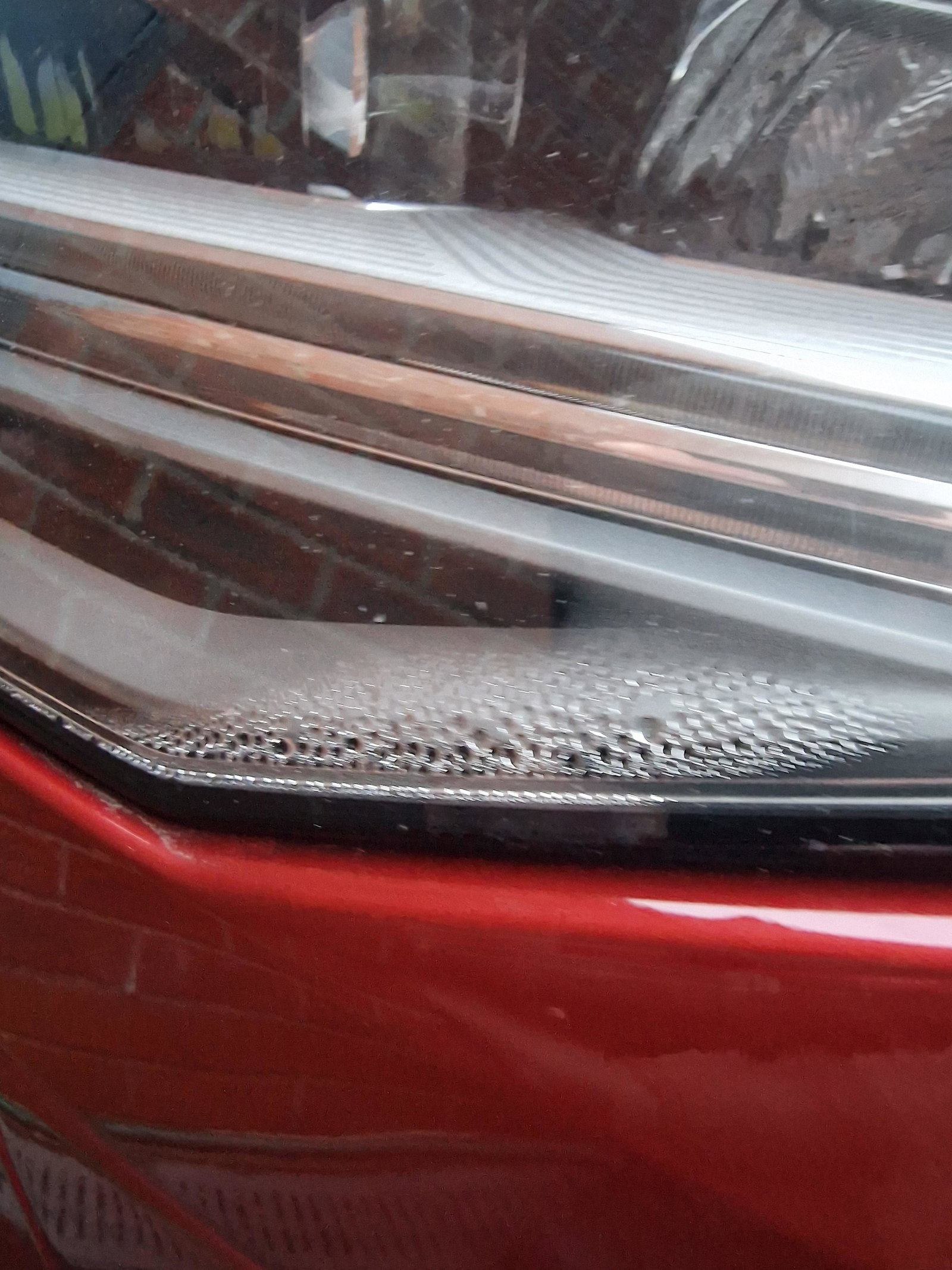

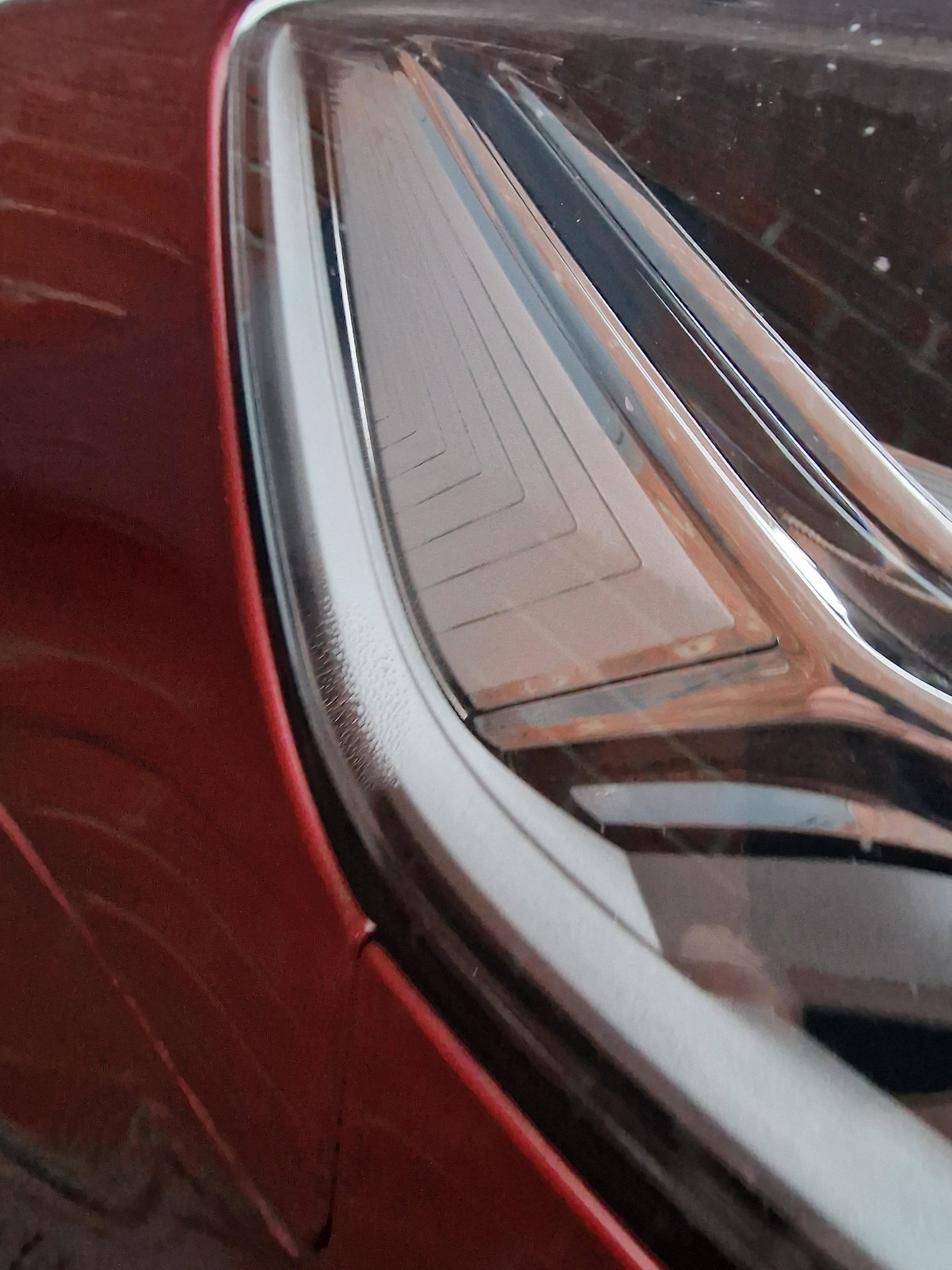

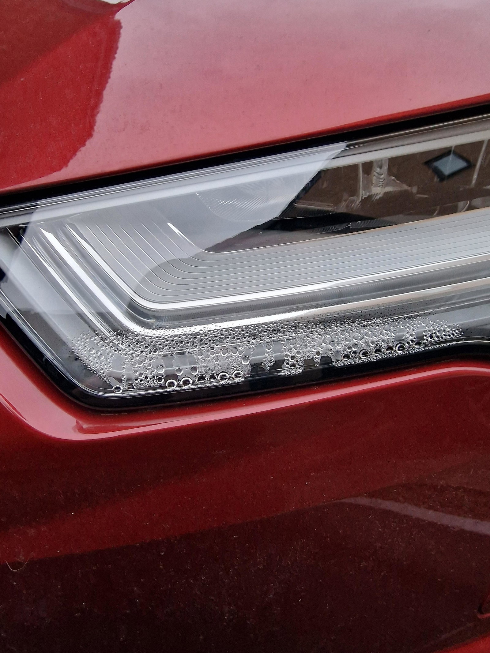

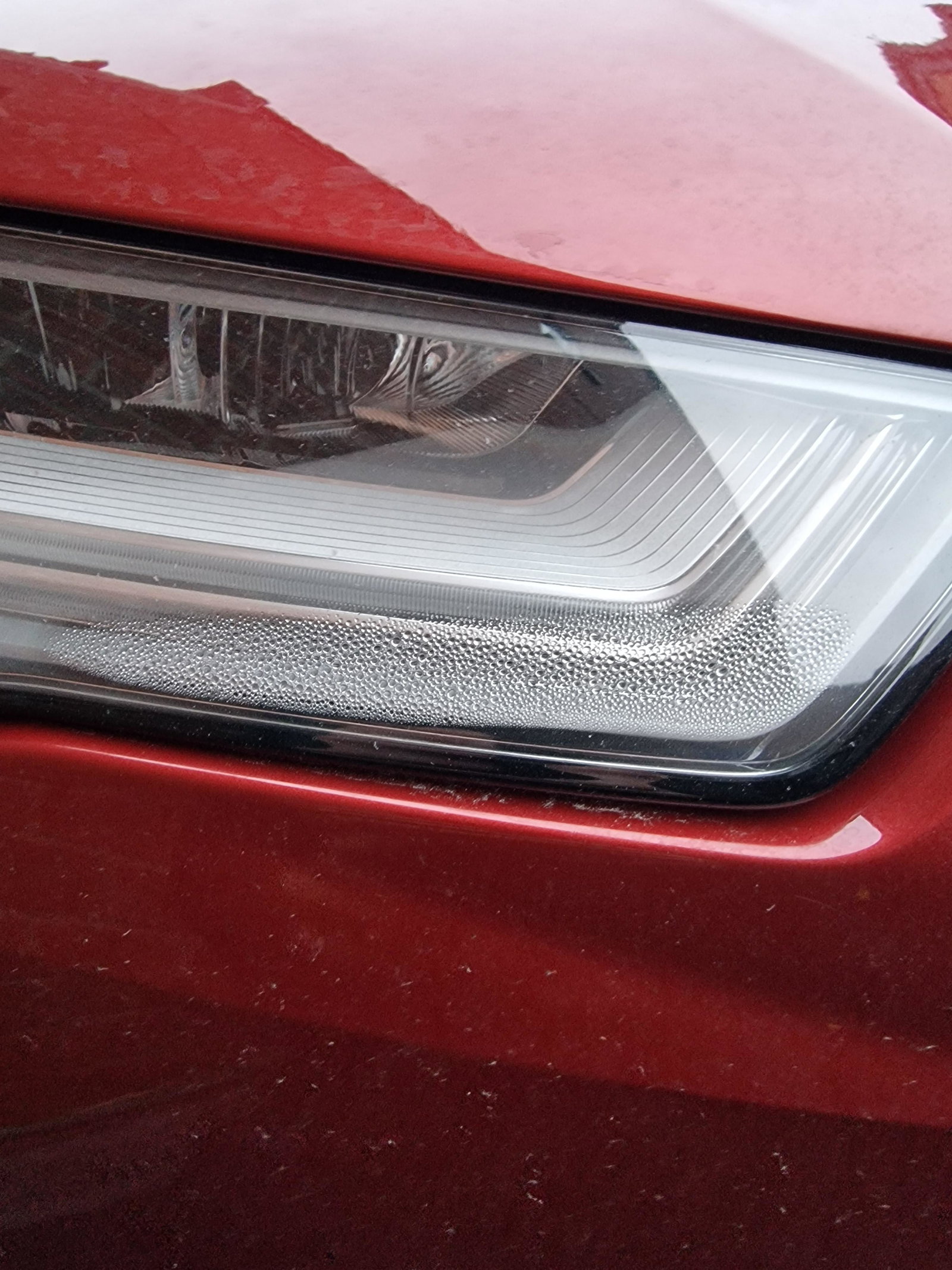

Patrick P. Posted December 15, 2023 Author Posted December 15, 2023 Hi Gareth, Thank you for your advice . I attached photos for you to view how bad is this condensation . Much appreciated.
Magnet Posted December 15, 2023 Posted December 15, 2023 Thanks Patrick, It does seem to be getting quite a problem with many makes of cars, and include rear lenses as well - all very expensive units to change. Kind regards, Gareth.
Bo Stefan Posted 14 hours ago Posted 14 hours ago If the water does not disappear, there is a solution to read about on this forum. There might be a crack in a plastic plate that can be replaced at a low cost. https://www.audiworld.com/forums/a6-c7-platform-discussion-194/no-headlight-condensation-3048325/
