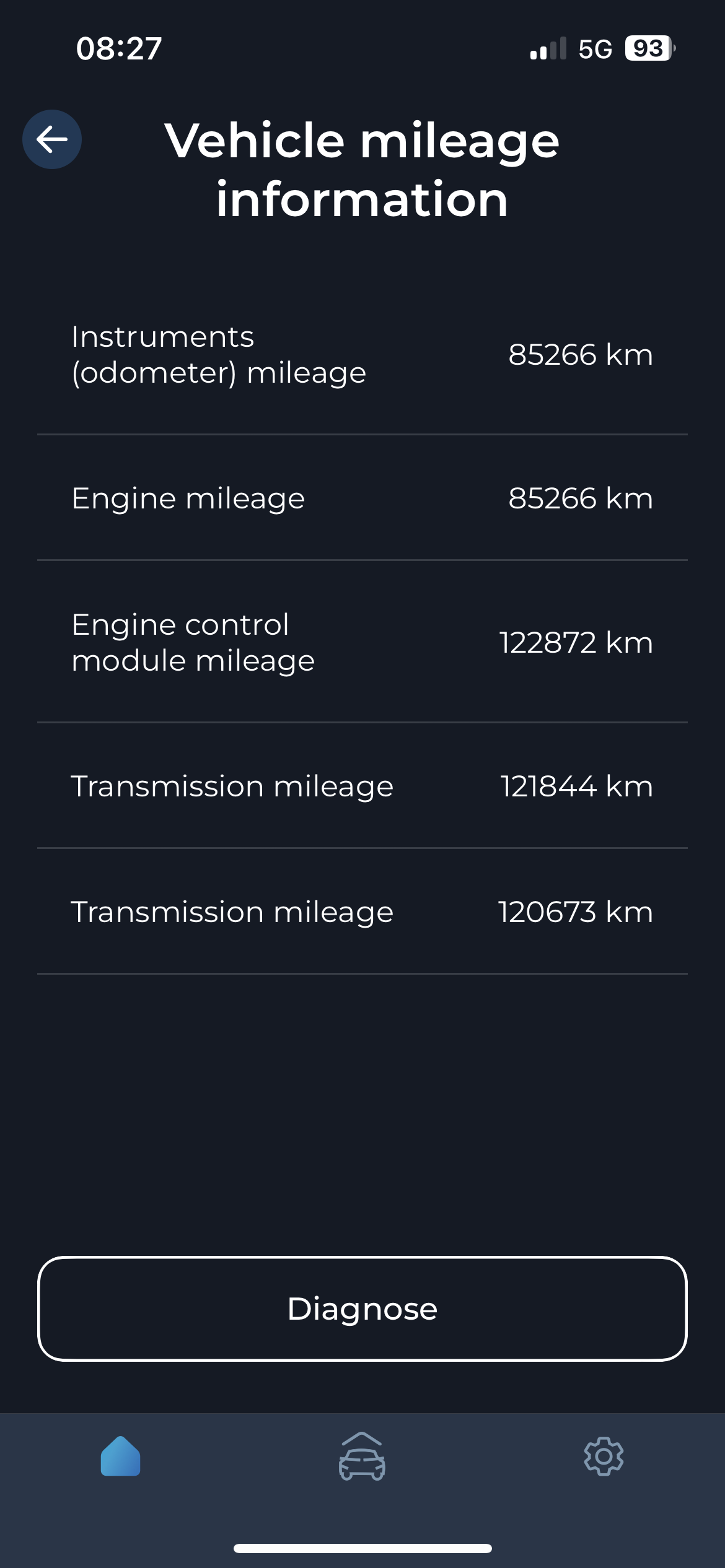

Rons3 Posted January 21, 2024 Posted January 21, 2024 Can anyone shed some light on this look like the mileage has been tampered with is there anything I can do to fix this?

Magnet Posted January 25, 2024 Posted January 25, 2024 So have you yet attempted to get a service print out via. an Audi specialist? I did mention the possibility of a replacement ECU having been fitted. Sorry to be make a suggestion of bad news, but it looks like the reading on your odometer does not represent the distance this car has covered.
Rons3 Posted January 25, 2024 Author Posted January 25, 2024 Yeah I went to Audi the printed me off the service history all the numbers match up but no record of any refurbished parts so the odometer has been tampered with do you think even if he comes back with records of the replacement?
Magnet Posted January 25, 2024 Posted January 25, 2024 Your choice I guess, but it appears it has been subjected to some form of ‘mileage correction’ at some time, if the infirmation can be substantiated. Two things to consider:- The car will have a lower value due it it’s higher mileage. The car shouldn’t be resold with any indication that the odometer mileage is correct, so this will obviously limit its selling appeal, and again devaluate it. As I see it, you will have the option to reject the car within 30 days and to receive a full refund. Two things that remain unclear from your original post:- When did you actually buy it? What diagnostic system have you used that provides you with the data in your opening post? Kind regards, Gareth.

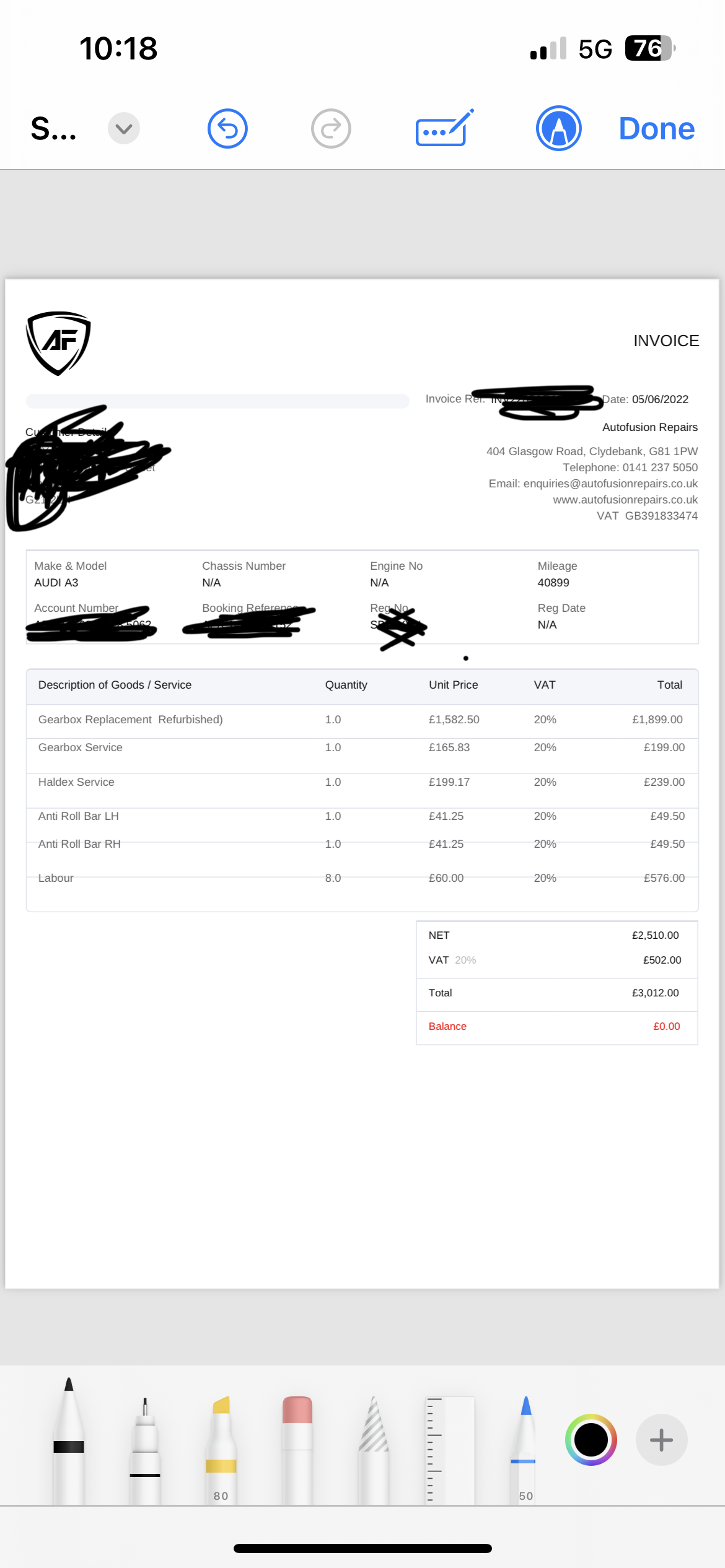

Rons3 Posted January 25, 2024 Author Posted January 25, 2024 It was ma friend that had the Carista this is the recipe of the work done could this make the numbers the way they are
Magnet Posted January 25, 2024 Posted January 25, 2024 What are you trying to tell us Ronald? Is this to support a theory that the odometer is correct, but the car was fitted with a refurbished gearbox which had covered a higher mileage -? You haven’t said when you bought it. Kind regards, Gareth.
Rons3 Posted January 25, 2024 Author Posted January 25, 2024 Sorry got the car 2 week ago today and just looking for some advice on the matter really so anyway av booked it into Audi and been told from the dealer if it comes back as clocked they will reverse the sale Al updated once it’s been into Audi 1
