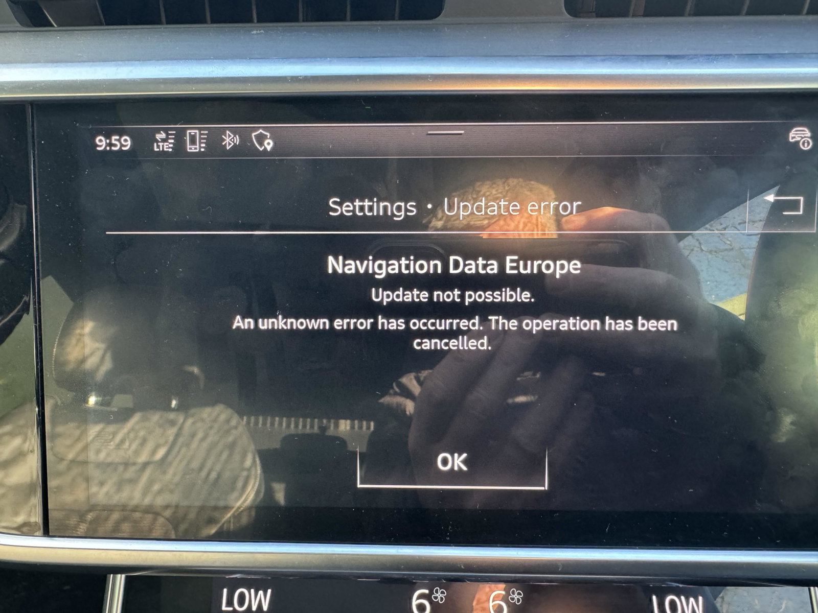

Ok. So I updated the Europe maps using the official MyAudi link onto a SD Card (2019 model). 2023.1_P0630 looks to be the latest on the website
Now I get "Update not possible. An unknown error has occured. The operation has been cancelled".
I'm assuming this is the auto update function getting upset, which as I understand only updates the region you travel around. "England Central, Wales"
Anyone else see same error message after a manual Map Update? Any thoughts on a fix or diagnostics?

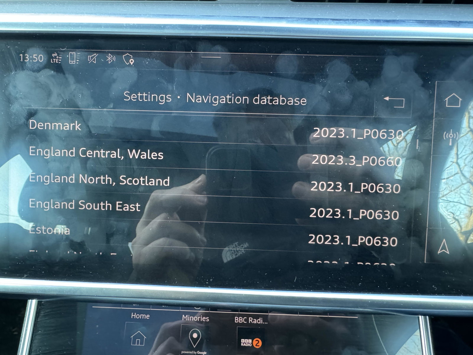

I’ve updated using 64GB SD card to P660. This appears to have gone ok. Takes about 45 minutes but I could use the car and stop/start, lock, make journeys while it did its thing.

3/ updated maps via SD Card to P660
4/ factory reset settings - online update only
5/ reenabled auto update
Still the same “error unknown” when the MMI goes to automatically update the maps online. I was expecting after a full manual update to P660, which I believe is the latest that auto-update would at least say “no update required”. Factory Resetting the online auto update seemed to only turn it off.

Surely someone must have at least seen the attached Unknown Error Message during an auto-update. Find it hard to believe this is the only time its occured. Granted it could be many, many reasons why.
It's not the SD Card update. Thats gone fine twice. It's the "auto-update" feature from the Audi Connect. It does a "check" every day? or every week? to auto update the maps online. That's where the error message is coming from.

Audi Connect transferred me to my local dealer. They reset the settings, which they admitted didn't appear to make any difference. Its booked in for a whole firmware update. I think its 1 version behind.
Anyway. Today, it starts to actually download the map update, installs it and its the latest for my region.
My suspicion is that updating the whole map and the polling looking for an update is a bit wonky, fingers crossed, now it has actually updated that i won't get the error every week that it polls for another region update.
