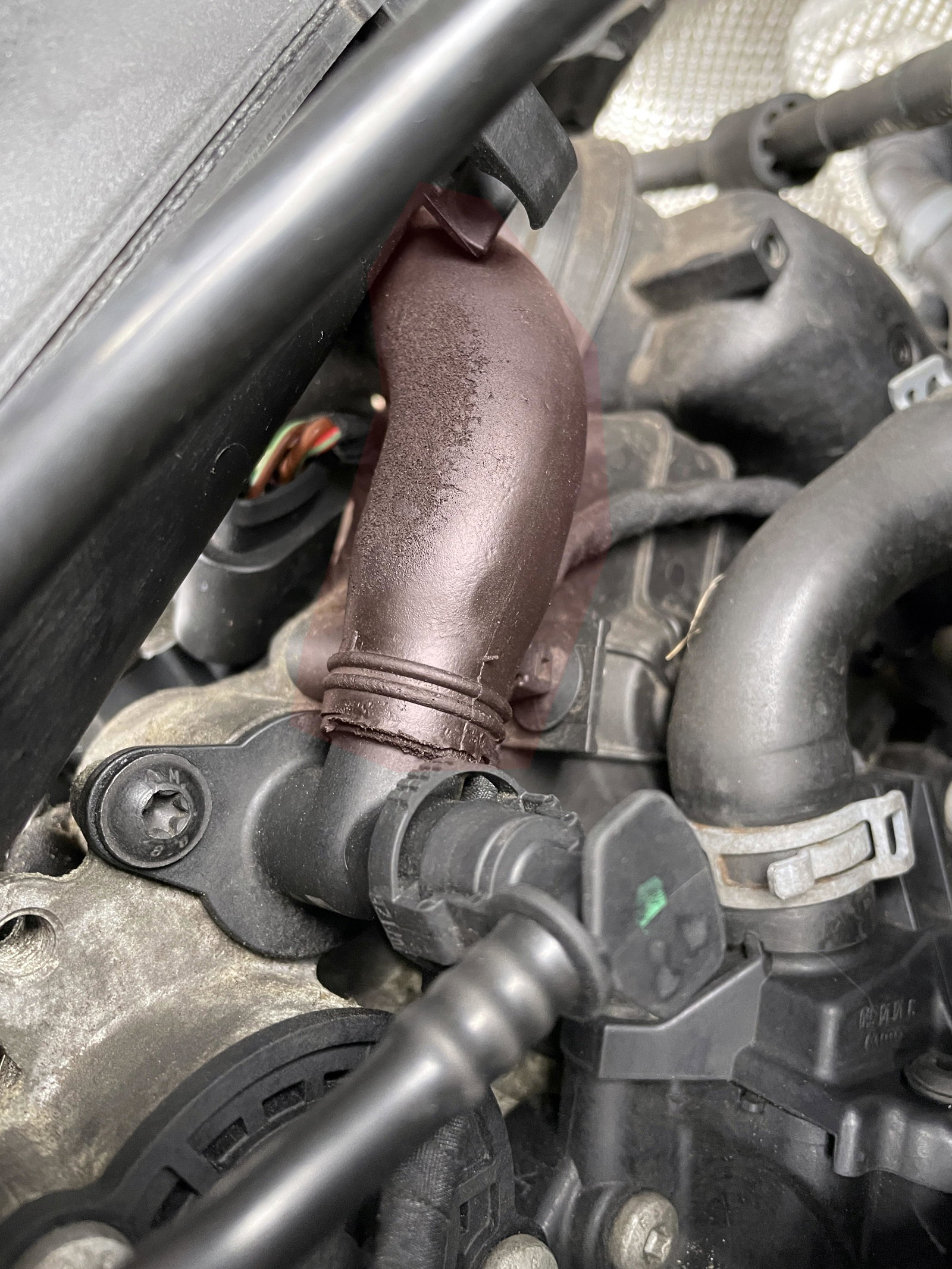

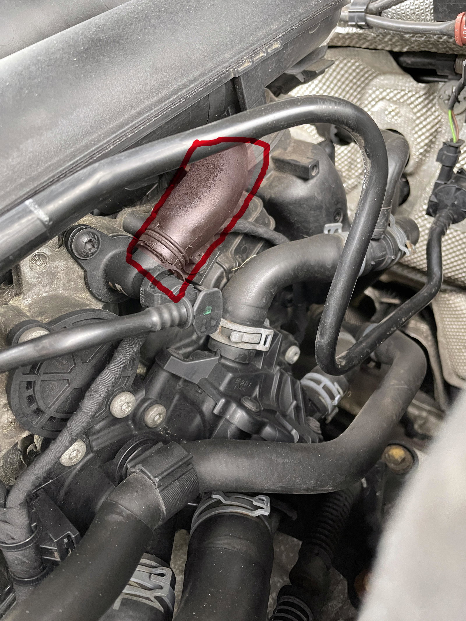

Anybody help with identifying this part please?
2012 A3 1.4tfsi
Hose is deteiorating and id like to replace it before it fails out on the road.
right-hand side (from the front ) of the engine bay

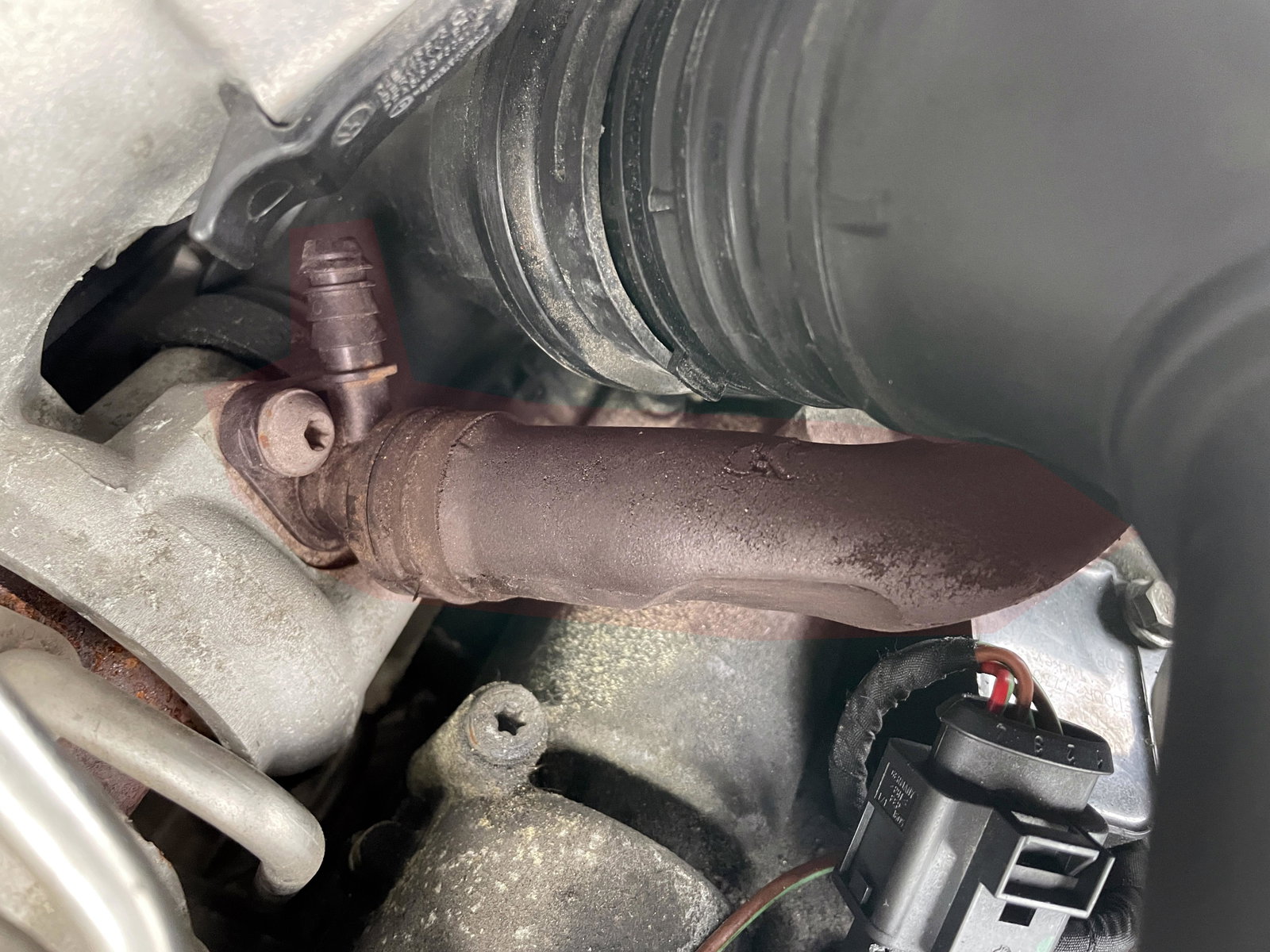

opposite end of hose

You may find on the pipe the part number, it may help you with getting a replacement pipe, I see it seems to run from the Turbo on the induction side, so more than likely an induction pipe
Hi Darryl, there's no part number on the pipe.

Kinda there with this… from a series of back and forth emails with images, my local Audi main dealer have come up with a part  number…
04E 103 474 BB.
snag is, after doing a google search of said part number, images don’t look exactly like my part.
I’ll order anyway and cross that bridge when I come to it.

The crankcase to Turbo breather hose appeared to be deteriorating... on removal,  what i  thought was the rubber hose turning spongy, was just an outer sheath.
Was tricky tracking a replacement ...
Surprisingly, the replacement was reasonably priced from Audi ...
Strange... the new hose does not have a nozzle on the turbo connector end
Where the original has ...
What is  more puzzling, the nozzle is blanked off on the inside image.gif.e9569f39d385e2e446de33f57970510e.gif
