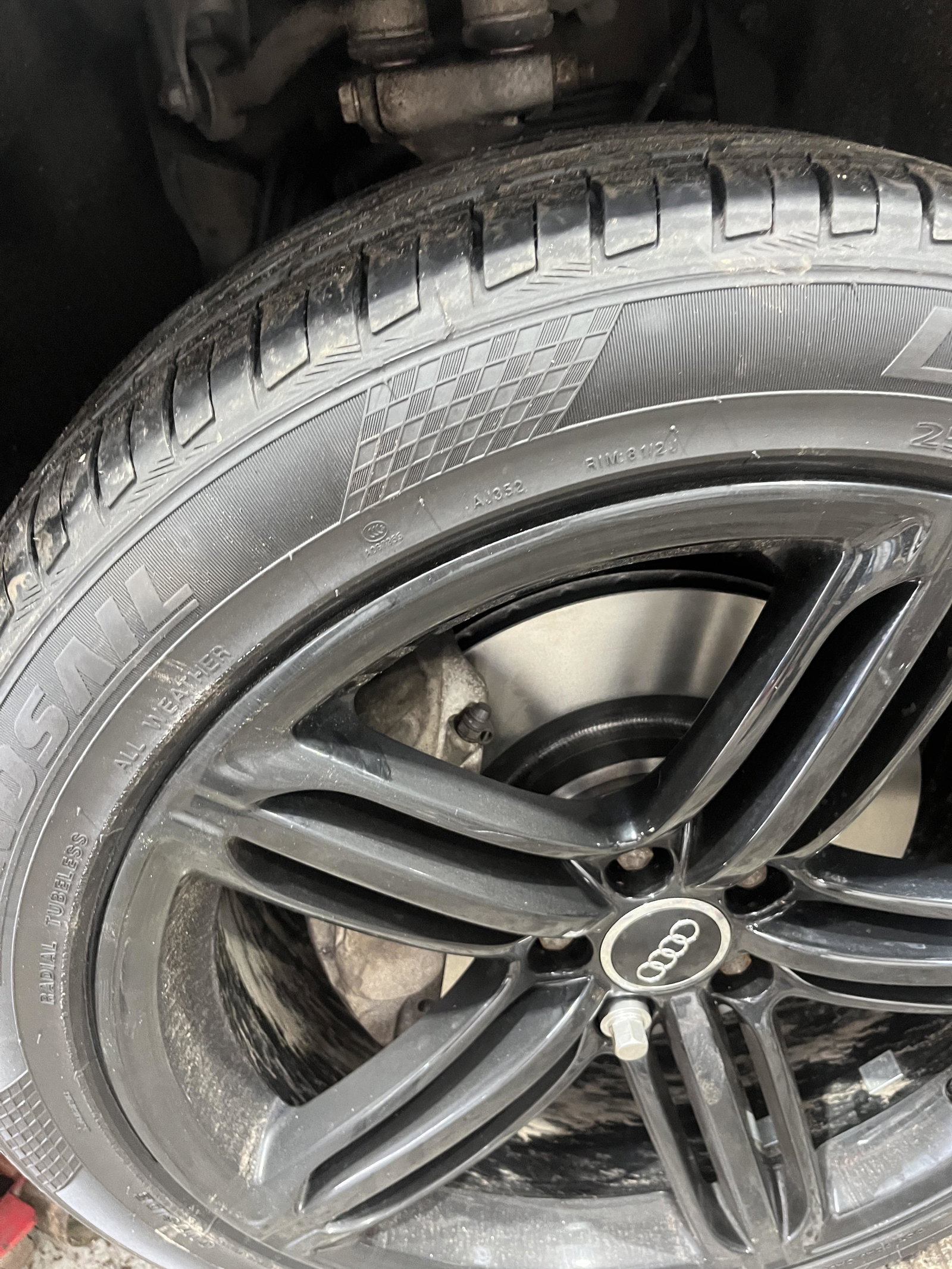

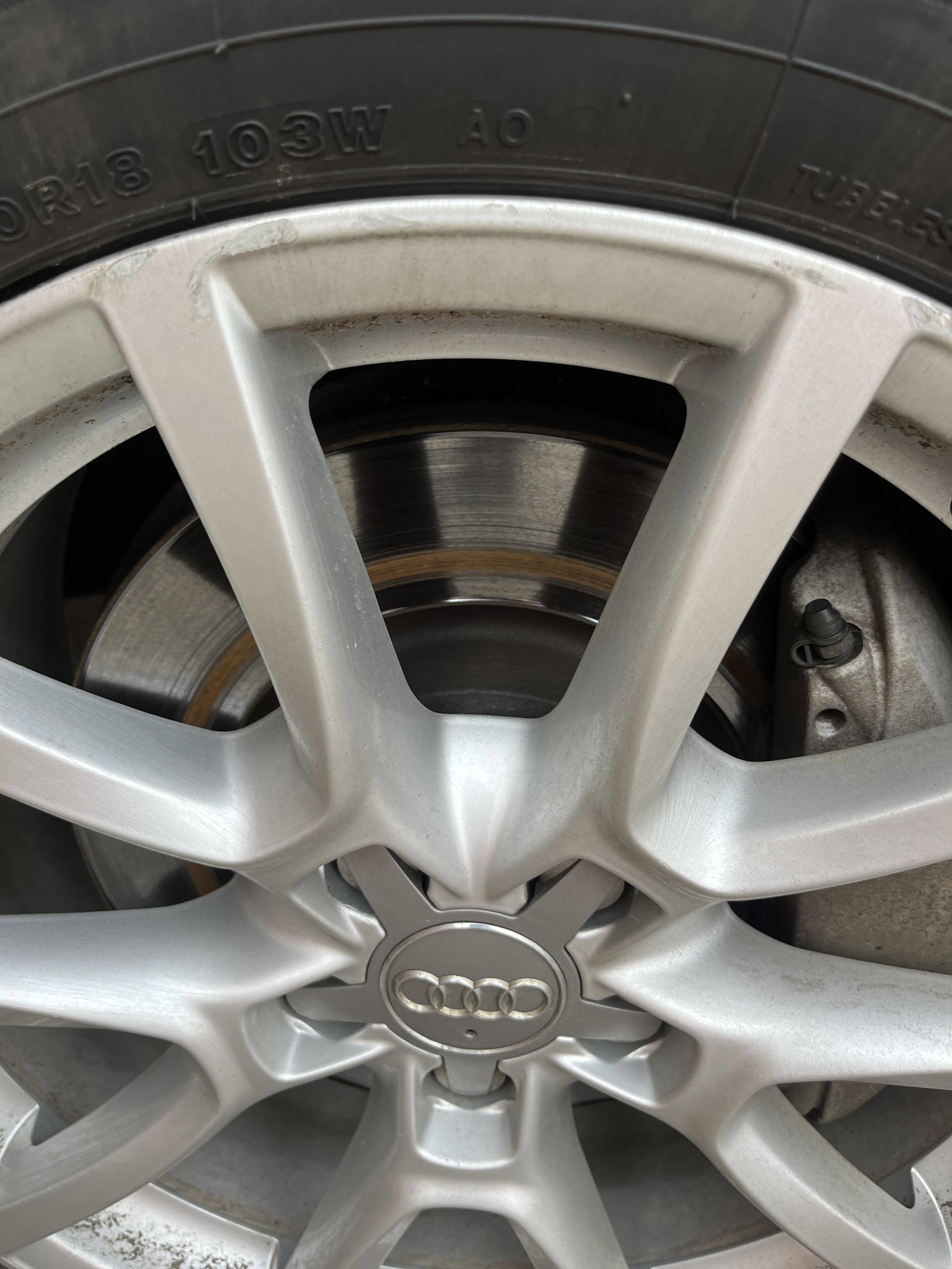

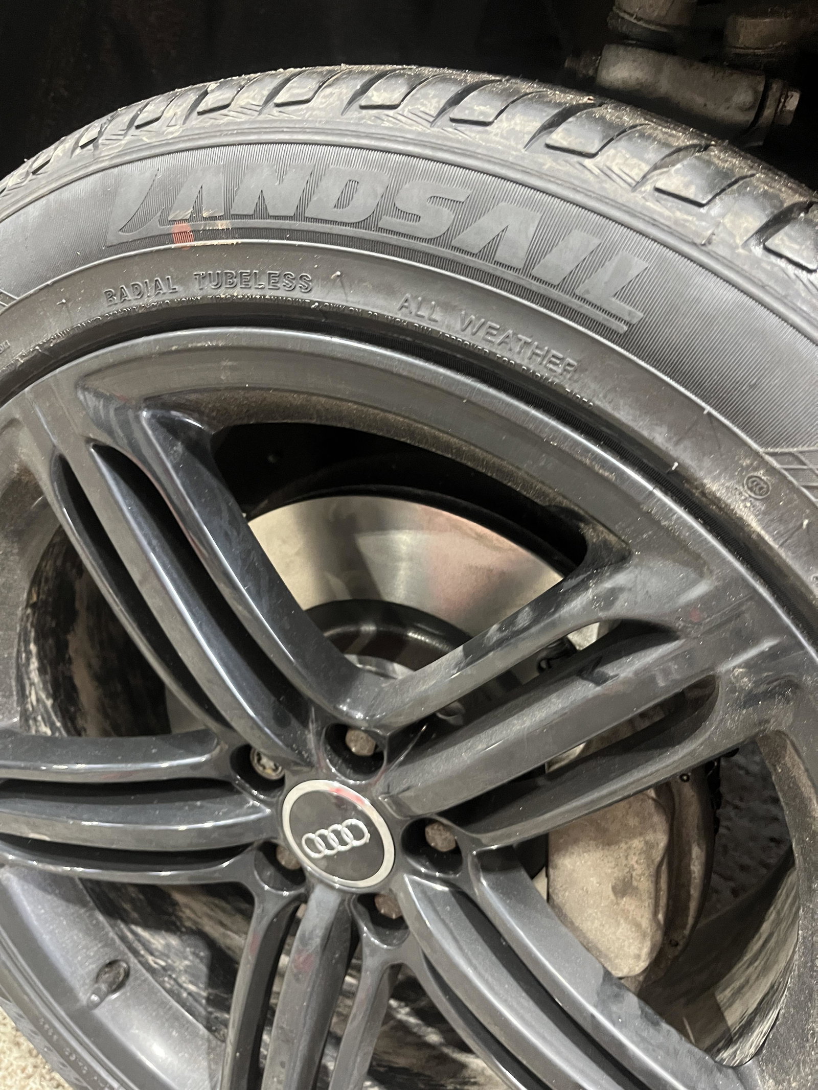

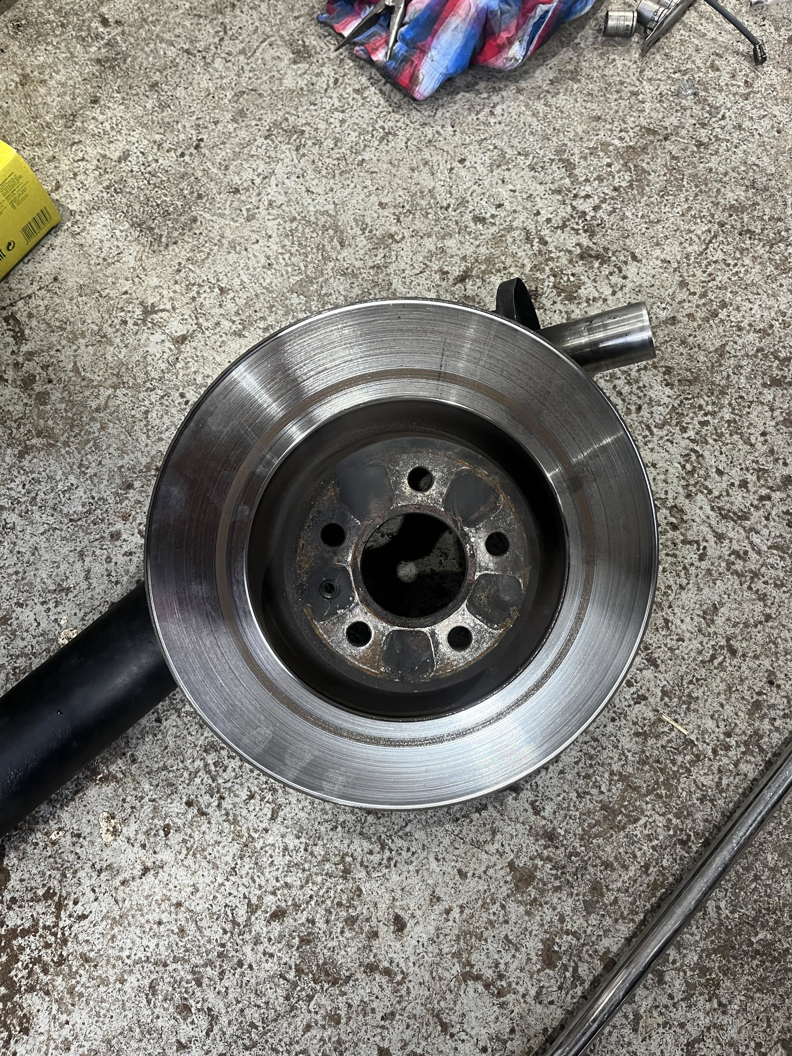

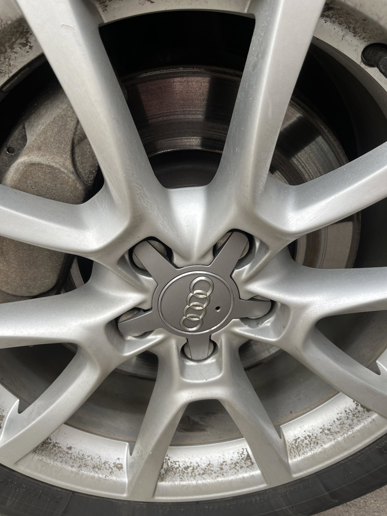

Nash_____ Posted January 30, 2024 Posted January 30, 2024 Hi I have recently bought a 2014 Q5 SE 3.0TDI Quattro with full service history but both front brake docs have a rust ring in exact same location, any ideas of the cause and rectification? TIA
Magnet Posted January 30, 2024 Posted January 30, 2024 The reason why Nigel?? The recently bought bit probably has something to do with it due to the possibility of vehicle standing with little use - on forecourts etc. Solution:- Renew discs and pads. You should find some competitive prices for quality Brembo parts from reputable sellers on eBay. Of course, you could just ignore the slightly reduced braking efficiency, and change them when the pads next need changing. How much pad thickness do you have left Nigel? Kind regards, Gareth. 1
Nash_____ Posted January 30, 2024 Author Posted January 30, 2024 Hi many thanks I’ve got it in for brake check tomorrow and wheels are being refurbished today so they’ll take some pictures to re pad wear, thanks very much for the quick reply 👍👍 1

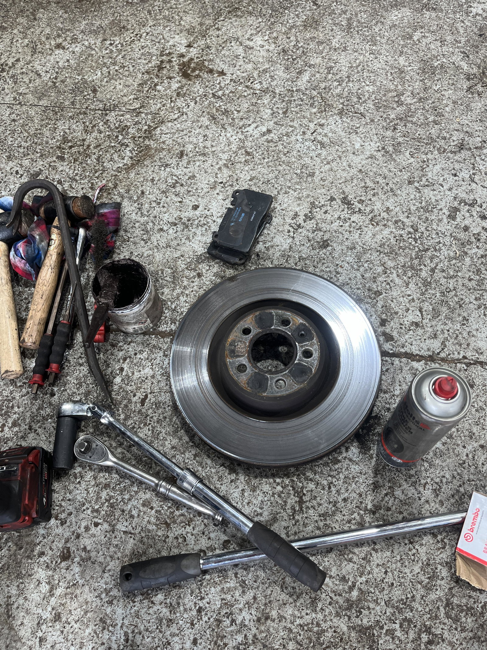

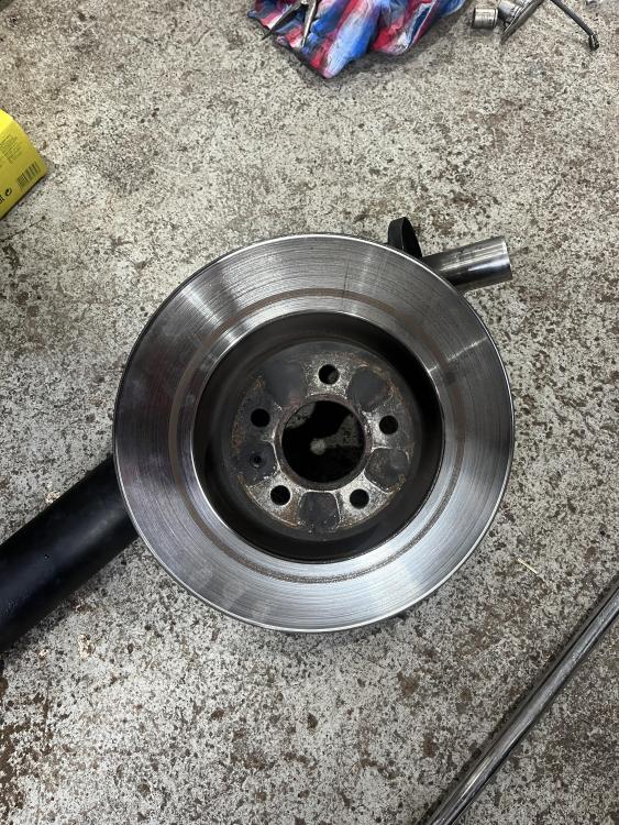

Nash_____ Posted February 4, 2024 Author Posted February 4, 2024 Hi after inspection new pads fitted to old worn discs, Car Dealership says normal procedure when pads worn out and scoring discs 🤣 Have stated should always fit in pairs, new pads need new discs and vice versa, pathetic excuse still on going with dealership for replacement🙏
Magnet Posted February 4, 2024 Posted February 4, 2024 Many thanks Nigel, Probably not bought from a main dealer due to age of vehicle -? I think what you have suffered from is cheapest repair option. Although I understand where you are coming from in respect of ‘always fit in pairs’ ( discs and pads), I don’t necessarily think this is always necessary - proviso:- the disc surfaces are reasonably free from scoring, and will remain within thickness tolerance through the life of the new set of pads, and are not suffering from vibration on braking. The latter may actually be introduced on fitting new discs. In your case, there is absolutely no doubt that the discs are totally shot, and your principle should have applied without question. Perhaps you could let us know how you get on. Kind regards, Gareth. 1

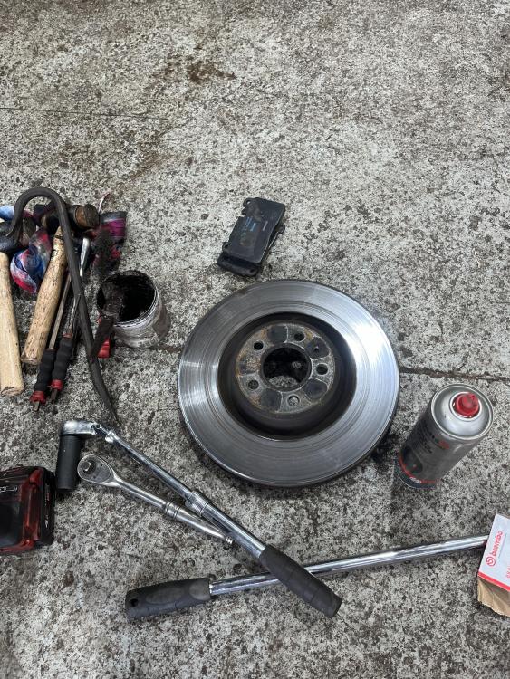

Nash_____ Posted February 15, 2024 Author Posted February 15, 2024 On 2/4/2024 at 12:22 PM, Nash_____ said: Shocking really for a main dealer for sure, this isn’t the case for me but nevertheless still bad practice in my opinion 👍 Car dealership (non Audi) accepted responsibility new Brembo discs and pads fitted, had to use my tenacity reserves but all good in the end 👍
