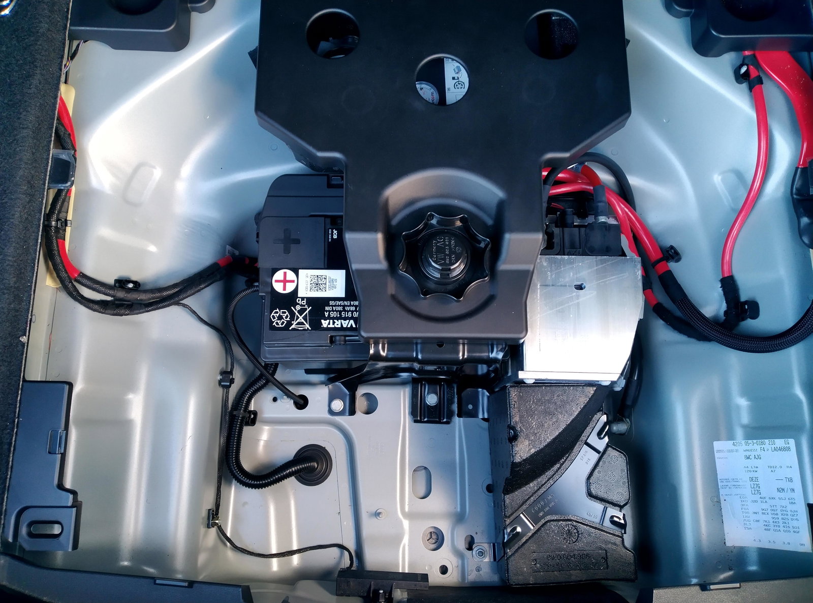

Peteb1951 Posted February 26, 2024 Author Posted February 26, 2024 Everyone who has replied had the Avant. I've yet to have any info ref a spacesaver fitted in a saloon. I called into my local Audi dealers today and asked them, a total waste of time I got the standard response"if it wasn't fitted as standard equipment we can't comment" I've attached photos of the boot space for a spare in the saloon. As you can see it differs from the Avant. Any additional info for the MHEV Saloon would be welcome.

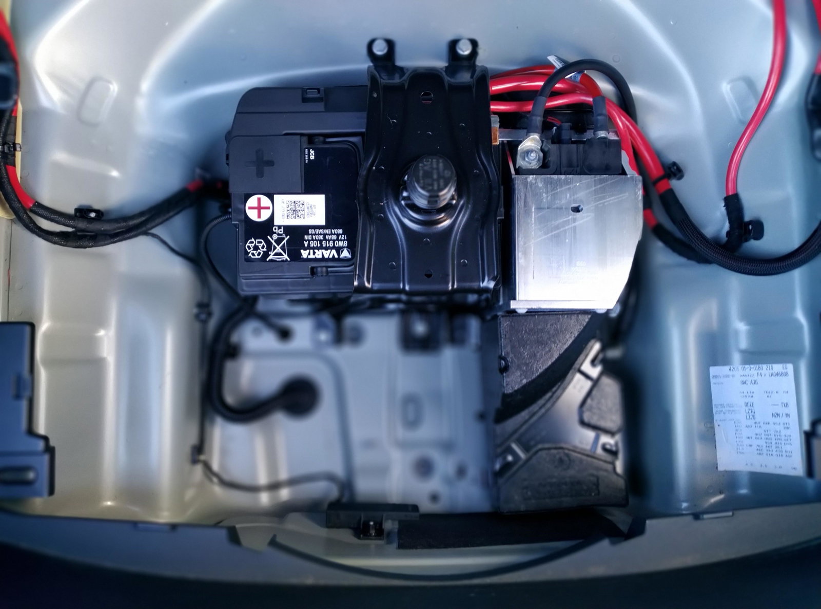

Sean12 Posted March 9, 2024 Posted March 9, 2024 (edited) Hi, I have an A4 TFSI 35 MHEV 2020, I am also trying to get a spare wheel and jack kit from eBay but I am unsure if the wheel would fit in the boot if I remove the repair kit. I have 19" alloys. I presume the space saver needs to also be 19" or are they different? I have attached a photo that may give you an idea and I would appreciate your input. By the way, V5 says B8 but folks say its a B9, not sure yet. It looks the same as Peteb1951 photos... Thanks, Sean Edited March 9, 2024 by Sean12
Peteb1951 Posted March 9, 2024 Author Posted March 9, 2024 (edited) Hi Sean Your boot looks exactly the same as mine. I've got a brand new spacesaver on order from the "Wheel shop" it should arrive on Monday, I will let you know how (and if) it fits. 👍 I'd also say you have the b9. The b8 wasn't an MHEV car. Edited March 9, 2024 by Peteb1951

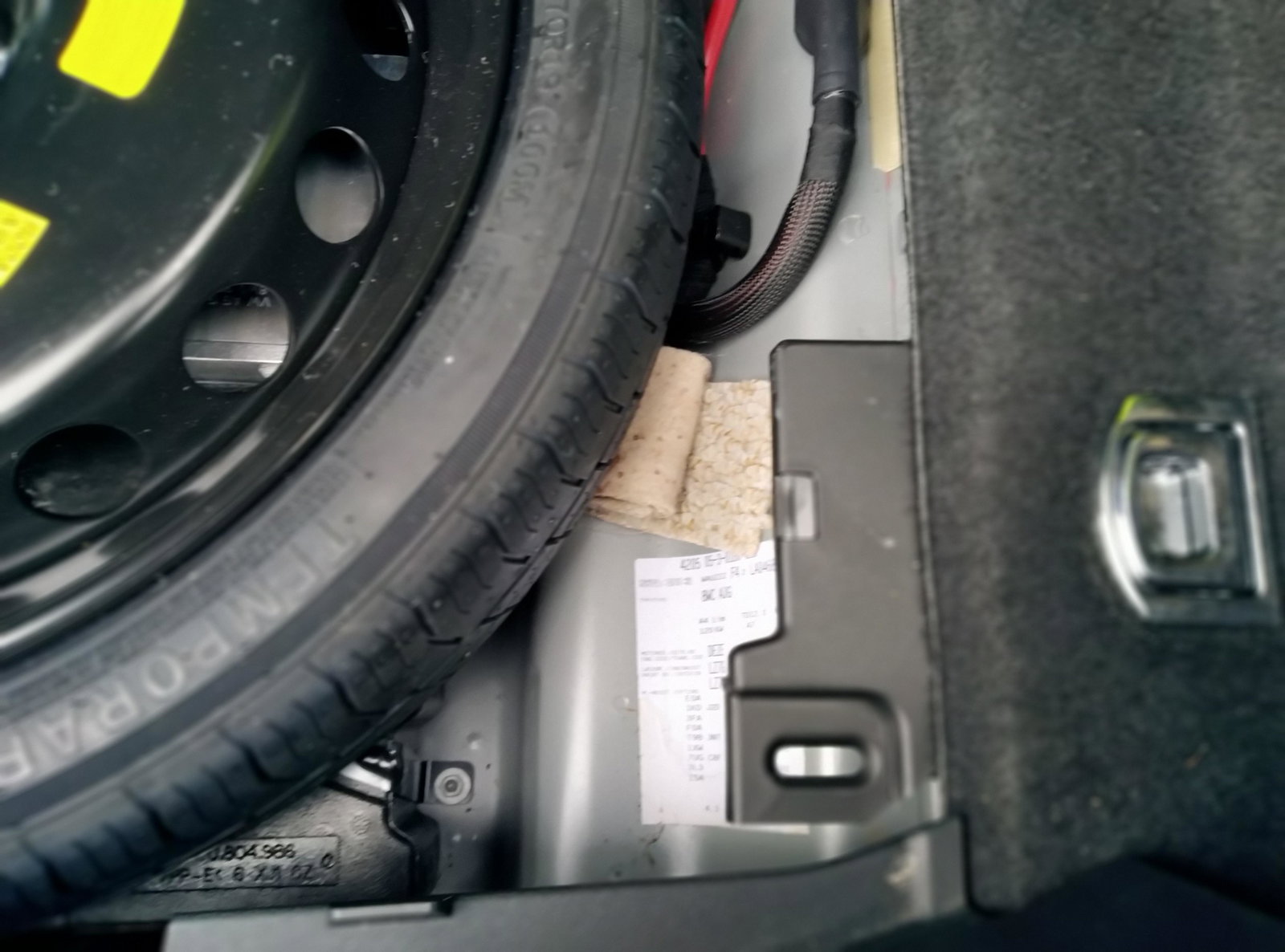

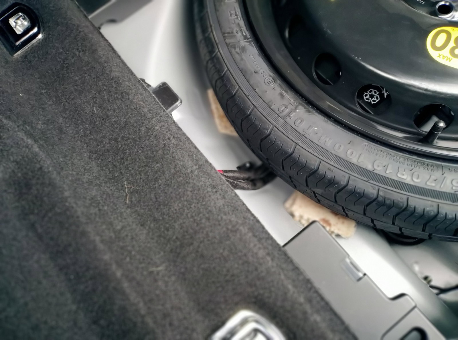

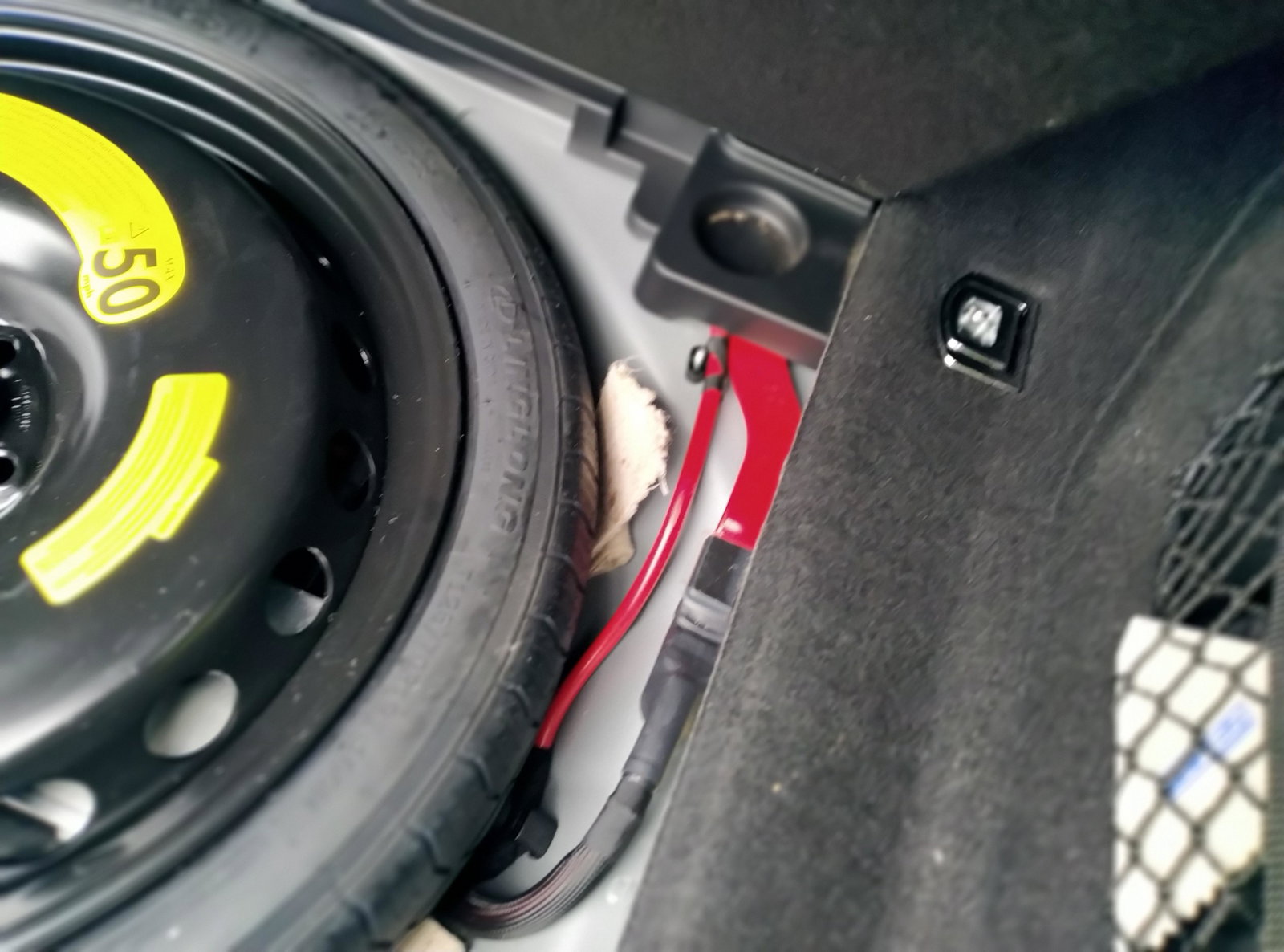

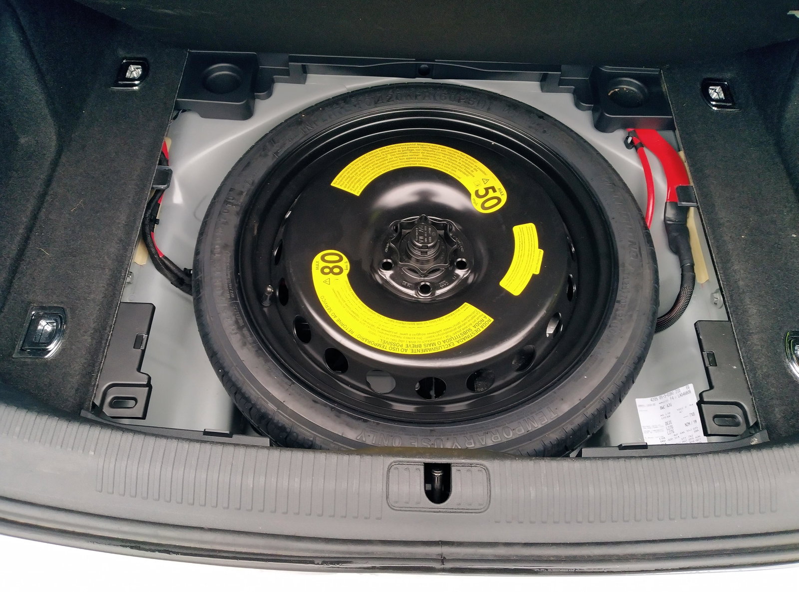

Peteb1951 Posted March 11, 2024 Author Posted March 11, 2024 (edited) Hi Sean Wheel arrived and fits OK👍 It's a 19" but it has the same rolling radius as the 17" wheels My only slight concern is that it's resting on the battery cables, so as shown in the photos as a temporary fix I've cut up a few pieces of carpet which are now taking the weight. Will get some hard foam for a permanent fix (if the factory under wheel foam takes the weight I might source one of those) Note - you have to junk the tyre gunk and compressor container Edited March 11, 2024 by Peteb1951 3

Sean12 Posted March 15, 2024 Posted March 15, 2024 (edited) Hi Peter, That looks great, thanks for sharing the photos, it's a perfect fit. Where do you store the jack kit, under the space saver? Is there enough clearance on the battery pack side under the space saver, the battery seems to have a heatsink Yes, some hard foam should do the job. Edited March 15, 2024 by Sean12
Peteb1951 Posted March 16, 2024 Author Posted March 16, 2024 (edited) Hi Sean I store the jack and extendable wheel brace in a strong fabric bag which velcro's to the boot carpet, there's not too much room under the spacesaver widthwise. If you wanted to store in the boot I think the fitted plastic storage box between the rear seats and the spacesaver could be replaced for one from a b8 or early b9 which I believe has space for a jack. If one comes up on eBay I may consider it. In the LLL parts UK manufacturers diagram it's listed as number 5. Cheers Peter Edited March 16, 2024 by Peteb1951 Additional info 1
