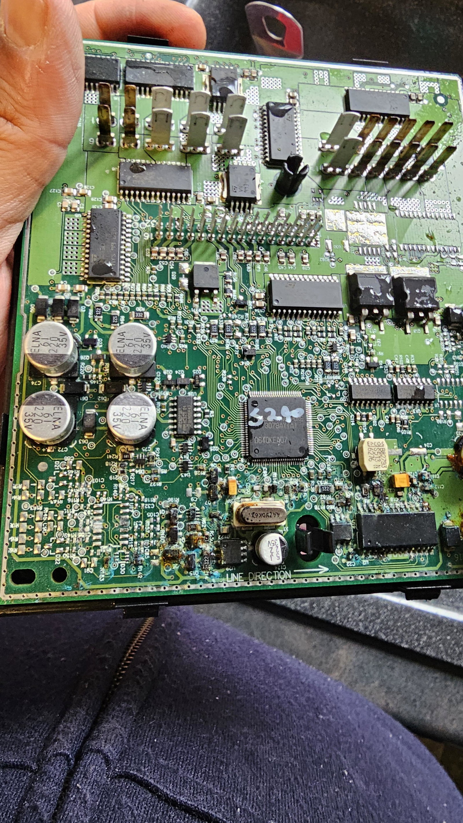

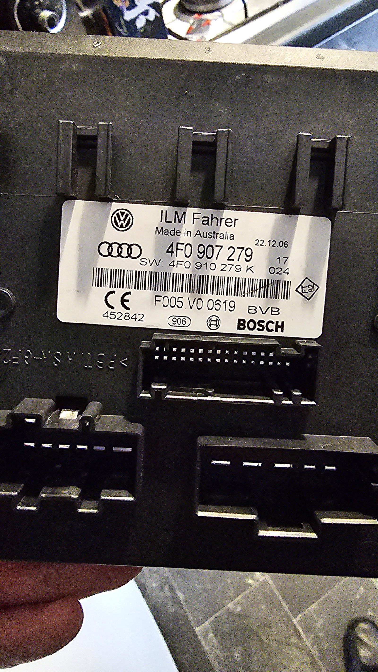

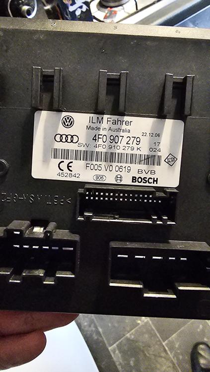

quattroshk Posted February 28, 2024 Author Posted February 28, 2024 I think I've found the culprit finally. It's this module these was covered in water. I'll order a replacement straight away and see if it's this!
